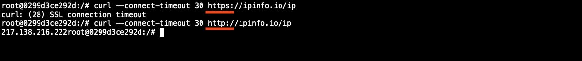

Hi all and excuse me If this is a stupid question, I'm quite new about all this.
Reading online discussions about how to use torrent clients with VPNs, I've often seen people recommend not trusting "kill switches" because they could possibly leak something for a small amount of time if they aren't fast enough to kick in. The often quoted advice is to "bind" the client to the VPN interface, assuring that all traffic goes only through the tunnel.
I'm guessing that selecting a tunneled wireguard interface in the docker configuration of the torrent client does the same thing as the "binding"? Should I be worried about the kill switch not kicking in fast enough?
Thank you

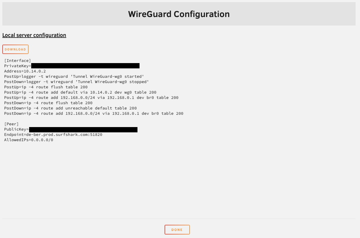

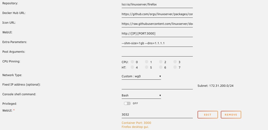

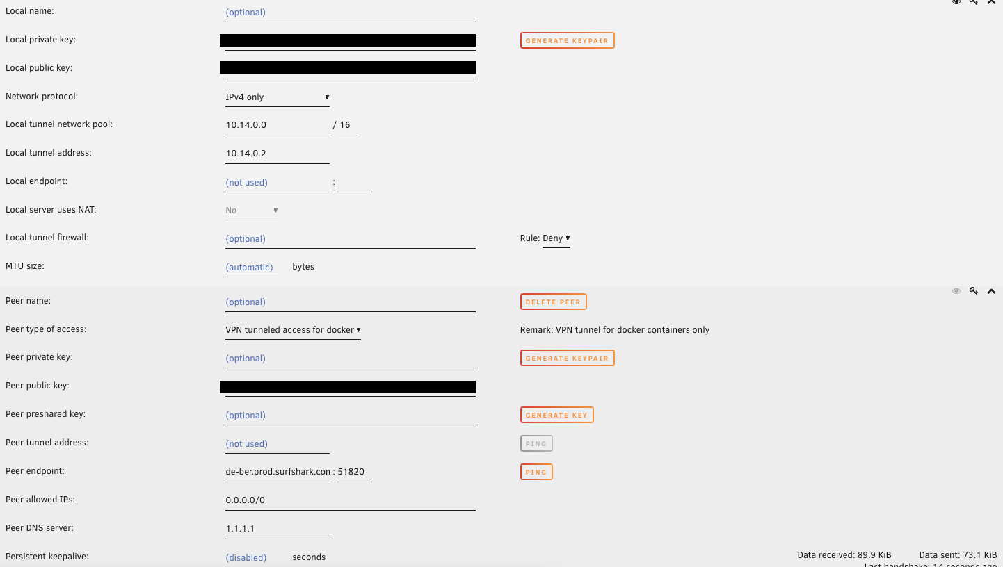

Hi all,
I have a weird problem with the VPN connection. I hope you can help me find a solution.
I set up the VPN according to the instructions and at first glance, it seems to work. It performs a handshake with the server. I have selected the network interface wg0 for a new Firefox container and also set the --DNS=1.1.1.1. Now, when I try to access a website, it only works if the website can be accessed via HTTP. HTTPS connections are not possible. I also tried this via the command line with several containers. The IP address I get back is from the VPN provider. The problem does not exist with the standard network interface.
Screenshot for visualization:
63272112_Bildschirmfoto2023-02-28um11_10_07.thumb.png.2d60c3d3ff74b5d91d8a65929409986e.png
I hope you can help me with this. I have attached some screenshots of the settings.
VPN-Manager:
297296344_Bildschirmfoto2023-02-28um11_06_52.thumb.png.9b9439852c45bfa62587a009e803d691.png
WireGuard Config:
1425809874_Bildschirmfoto2023-02-28um11_05_09.thumb.png.7843a825366f7fa22f3663552b8e845e.png
Container Settings:
1667048924_Bildschirmfoto2023-02-28um11_07_28.thumb.png.6b4eef93360d1ff0283404ad4725ac8c.png
Thank you!
