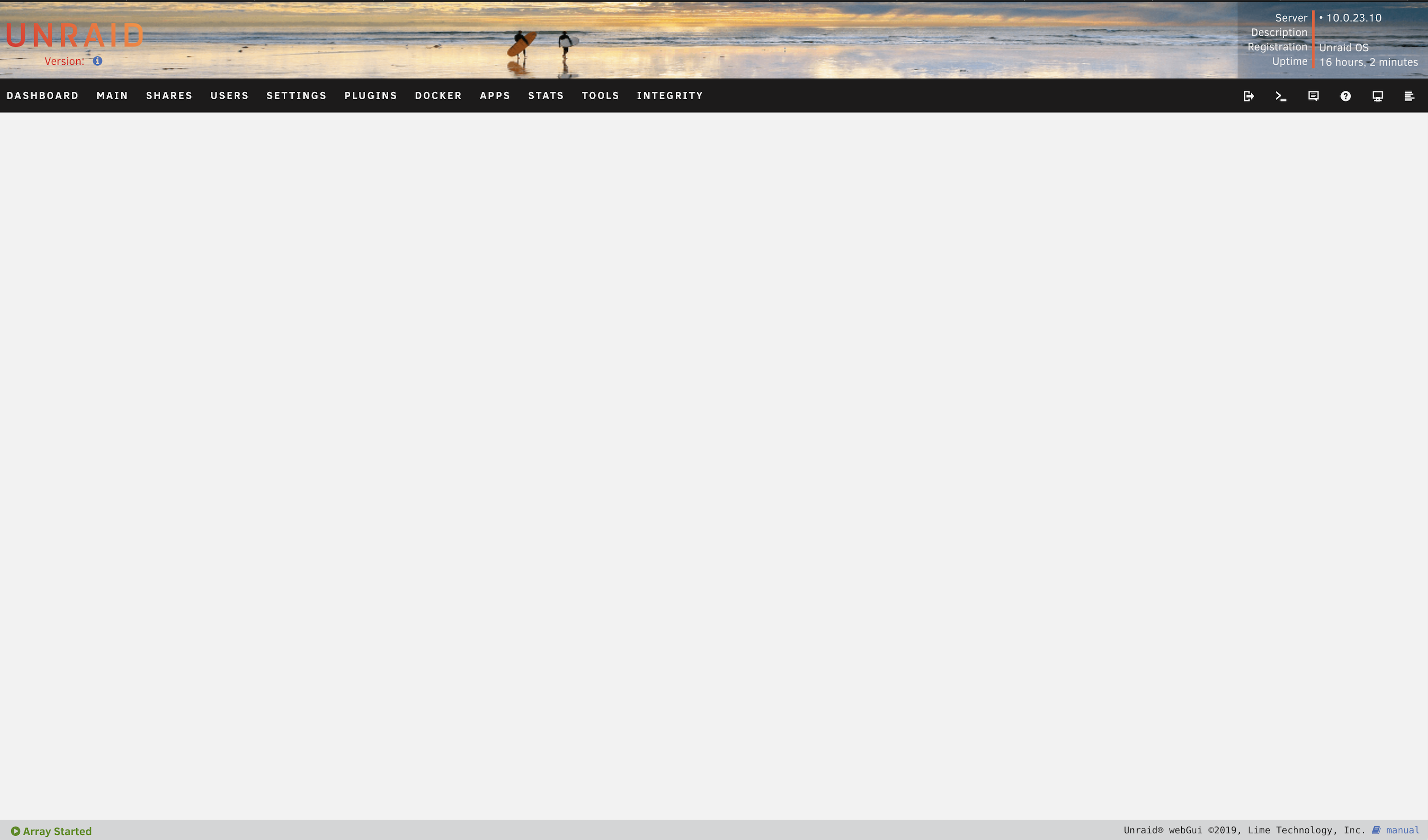

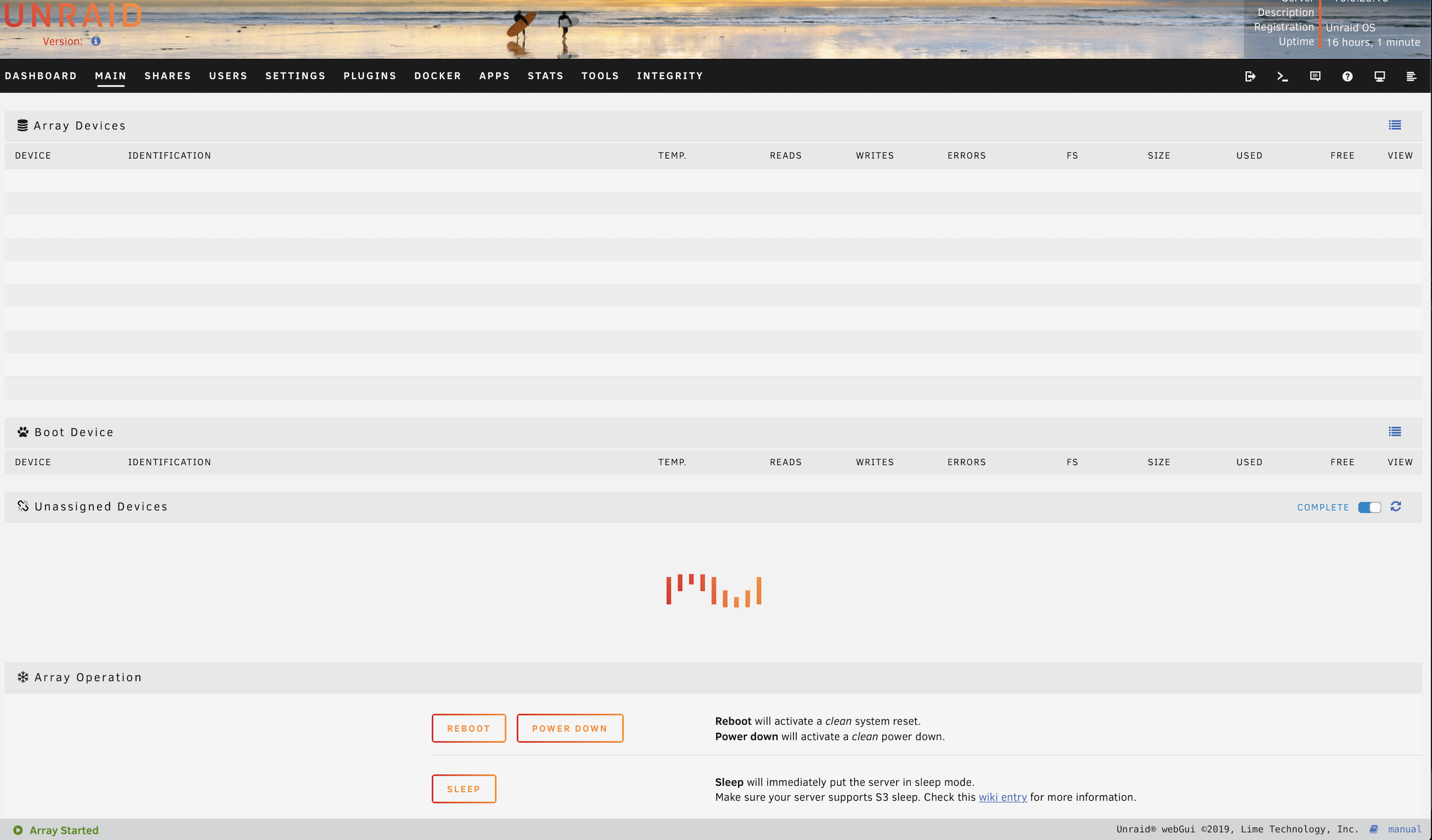

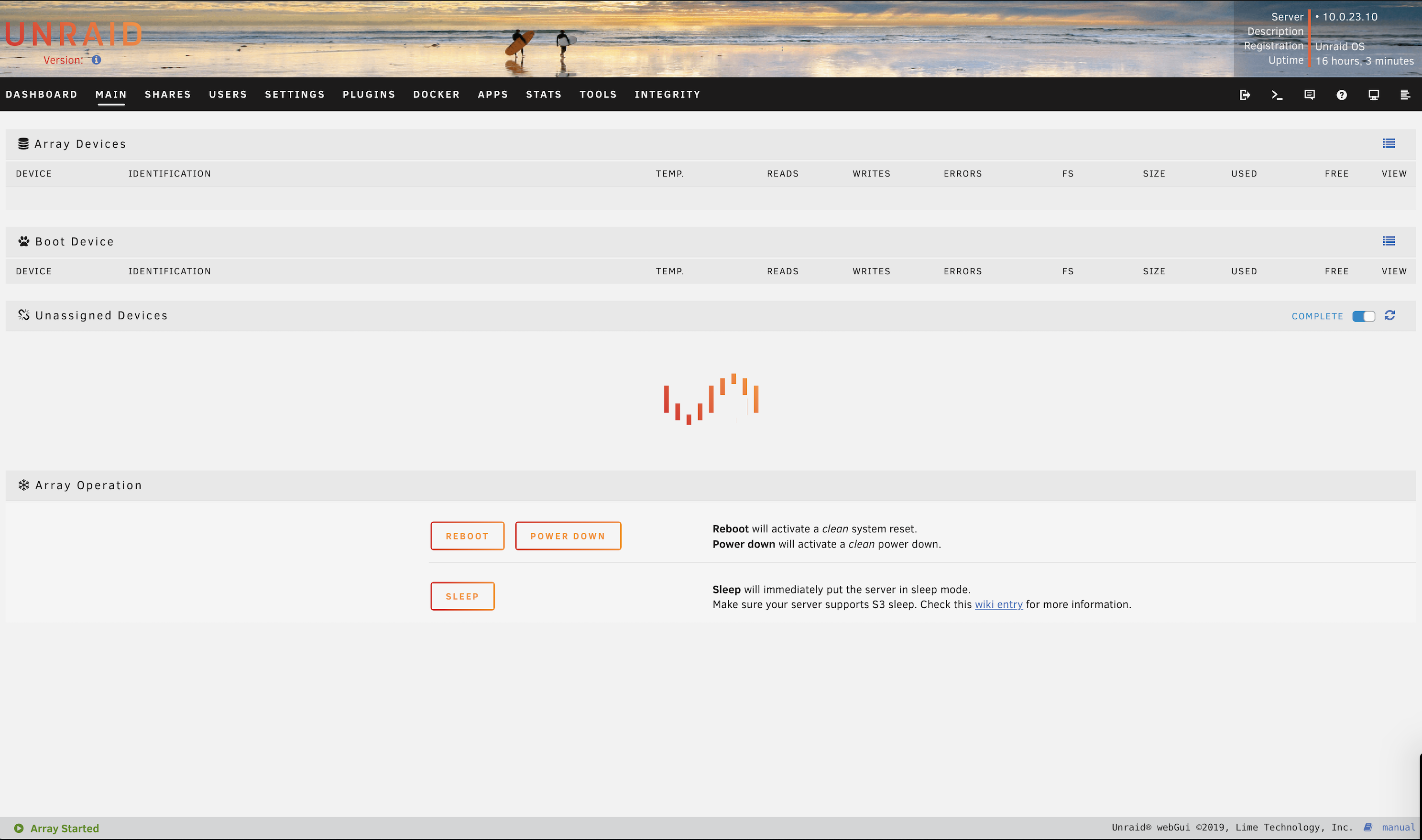

I have a problem on my unraid server (6.7.2). Sometimes when the server is longer not in use (some hours), there are shown no disks or an error message. Sadly I've no pictures from the messages which occurs today for the first time after parity check.. When this failure occurs the only working thing is a reboot via console.
I have pictures from the failure that no disk is shown. I have an error log somewhere.... ( a few weeks ago).

For me, a read error don't means that this was only a failure while parity check and was corrected. I logged in and there were no disks showing. Only a text (which I don't know anymore, my bad). There were notifications and with every notification I closed there was a placeholder in the same size so the other notifications weren't moving and then there was only a text, that this picture cannot be shown or so. I know I should have had taken a photo!

The pictures are showing only the problem without notice.
