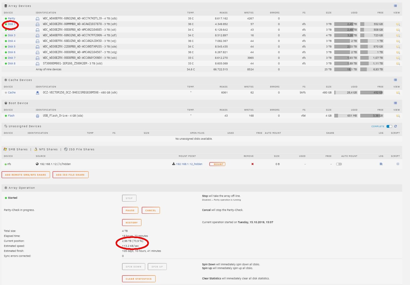

Hello,
This is my second run of Parity Check-in since yesterday. The one before I aborted and rebooted.
When it reaches about 70% it slows to a crawl as you can see in the screenshot.
Note that in the first run Disk 1 gave some errors. After reboot they don't show up, yet.
I stopped the Dockers engine to ease up on the server.
What can I do now?
I don't know it it is a coincidence but 2 days ago I upgraded to 6.8.0 rc1.

just got a pop up saying Disk 5 has errors now
Missed the fact that the diagnostic had no SMART info for disk5 suggesting it had dropped offline.
