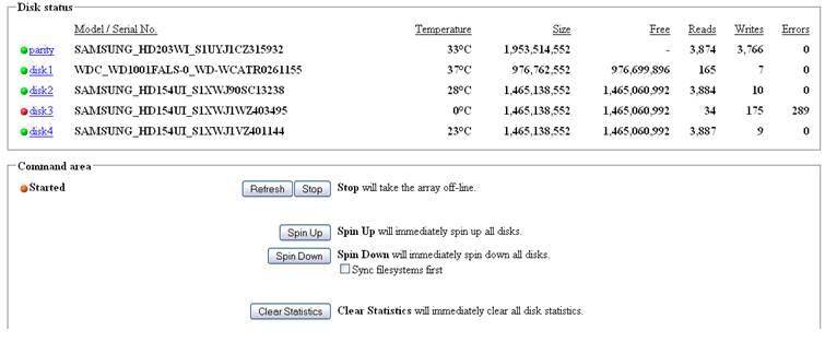

Hey Everyone,
I recently added two new disks to my Unraid array (giving me 5 total drives-4 plus parity).  Upon starting the array, I believe I formatted all new disks by accident not realizing what I was doing.  Shortly thereafter, I used the restore function which I understand has reset my parity drive (I think I hit it two separate times).
Before I really understood what was happening, I thought my issues were due to a filed drive because 1 of the 2 drives I added was red.  Therefore, I replaced one of them with a larger drive.  So I added two drives, formatted, restored, and replaced one drive with a larger drive.  My current state is that the same drive I replaced is still red, although it did recognize that I replaced it with a larger one.
I found some useful information on the forums but I have some questions before I do anything:
I want to follow the instructions posted by Joe L. here (http://lime-technology.com/forum/index.php?topic=6008.msg57379#msg57379), but within his post he is advising me to use the Trust-My-Parity process (http://lime-technology.com/wiki/index.php?title=Make_unRAID_Trust_the_Parity_Drive,_Avoid_Rebuilding_Parity_Unnecessarily).  My issue with this is this statement:
It should NEVER be used if you have a failed disk or are in the process of replacing a failed disk.
It should NEVER be used if you are replacing a drive with one of a larger size.
I feel that I fit into either one or both of those categories which means I don’t even know where to begin.  Can anyone please offer some suggestions?  I did e-mail Unraid support but have not heard anything back after a couple days so I thought I would post here.
I attached a screen shot.  Disk3 is the disk I replaced with a larger one, Disk4 is the other disk that was added.

Luckily, the failed drive is one of the two new drives I was adding.  In the screen shot, disk3 and disk4 were newly added.

You are correct.  It's started now... It's definitely going to be a little while before I post an update.
Thank you!
Well it's looking like almost all of my files have been restored!  Thanks for the advice!  Hard to tell for sure at this point because so many are in random folders in the "lost+found" directory.
I have a couple more questions now:
First, I'm scared to touch anything... can I re-create my shares and begin to move files to where I want them?  Currently I see 4 folders (disk1, disk2, disk3, & disk4).  If I create a share, can I drag from the disk folders to the share folder?
Second, I still have a disk that is red.  It's disk3 but I still see disk3 when I am viewing my server in Windows Explorer.  Should I figure out how to address this problem before I begin moving files around?  What do you think I should do here?

You want to first enable user-shares.  That will automatically create user-shares for all the top level directories.  Many of use create just a few  (I have Movies, Pictures, Mp3, and "data")  I organize my files under those main folders.
disk3 is being emulated from parity and the other data disks.  It sounds as if the disk itself is defective or the cabling to it or the port it is connected to is defective.
On each of disk1, disk2, disk3, you can move the files as you desire.  You currently need to get disk3 working before you can have parity re-calculated and be protected from another disk failure.
Are there any files on disk3?  (at one point you said it was empty... Is it still empty?)

Yes, disk3 is still empty.  I am not sure what is going on with this disk.  When I started this whole mess, I added disk3 and disk4... disk3 was a 1TB drive originally (disk4 was a 1.5TB drive and works fine).  I thought disk3 was a failed disk (appeared red), so I replaced it with a new, 1.5TB drive.  It is still red.  Maybe this means the cabling or port is defective?  I think I have one more SATA port available on the motherboard, should I shut down and plug disk3 into another port?
