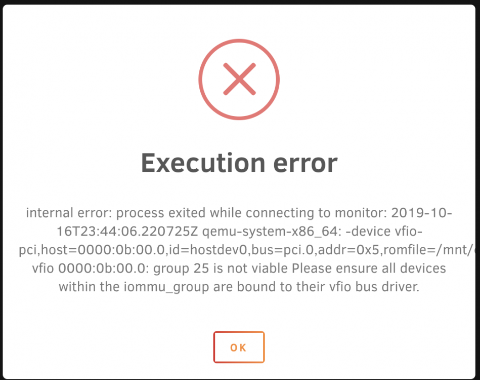

Hi, I am hoping I can get a little help with a Graphic Card Passthrough.
Hardware:
Asus Crosshair 8
AM4 Ryzen 3700 (No dedicated graphics)
RTX 2070 Super (Only Graphics Card)
I have setup the Windows 10 VM with VNC and it works fine.

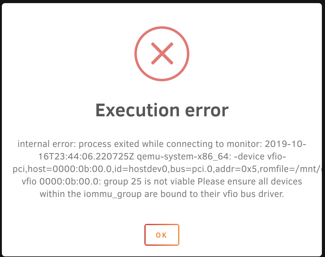

Attempting to add the Graphic card however causes this error (MORE BELOW IMAGE)
Sorry the image is so large. :(

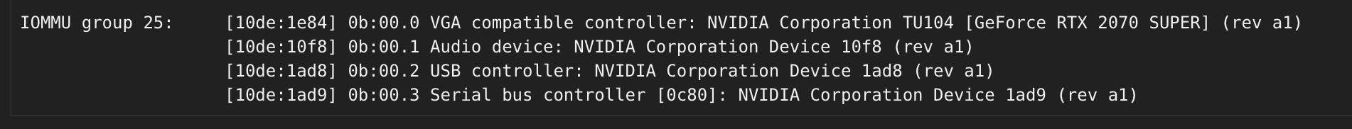

I have confirmed that its in its own IOMMU group
711230538_ScreenShot2019-10-16at6_45_07PM.thumb.png.94e2ee1c51e59225cf80a3b63700a697.png

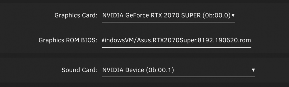

Also attempted to add the BIOS from https://www.techpowerup.com
2045861174_ScreenShot2019-10-16at6_46_06PM.thumb.png.dcb06dbffea83eec344d768da1e2fee8.png

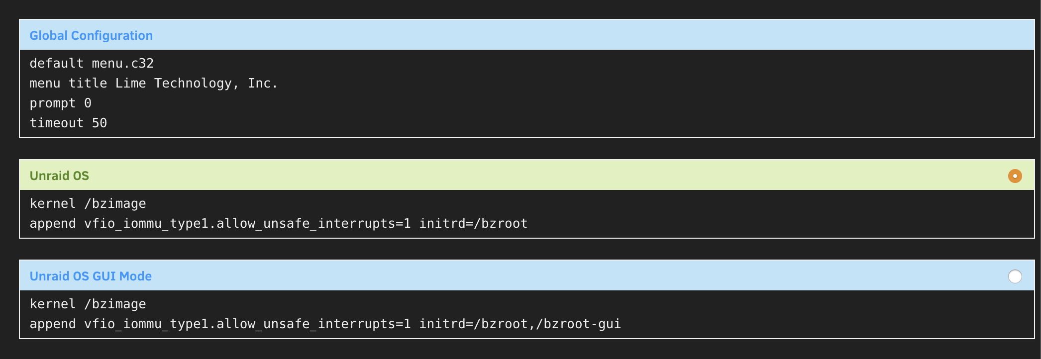

and Allow Unsafe Interrupts
1435082104_ScreenShot2019-10-16at6_47_43PM.thumb.png.03ad27c88b1ceafcb8bb7e73e37945b6.png
but still I get the same error. IF i change ACS override (reboot) and try again, when launching the VM, the entire system hangs requiring a full (push the button) reset.
I upgraded the 6.8.0 RC1 to see if there way any help there, but no. Any ideas?

Do you have HVM & IOMMU enabled in the bios and not on auto which makes a difference? Do you have the latest bios? Newest bios agesa have caused problems with passthrough. Try another video bios close to your card or dump your actual bios. Try multifunction acs. What is machine type & bios type set to in the vm config?
You're not passing through the USB controller or the serial that's also on the card (why your passthrough isn't viable).

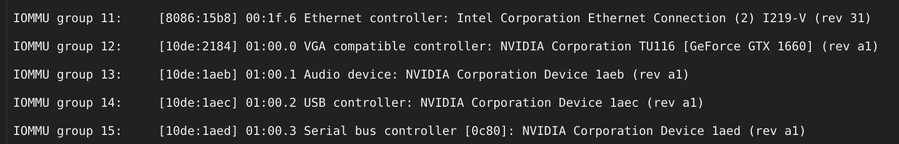

I have Nvidia RTX card also and I just set ACS to both which split them into there own seperate iommu groups and has worked great.
1 hour ago, wesman said:
I did see the other two, but didn't know how to pass them through. There is a "Other PCI Devices" but it was not editable, do I have to edit the XML and if so, what would that syntax look like?
Also you can pass the usb through by adding vfio-pci.ids=10de:1ad8,10de:1ad9 to your syslinux config for them to show up in the VM template in unRAID.

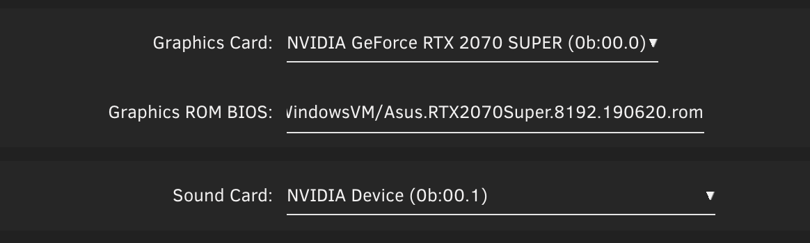

I did try that
1993226626_ScreenShot2019-10-16at10_05_04PM.thumb.png.9e6b86005b04a7b29a773dd60a2b208f.png
but it made no difference. @jpowell8672 with regards to passing through, is this the correct syntax?
