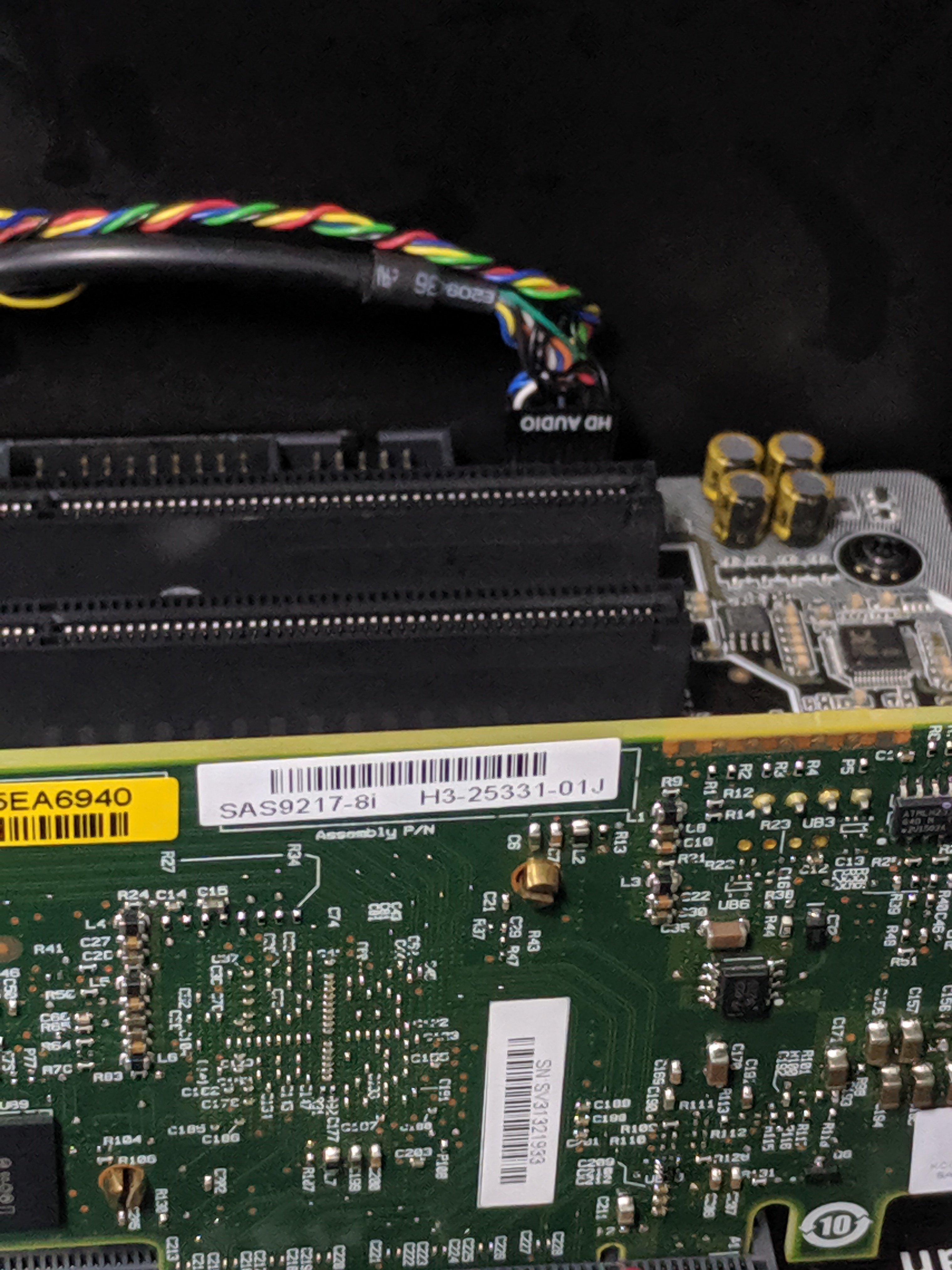

I have a SAS9217-8i reported as a LSI2308-IT (as reported by the avago config util) and plugged into this i have 5 4TB WD reds.

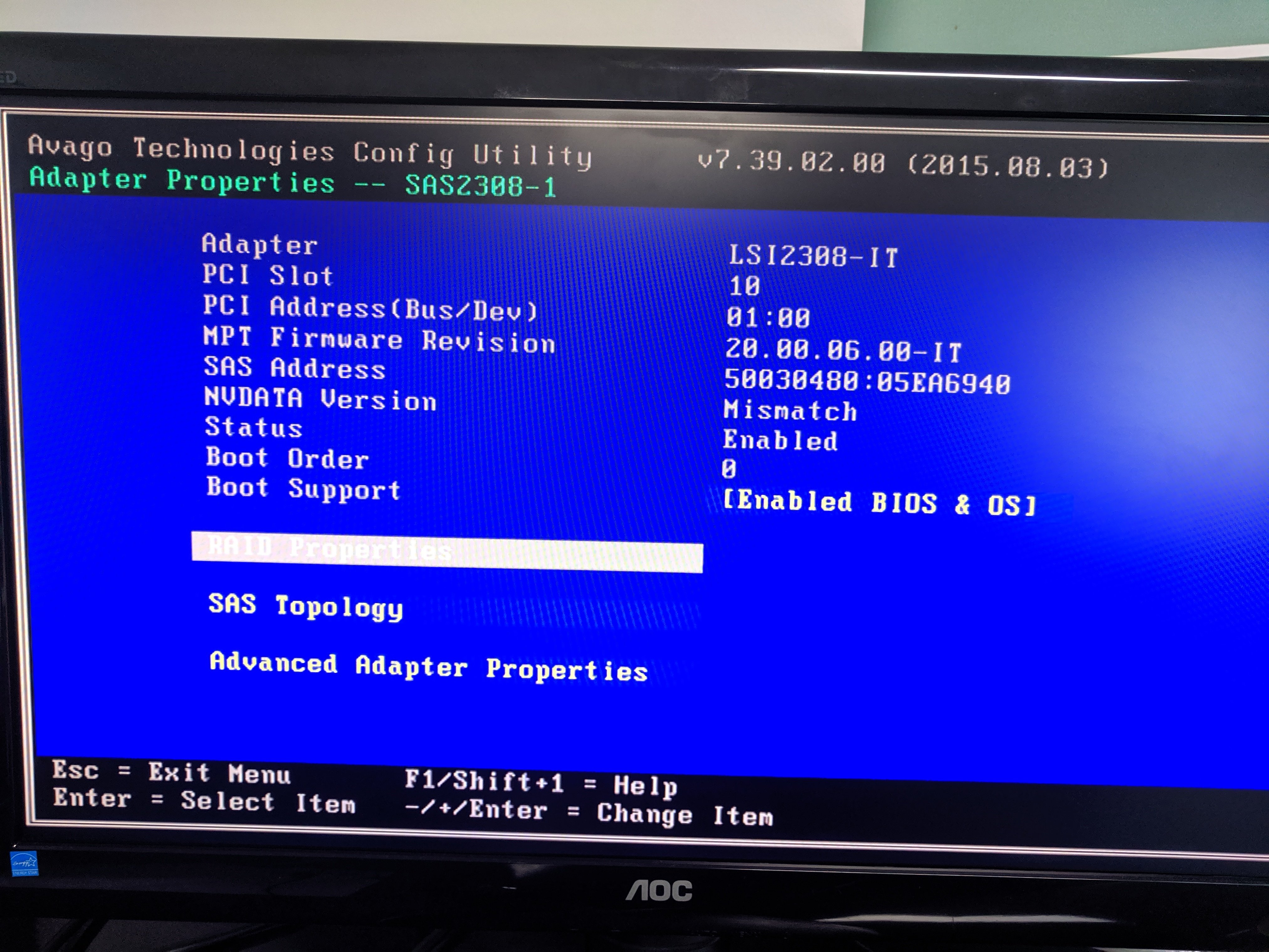

The HDDs spin up when the server powers on but i cannot see them in the unraid config anywhere. See attached pics.

From screen shoot, it show NVDATA mismatch, you may try reflash the HBA to fix it.
Or provide Unraid diagnostic to further check what's going on.
Edited by Benson

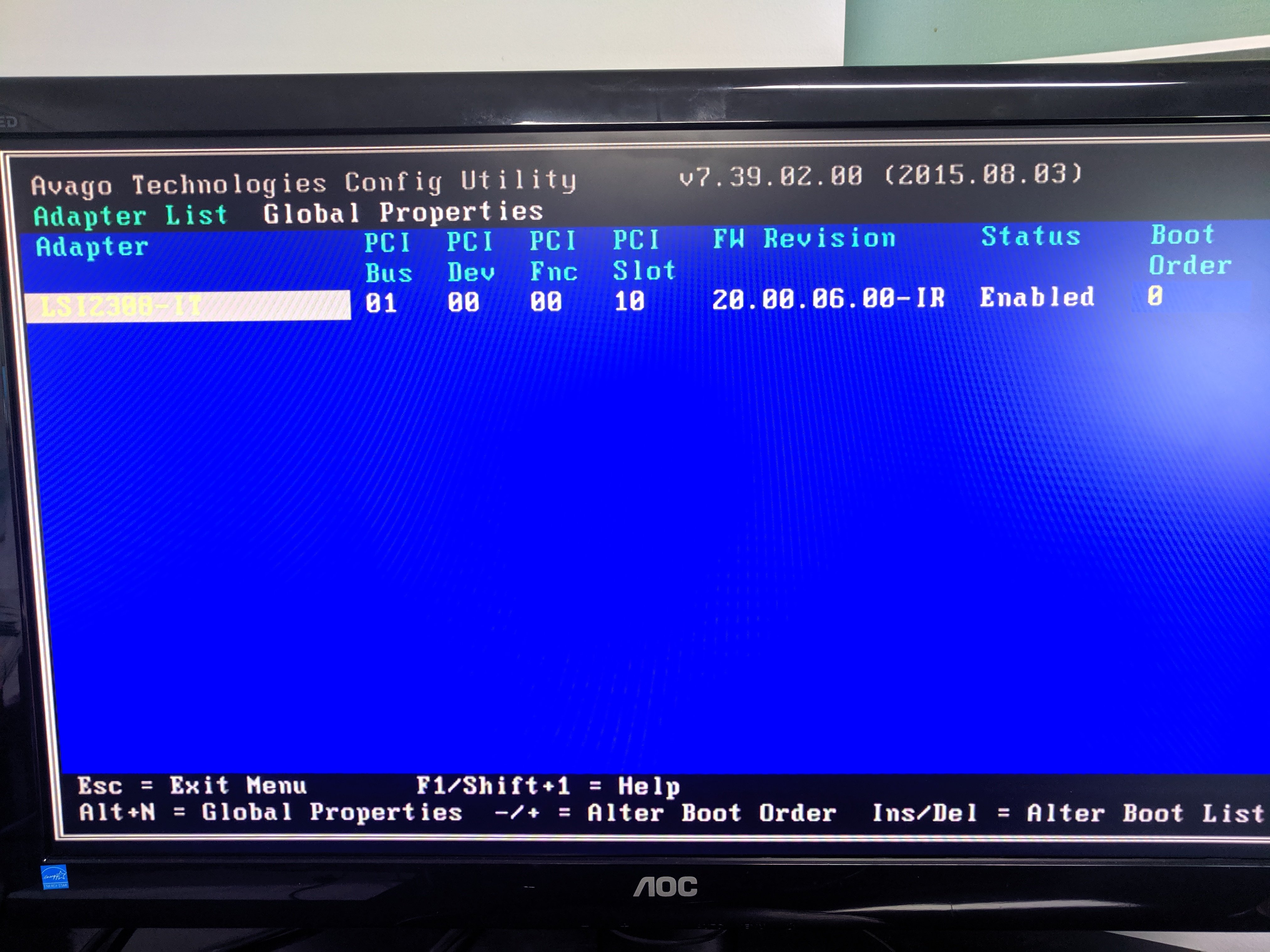

IT in on place, bit the other shows IR:
Possibly a bad flash, still if no disks are detected in the HBA bios it's likely not that, make sure you're using the correct cables, you need forward breakout cables, reverse breakout look thew same but won't work in this case.

Two things i learnt, the firmware mismatch and the cables can be different!
I've corrected the firmware to 20.00.06.00-IT (making this now a 9207-8iIT HBA) and i'm ordering some new cables today and hopefully this will sort the issue!
