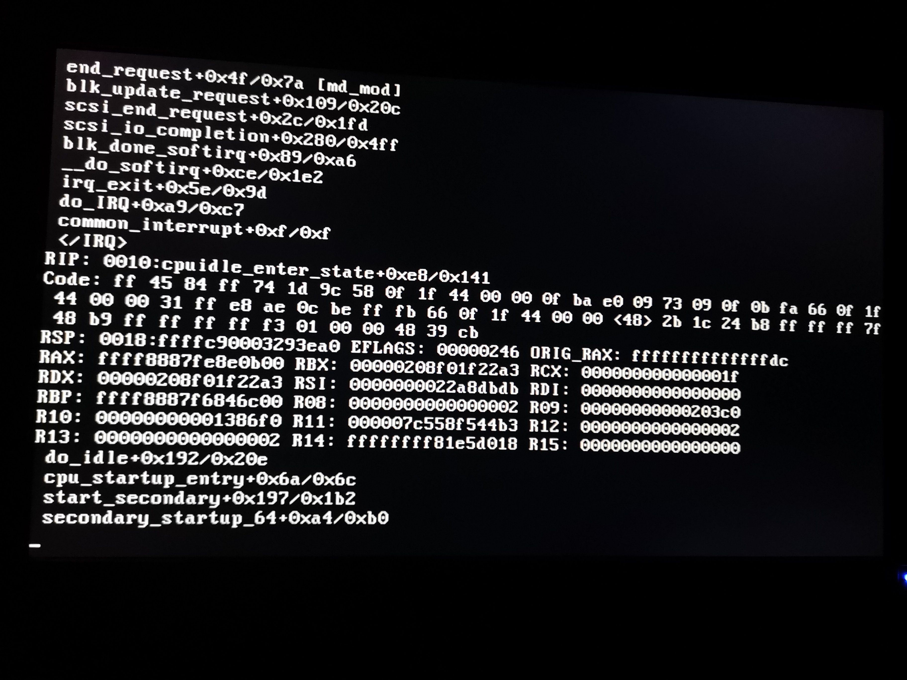

The issue manifests itself as a complete crash of the system, and seems to be triggered by the starting of a Windows 10 VM (my only vm), in fact if i set the vm to auto start on boot then the system only stays up for a couple of minutes before a complete crash of the system (crash screenshot attached).

Crash screen, note the 'cpuidle_enter_state', i have seen this on multiple crashes, always the same thing, not sure if this is relevant?.
