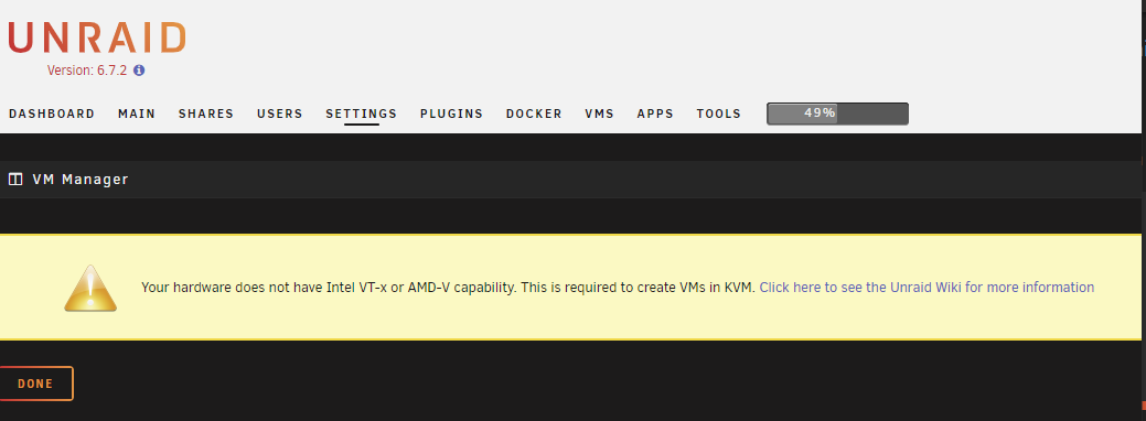

I've tried in the past, when I go to settings I get "VM Manager" and within VM Manager I get a notice saying "Your hardware does not have Intel VT-x or AMD-V capability. This is required to create VMs in KVM. Click here to see the Unraid Wiki for more information" and all that's available is a done button. I do not see any way to disable this.
It's an old issue, you can disable it by editing /config/domain.cfg on the flash drive and changing service="enable" to "disable", though it won't cause any issues leaving it enable.

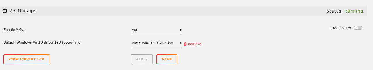

Here's what I see. My hardware does have AMD-V capability and I can enable or disable VMs at will. Did you perhaps migrate your server from different hardware that supported virtualisation, allowing you to turn it on, but now not turn it off?
It defaults to on on a new install and servers without iommu can't disabled, except by editing the cfg like mentioned.

Negative, this is my first Unraid build. This is all I get.
