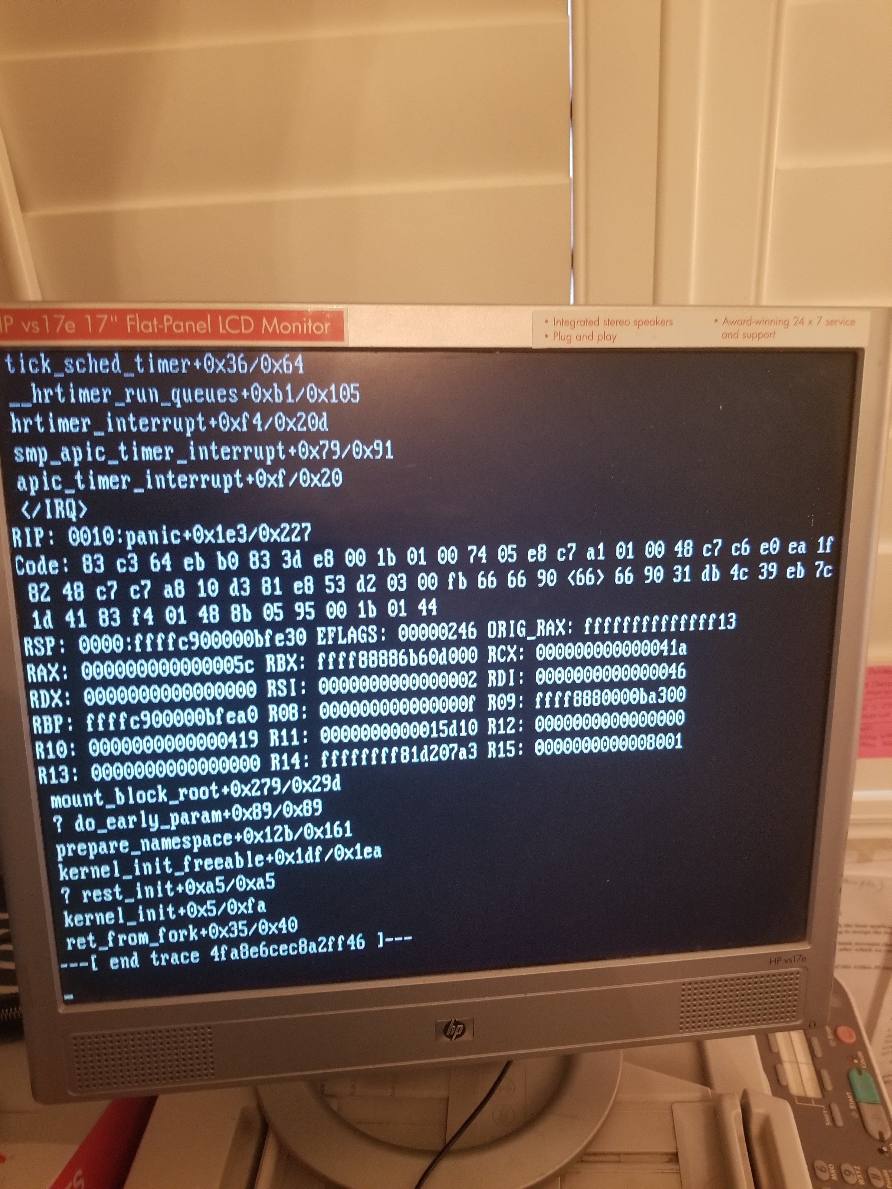

RIP: 0010:panic+0x1e3/0x227
I was trying to reboot unraid but it went for hours without turning off. I eventually forced it off. When I turned it on it wouldn't boot so I replaced the bz* files on my usb. This is what is appearing now. Help! 😖
Try recreating the flash drive.
I have over 20tb of data. Is there a way to do this without losing everything?
Recreating the flash drive doesn't have anything to do with the array data, backup current flash, create a new one using the LT creator tool, then restore the config folder from the backup.
