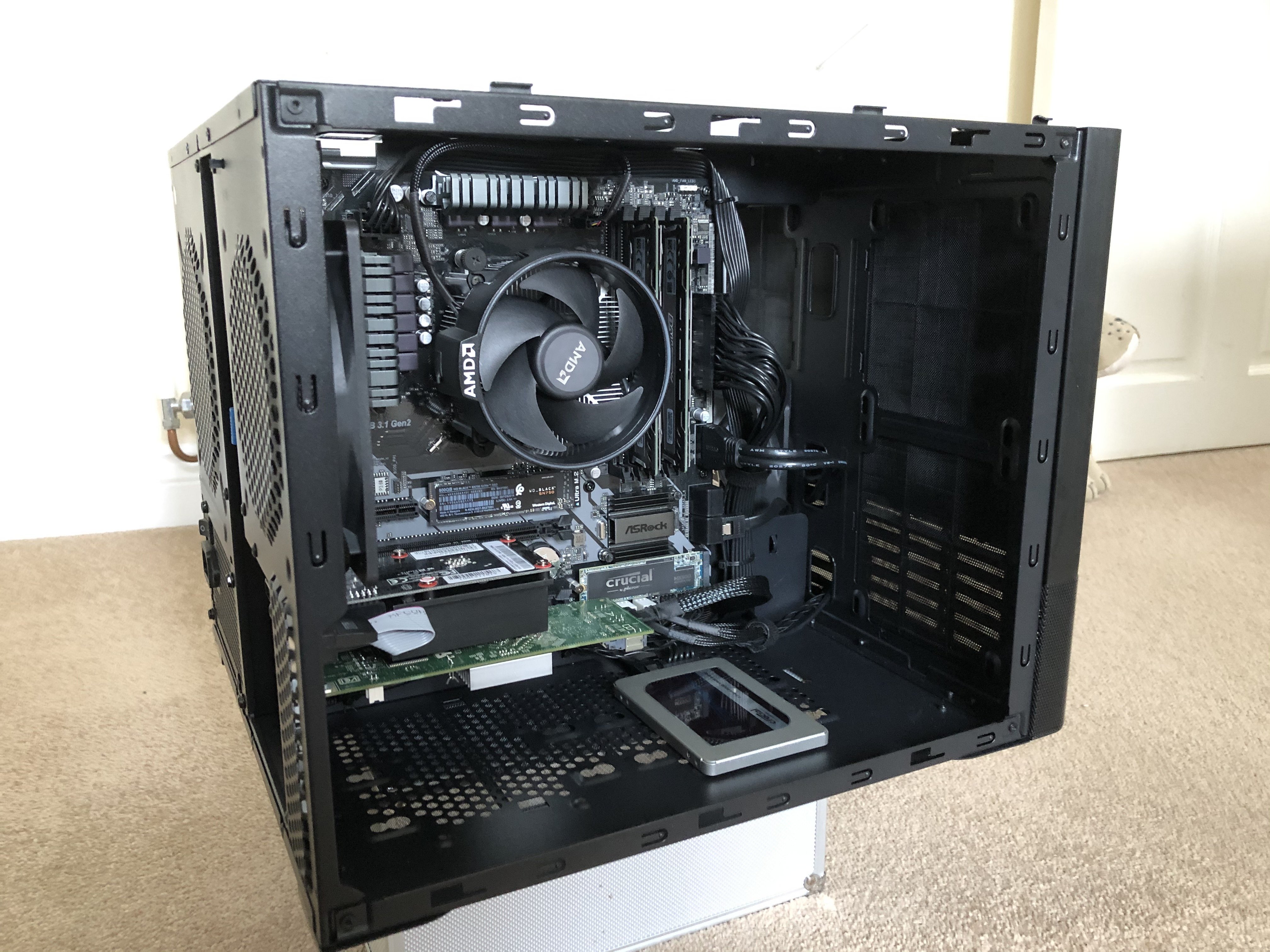

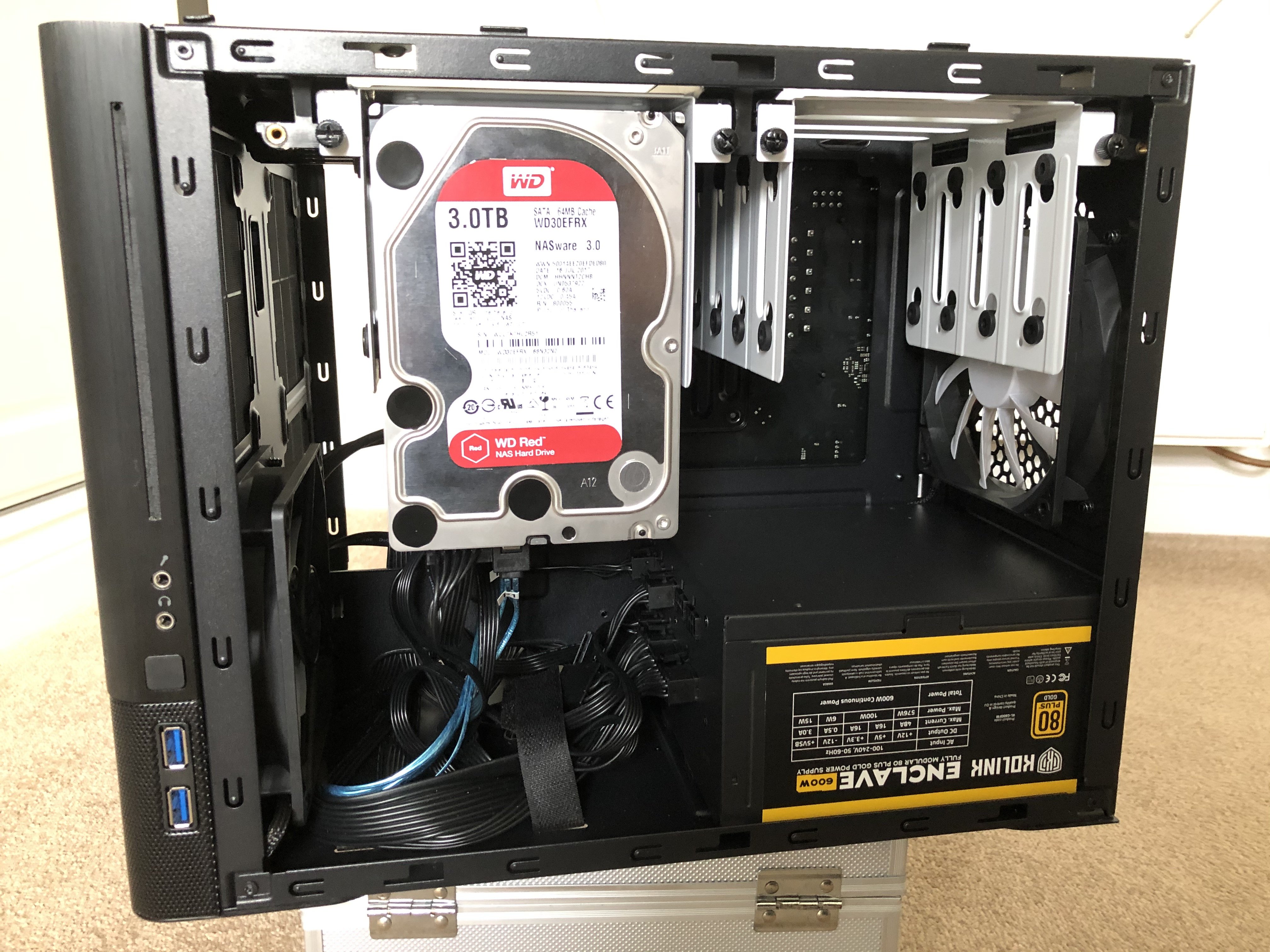

Ive just done a similar thing - gone from a HP MicroServer (N40L) and i went with the following spec.
Ryzen 2700 (non X)
Asrock B450m Pro 4 motherboard (MicroATX)
32gb Crucial DDR4 2666
500gb NVME (Cache)
2gb Nvidia 710 (just really so i could build the thing)
Fractal Design Node 804 Case
Its running great, really pleased with it
I also bought a Dell H310 Perc Raid card from eBay for cheep, flashed it with IT firmware.
I have 4 WD reds from my old system running on the Dell card, an SSD from my old system connected to the onboard SATA

Very Nice, Funnily enough I was looking at the exact same case, as I wanted something that looks remotely similar to the Microserver. I was scared off by thermals though. I'm curious to know how it runs?
Thanks,
yeah it took me ages to decide on the case for the same reasons :)
Thermals wise it fine, there is so much space in the mb area once built that the CPU and board are fine, and i moved the fans around a bit, so i put 2 in the hard disk area, one to bring cold in, at the bottom, and then the existing exit at the top - then just left the cpu side with a single exit fan at the rear.
Everything is ticking over really nicely,
