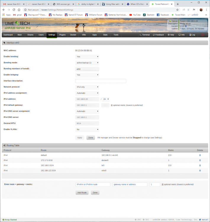

Yeah, it's not letting me change it in the browser settings page, either.  Seems like that's the default and has worked fine with 6.5.3 all this time.  Where am I going to find that?  One of the rc files?  This is a screenshot of the settings page working as usual with 6.5.3 install that's been humming along fine since 6.5.3's release.  Something change with the ethernet driver after that point?

Docker/VM service must be stopped to change this setting.
Let it blank. The NIC will auto-negotiate this setting.

Thanks for your time, guys.  ok, I was just wondering why it wasn't letting me change anything at all on that page, not just MTU.  I'll change that to 1500 and try upgrading again.  1500 or 1514?  I seem to recall 1500 being the norm.  I wonder why the newer version doesn't like the other setting that works ok in the older version.

Hmm, well, disabling the Docker service didn't do the trick for allowing me to change those network settings.  Still can't click anything there.
Got it.  You need to disable the Docker service and the VM service, too.  Going to try upgrading again now.
ok, it worked!  Thanks for taking a look for me!  I changed the MTU to 1500 in 6.5.3 and then upgraded to the latest release candidate and the web interface is up and running.  Woohaa!

Did you read the GUI-Info?
Your screenshot says: VM manger and Docker service must be Stopped...

Nope, overlooked that until you said the Docker service must be stopped, and it didn't work.  You didn't mention the VM service, but I could've seen the message on the settings page if I'd read more carefully, too.
