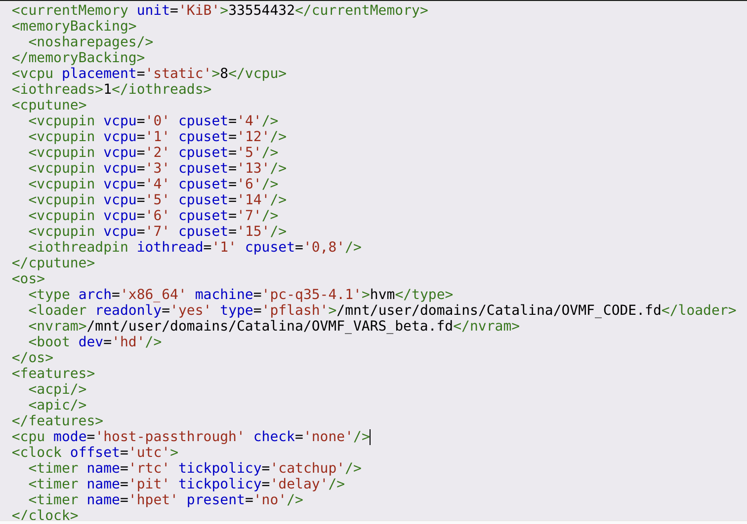

1.2 CPU Topology
If you are not using Penryn or a wield cpu thread count, it is safe to remove the cpu-topology line in xml to avoid problems.
  <cpu mode='host-passthrough' check='none'>
    <!-- REMOVE THE LINE
    <topology sockets='1' cores='3' threads='2'/>
  </cpu>
I've found it is related to the lack of virtualization support in clover and opencore, also the MacOS.
If you using a model newer than Penryn, they try to get the topology from a MSR which the hypervisor(QEMU/KVM) not implement yet, causes some dividing by zero error, and the system won't boot.

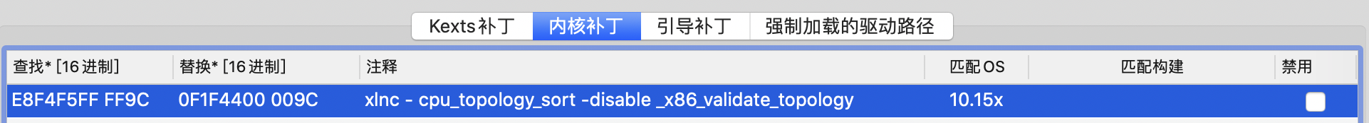

Update:
It is safe to declare the topology of your cpu without any performance reduction now.
All you have to do is add one single patch to avoid a x86_validate_topology error (MacOS will compare the acpi topology and the one reading from msr 0x00000198(which most hypervisors don't have), then the error occured.)
Although there will still some issues in virtualization support in clover and opencore(like TSC/FSB frequency reading and topology, many hypervisors didn't implement some important msrs like 0x35). Details can be found here(which I submit a PR to opencore to support hypervisor.I'm not familar with svn so clover may not support in near future).

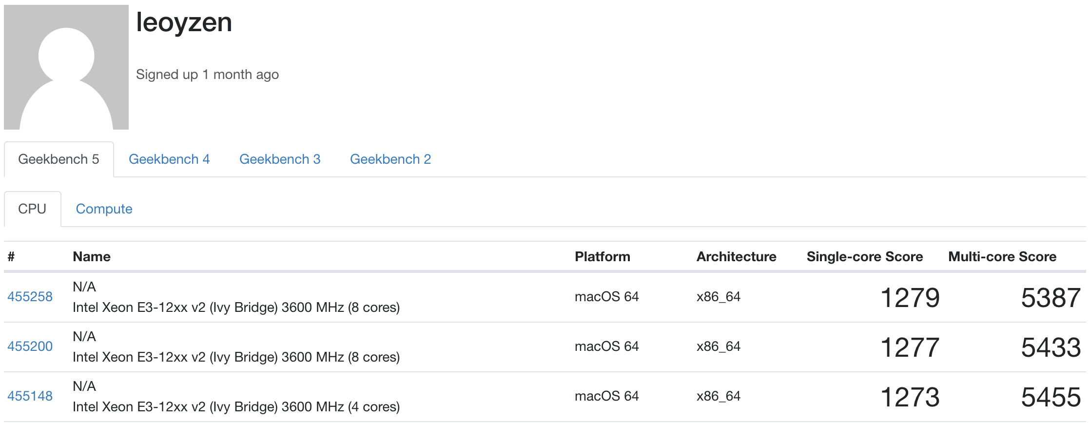

1.3 CPU Performance
1.3.1 Important cpuid features

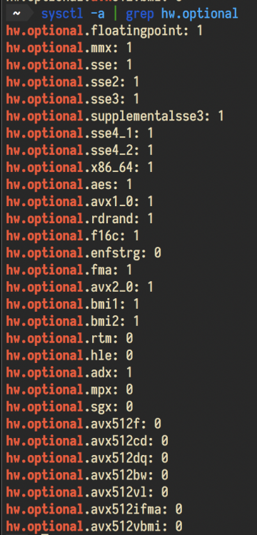

If you gonna get a nearly bare metal cpu performance, you should pass some important cpu features in xml.I will list some and you may try to find which feature your cpu is supported.
  • AVX: without this the newer MacOS will not boot
  • FMA: it is important for metal support
  • AVX2
  • INVTSC: without this the newer MacOS will not boot
  • BMI1
  • BMI2
BTW, there is no more need to add "vmware-cpu-freq=on" in the xml because it is default to be on in latest QEMU.
1.3.2 Newer CPU Model is recommanded so MacOS will recognize the features correctly
And also, it is important to use a more newer cpu model to make MacOS recognizing the feature correctly. IvyBridge is the bottom line(This is why Penryn is not recommend any more, when you using Penryn, MacOS won't recognize some important feature like avx2 amd fma, then some application will not using those features).

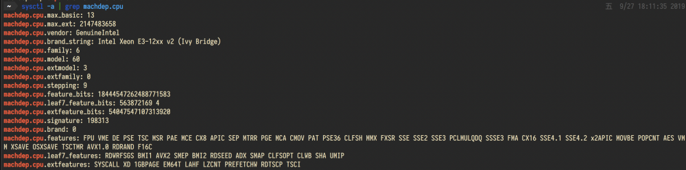

1.3.3 How to check whether the features are recognized correctly in MacOS

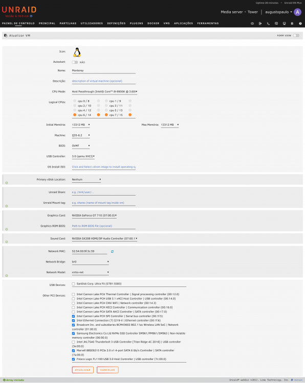

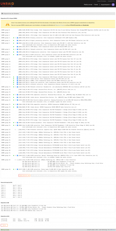

It should be noticed that unRaid did not set GPU and its audio correctly by assigning them in same bus but different function, you have to mannaully adjuct it to make it work.
IT IS IMPORTANT FOR METAL AND HDMI AUDIO! AND SOMEHOW IT IS RELATED TO AMD PCI RESET BUG!
    <driver name='vfio'/>
    <source>
        <address domain='0x0000' bus='0x2d' slot='0x00' function='0x0'/>
    </source>
    <rom file='/mnt/user/domains/mojave/Sapphire.RX560.4096.170419.rom'/>
    <address type='pci' domain='0x0000' bus='0x01' slot='0x00' function='0x0' multifunction='on'/>
</hostdev>
    <source>
        <address domain='0x0000' bus='0x2d' slot='0x00' function='0x1'/>
    </source>
    <address type='pci' domain='0x0000' bus='0x01' slot='0x00' function='0x1'/>
</hostdev>
As you can see , the gfx and graphic audio should be put in same bus (0x01) but different funciton (gfx in 0x0 and audio in 0x1), otherwise the HDMI audio will not work (even with Lilu/WEG/ALC).
If you misconfigured it, it will lead to some unknown issues:
  1. The HDMI Audio will not work at all
  2. If you using a AMD card, you may face the "pci reset error 127" (seems the driver will reset the grahpics in a wrong way)
  3. it also makes onboard audio recognized incorrectly. (AppleALC will confuse which audio is truely onbaord, details can be see here)

3.5 nic xml assignment
You should assign the nic in bus 0x00 and slot 0x0y(y is number ,recommand to be greater than 5 which not likely occupied by other devce) to make nic recognized by macos as builtin .This is important to make AppleStore and iCloud work.
4. onboard Audio
It's important that:
1. you make the graphics audio correctly by step 2.1
2.change your onboard audio from bus 0x0y, to bus 0x00 and slot 0x0z (where x, y means integer.
This will make your onboard audio built-in, so AppleALC can easily handle it. detail and discussion can be found here.
      <source>
        <address domain='0x0000' bus='0x00' slot='0x1b' function='0x0'/>
      </source>
      <alias name='hostdev2'/>
    </hostdev>
the snippet set the onboard audio (00:1b.0) in bus 0x00, slot 0x02, and this makes the audio built-in.

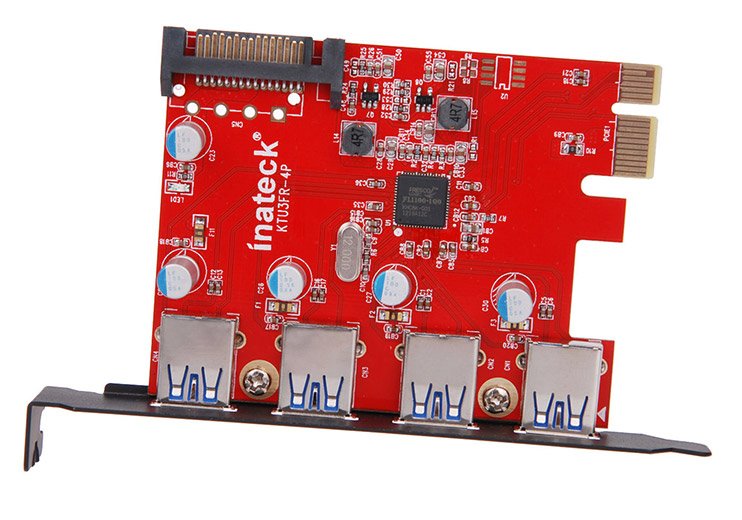

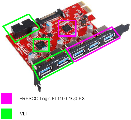

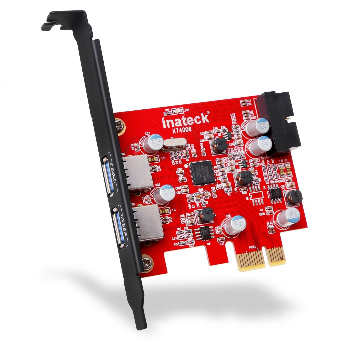

Hi, I'm searching for a card to passthrough to have usb 3 with retrocompatibility of usb 2: cards based on fresco1100 and asm1142 should work out of the box in our mac os VM.
I know @1812 should have some 4-ports Inateck cards, based on Fresco chipset.
Instead of the 4-ports Inateck, I would like to connect the card to my front panel ports and the KTU3FR-5O2I has this option; however, not all ports are based on the Fresco chipset :( as you can see in the following picture:
Reading from here:
4th Card - Inateck KTU3FR-5O2I
Chipset: Fresco FL1100
Findings:  Worked natively in Linux, and worked beautifully in Windows or OSX VMs, able to use my hardware KVM switch with either, but unable to power my server off with the card plugged in, as soon as it powered off, it powered on again.  @aptalca has had the same issue with a Fresco FL1100 card and we both have Supermicro motherboards.
It seems the KTU3FR-5O2I works, apart a problem in shutdown that should be related to the Supermicro mainboard.
I would like to know if anyone has this card passed through to a mac os VM and if it works out of the box (please specify the OS, I'm interested for Catalina), especially for the internal ports (VLI chipset).
The Inateck KT4004 has only the Fresco chipset, but only 4 external ports:
and it should work oob.
Or maybe the KT4006 fits my needs, as it seems it has only the Fresco chipset and the internal connector, but no power connector..mmmm:
Edited by ghost82

There is a way to enable smp/topology in current opencore or clover, just add this patch:

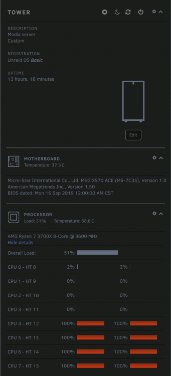

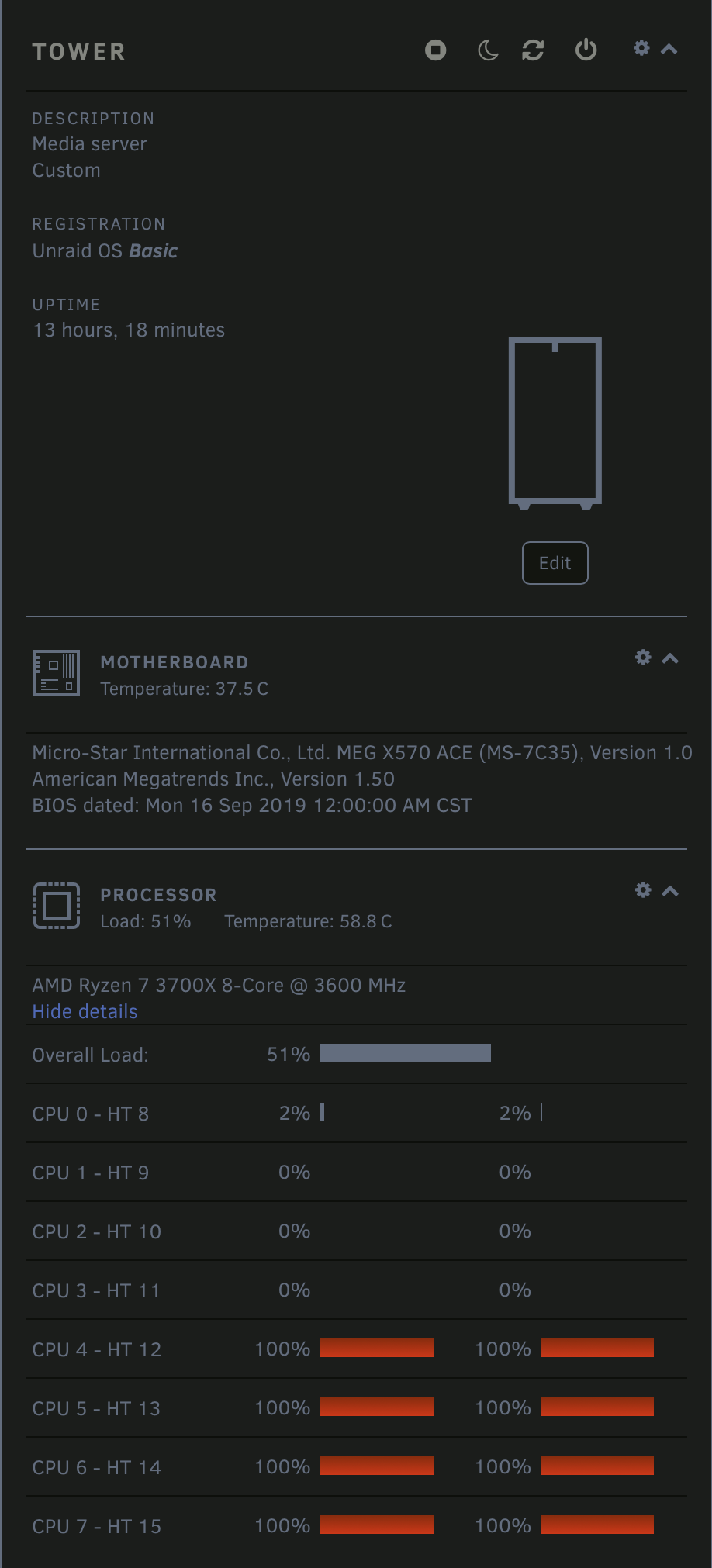

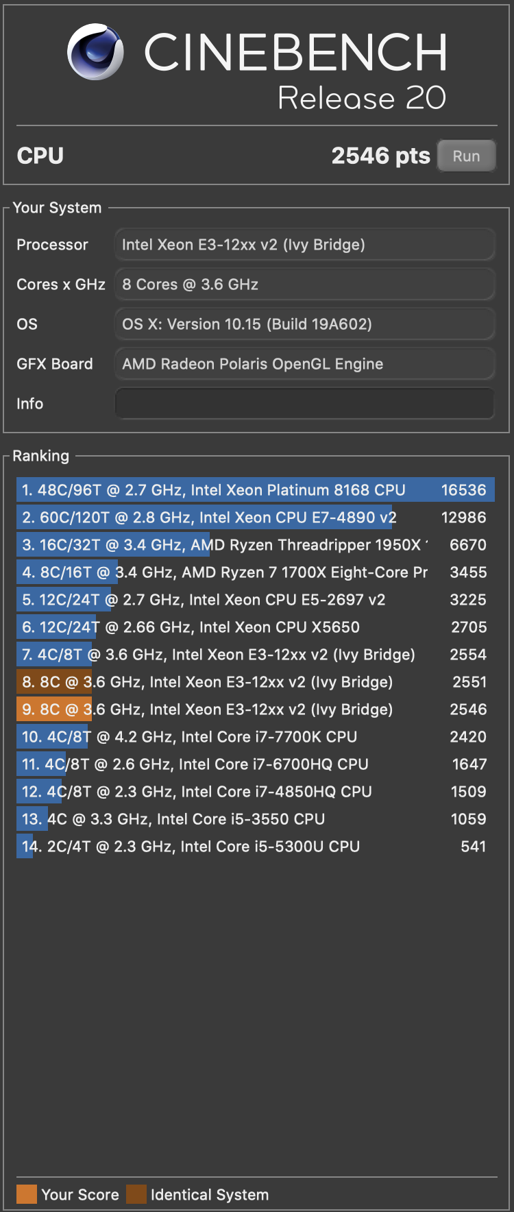

As I mentioned, I don't see any performance reduction before, to prove that, I just did some test to indicate the conclusion you've made is outdated now.
VM CPU: 4-7, 12-15, which 4 cores and 8 threads
VM OS: Catalina 10.15 (which is as clean as possible, only benchmark softwares)
VM Bootloader: opencore with modified to get correct FSBFrequency and Topology (from here)
Benchmark software: Cinabench 20 and Geekbench 5
CPU Model: IvyBridge with all features that host supported
Results:
  1. 4 cores and 8 threads with SMP topology
    1. Cinabench: 2554
    2. Geekbench: 1273(S)/5455(M)
  2. 8 cores with SMP topology (which MacOS recognized as 8 cores)
    1. Cinabench: 2551
    2. Geekbench: 1277(S)/5433(M)
  3. 8 cores without SMP topology (which MacOS recognized as 8 sockets, I don't know if there any differences)
    1. Cinabench: 2546
    2. Geekbench: 1279(S)/5387(M)
Conclusion:
I don't see any performance reduction between SMP using and not using hyper-threading during my test.
I'm not saying you did things wrong, it may just outdated or apple changes their codes.
My point is I won't just buyin someones' conclusion which is rather old from now.
On 10/25/2019 at 12:54 AM, 1812 said:
but as a software engineer, you would know that if an OS throttles a hyper threaded core, it will reduce performance. And if a hypervisor lets it run to max by presenting it as a different topology, there is an increase in performance.
It didn't make sense to me, if I fool the MacOS that it is not a thread but a core then there will get some performance gain?On the contrary, performance reduction makes more senses to me. Because it didn't change the fact it is actually a thread, its performance limit by the hardware anyway.
Host:
VM CPU pins:
CPU features:
  <qemu:commandline>
    <qemu:arg value='-device'/>
    <qemu:arg value='-cpu'/>
    <qemu:arg value='IvyBridge,vendor=GenuineIntel,+hypervisor,-erms,+invtsc,kvm=on,+topoext,+svm,+invtsc,+fma,+mmxext,+avx,+avx2,+aes,+xsave,+xsaveopt,+ssse3,+sse4_2,+popcnt,+sse4a,+bmi1,+bmi2,+arat,+abm,+3dnowprefetch,+adx,+clflushopt,+cr8legacy,+fsgsbase,+fxsr_opt,+misalignsse,+movbe,+osvw,+pclmuldq,+pdpe1gb,+rdrand,+rdseed,+rdtscp,+sha-ni,+smap,+smep,+svm,+vme,+xgetbv1,+xsave,+xsavec,+clwb,+umip,+topoext,+perfctr-core,+amd-ssbd,+wbnoinvd'/>
    <qemu:arg value='-overcommit'/>
    <qemu:arg value='cpu-pm=on'/>
  </qemu:commandline>
Cinabench screenshots:
Geekbench Screenshots:
Edited by Leoyzen

VM CPU pins:
CPU features:
If this is what XML you're running all the time and only changing topology in clover/with bootloading software/etc, then you most likely won't see difference since you don't change how the cpu threads are presented as a vm, only modifying their presentation in the boot loader , and this is not what I tested.
It doesn't work for me, 10.15 19A602 is not able to boot (no apple logo after clover); I don't know if it is related to AppleMCEReporterDisabler.kext
Just to make sure I'm doing the right things:
1- Patch in kernelToPatch (clover)
