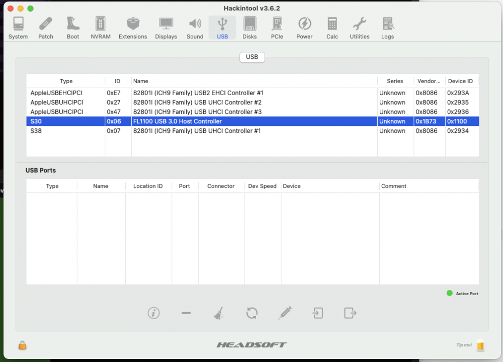

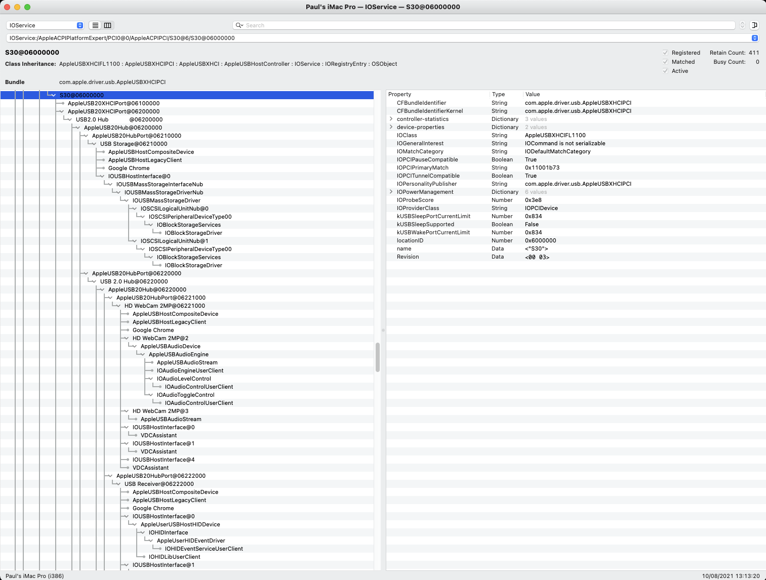

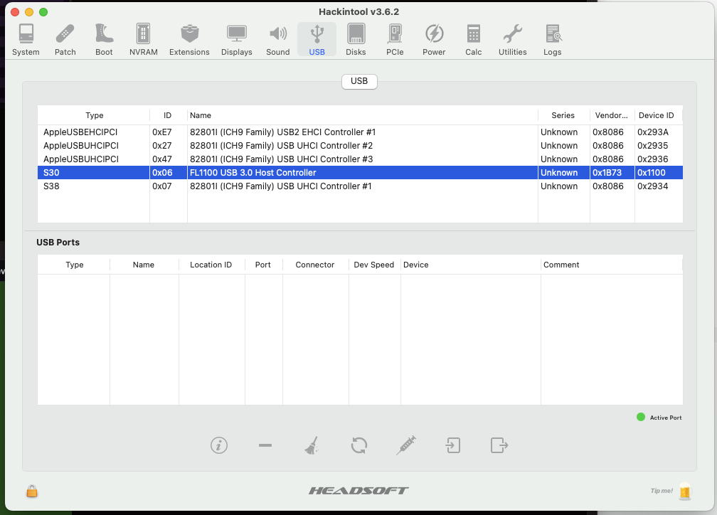

@ghost82 - I can use some help from you. I am on OC 0.7.2 with Monterey Public beta (macOS 12.0 21A5294g).
I have a ASUS PRIME Z490-A z490 motherboard with i9-10850K CPU.

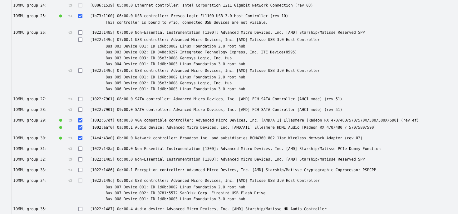

My IOMMU groups are attached - I have passed through the following to the VM
  1. RX 560
  2. USB PCI card FL1100
  3. BCM4360 802.11ac Wireless Network Adapter - This one is a Fenvi T919
I have everything working fine (wifi/ continuity/handoff/ unlock using Apple Watch) though I do see that USB devices have some issues after sleep/wake. I think it is due to what you described in your post on page 32. I have tried injecting the 'USBPowerFresco.kext' which does not seem to help (Added to the kexts folder and in config.plist - also set it to enabled)
I compared your IOReg to mine and after injection nothing changes for me.
Maybe I need to inject all 3 - which I tried but it did not seem to help. Maybe I am doing it wrong because I do not understand the LIBVIRT XML too well.  I tried reading your post on it and went over my head.
The following is my XML and Hackintool PCI details.  I can provide some IOreg screenshots if needed.
Any help is appreciated !
Edited by ab5g

On 8/8/2021 at 9:35 PM, ghost82 said:
Hi, I'm currently on vacation but I'll return on monday evening.
I need a copy of you ioreg to be able to make the kext.
just run ioregistry explorer, then file-> save (or something similar) and attach the saved file here: I will take a look at it and make the power kext when I'll come back.
Thanks for taking a look here's the IOREG. I did try to read your instructions again and here's what I came up with for the USBPower kext. I Think it's working now after creating a USB map. I did delete some USB controllers not in use.

15 hours ago, ab5g said:
Attached is the config.plist , Ioreg and the modified kext.
Ok, let's try..
I see that you have an emulated controller too, the qemu-xhci: this is new for me, as I thought it didn't work with apple, I knew that only ehci (usb 2) and uhci companion (usb 1) worked with apple, but things may have changed and I need to test it (in the following days).
In the meantime, since you don't have attached anything to that emulated controller, delete it from the xml of the vm, so to exclude any possible issue; delete this block of code:
    <controller type='usb' index='0' model='qemu-xhci'>
      <alias name='usb'/>
      <address type='pci' domain='0x0000' bus='0x01' slot='0x00' function='0x0'/>
    </controller>
Then, download the attached kext (only for your fresco), which maps ports and inject power values.
In the config.plist disable the usb part (set Enabled to false) :
			<dict>
				<key>Comment</key>
				<string>USB 2.0 Injection</string>
				<key>Enabled</key>
				<false/>
				<key>Path</key>
				<string>SSDT-EHCI.aml</string>
			</dict>
Can you describe more into details what issues you have with usb devices?
How are you managing sleep/wake?is it set in the vm?How are you waking the vm?
I don't use at all sleep/wake in the mac os vm, but if you describe what you are doing since I have the same fresco card I can try to reproduce the issue..
USBPower.kext.zip
I just noticed from the hackintool screenshots that there was something wrong: you can see all ports were duplicated.
UsbConnector were also wrong: ss are superspeed (usb3), hs are high speed (usb2) and yours were set all to usb3.
Can you attach a new hackintool screenshot with the new kext, just to be sure that everything is ok.
  1. RX 560

I'm having a few small issues with USB devices also. Am using an FL1100 but not doing anything with kexts etc. Everything works fine 99% of the time but occasionally have a few minor issues. Is there any intro or how to on what kexts and other config needs to be configured?
Please be more accurate and describe what are these issues in details.
You need port map and usb power applied, that's what you can read in the above posts and at page 32 for example.
If you are not able share what @ab5g shared here.
Issues are minor but mostly with USB devices which go to sleep and then not wake unless disconnected and reconnected. Also, when I reboot with my webcam plugged in, boot hangs on BIOS screen. Hand-off is also not working (blank screen) but doubt this is related. And more generally, also want to learn how to inject kexts and get this working properly.
Am running Unraid 6.9.2 on Gigabyte Aorus Pro X570 with AMD 3600XT. I'm passing through an RX570, Fenvi T919 and an FL1100 cards. Running Open OpenCore 0.7.1 and Big Sur 11.5.1 in the VM.
The XML config is:

IOMMU groups on Unraid:
Hackintool shows the FL1100 but says nothing about the ports:image.thumb.png.37946174c692a897d7218a082fe38d94.png
ioreg shows this for the FL1100:
I know I need to update the config.plist, add SSDT and load some kexts but not sure which kexts and what to put in each of the files. From reading page 32, I need to copy the kexts, and then update the config.plist with the attached text and good to go?
6 hours ago, ghost82 said:
2137260728_Screenshot2021-08-10at9_53_03PM.thumb.png.1fb53004fa7522d84d0613f62d1f575a.png
Thank you - The ports looka lot better now. I can't seem to delete the additional USB controller - it keeps coming back in the XML for some reason. Today I updated to RC-6.10 (a possible bug maybe).
Please share a copy of ioreg (file--> save) and a copy of config.plist of your opencore (feel free to send this with a private message if you care about sensite data, like serial number and smbios data)

Having hdmi audio on a different bus causes issues.
Check again the usb map in hackintool and let me know.
