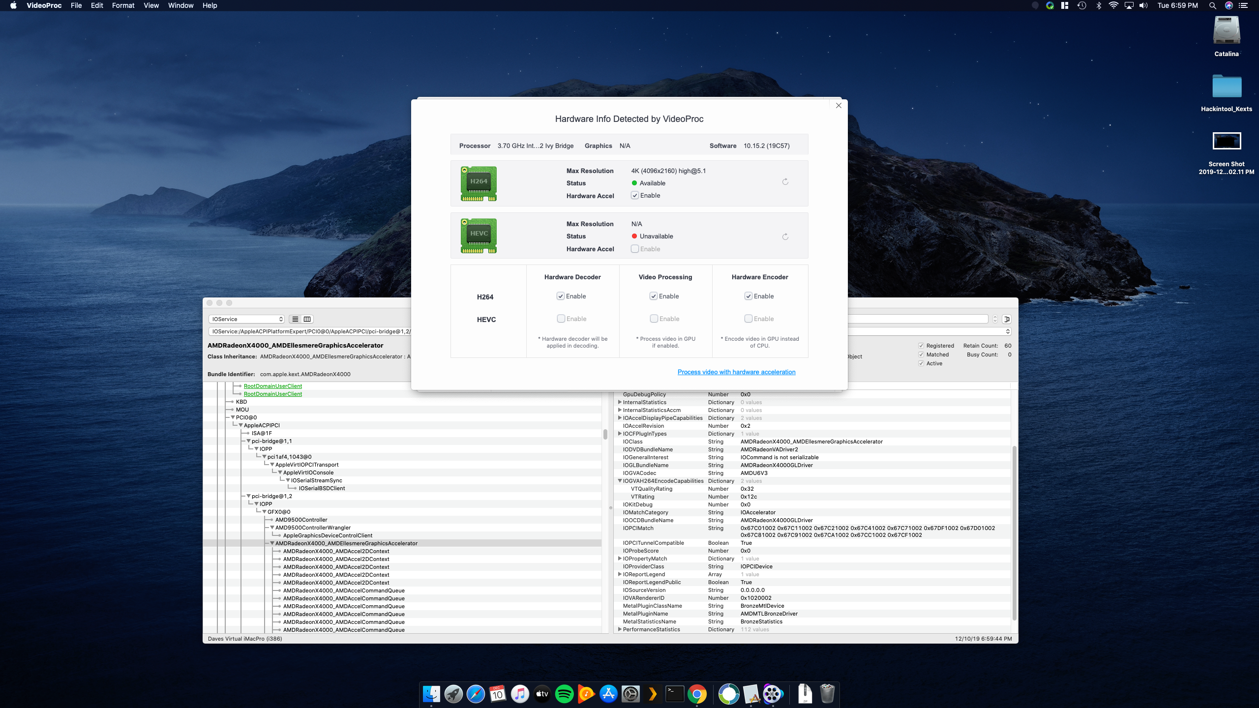

3 hours ago, ghost82 said:
All good, update to 10.15.2 went smooth.
Do you still have the Hardware GPU support? I have it for H264, but for HEVC its gone now after the update. Im on the Latest opencore 0.5.3.
908870868_ScreenShot2019-12-10at6_59_53PM.thumb.png.0747bc9bf2d46cc375f7cbc9c42b9501.png
Edited by david279
This is 10.15.1
Just moving the mouse around was choppy that why i knew something was wrong in 10.15.2.

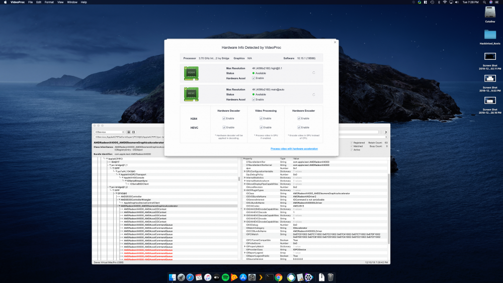

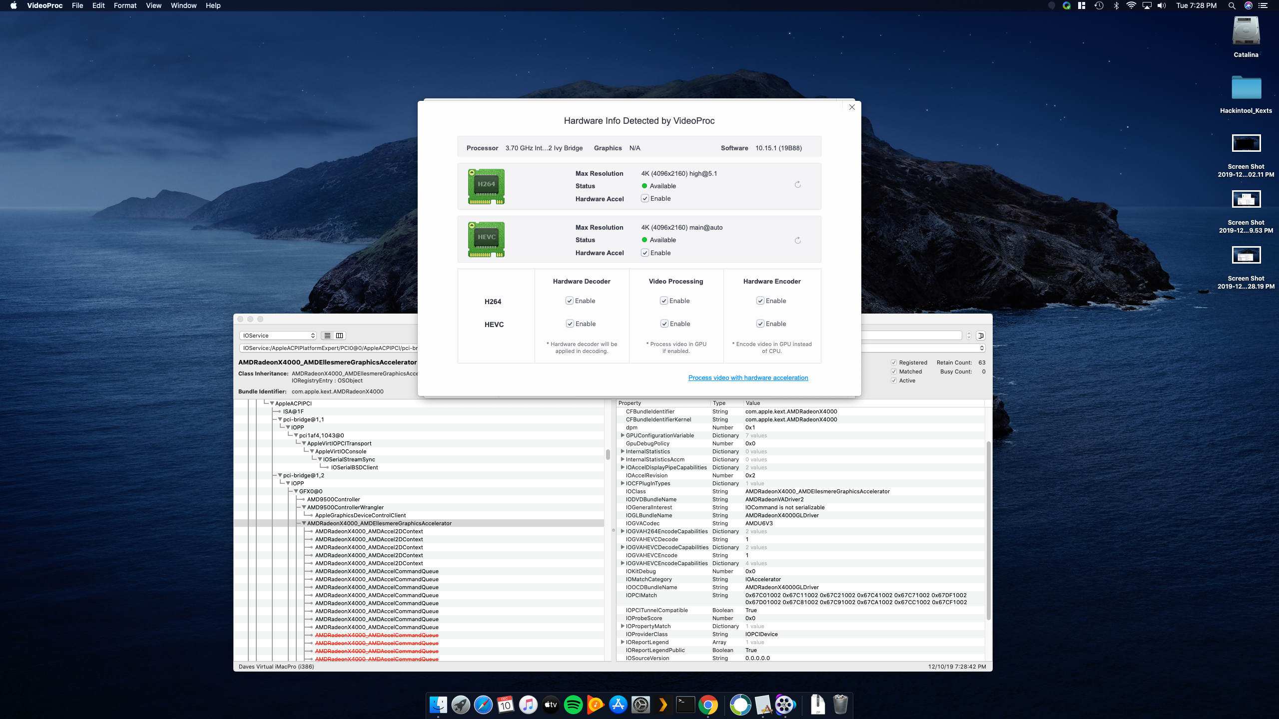

1131161987_ScreenShot2019-12-10at7_28_56PM.thumb.png.6e30da5b6ceb27f9a9ce6e5261b08e0a.png
Edited by david279
I had to use this dummy kext to get HEVC acceleration back in 10.15.2
HEVCEnabler.kext.zip

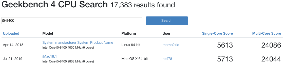

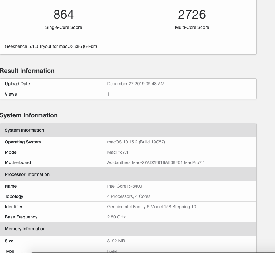

I used geekbench 5, so this score is probably normal.
My suggestion is to look at the details of the analysis, for example in latest 5.1.0 version geekbench is not able to pass some tests in my vm (I don't remember if it was for the cpu or the gpu, most probably the latter), and this is the cause of the lower benchmark score.

So I'm having a torrid time attempting to get  HEVC enabled on my RX570 in Mojave VM. Hopefully someone here can offer some insights.
I have a long-standing Mojave VM booting from a physical SSD.  EFI partition is on the SSD as well, so only one disk configured in VM XML.
Clover v. 4xxx is installed in EFI. RX570 is passed through and is working with Metal support and H.265 reported in VidProc. HEVC remains resolutely disabled in VidProc despite my best attempts.
I've configured my SMBIOS to  be a wide variety of systems from MacPro 1,1 through 7,1 and iMacPro 1,1, all to no avail.
There are a few points of note;
  • I cannot get Clover to load Lilu/WEG from the /other folder. I must install to /library/extensions using HackInTool for it to show as loaded in ioRegistry. (I have checked that load kexts is set to 'yes' in clover configurator)
  • Despite WEG being loaded, my GPU remains stubbornly attached to parent S28@5 in ioRegistry. I understand this should be GFX0 - but I cannot make this happen
  • I've tried updating to Clover 5xxxx but this just hangs at 'scanning devices'. (I understand that newer versions are more trouble than they are worth - I just thought an update might load kexts from 'other'.
The VM is running very smoothly and is very stable. i'd just like to have it as close to bare metal as possible and HEVC is that elusive functionality I'm chasing.
I want to make one last attempt at this before I go through a full fresh install.
Any tips appreciated.
