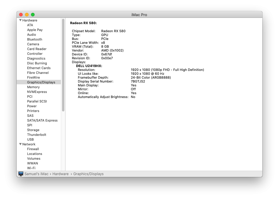

17 hours ago, swallace said:
@Leoyzen I’m running macinabox and ostensibly have everything working perfectly, but cannot for the life of me get hardware acceleration working for the RX580 I have passed through, despite the fact that it’s outputting a picture fine, shows up in system info fine, and I have the latest versions of Lilu and WEG installed. I’m considering killing the whole VM and building it by manually like you mentioned to see if that helps resolve the issue. Do you have any resources you’d recommend on getting started setting up the VM manually?
Do you do all the things I've mentioned?
  1. Make sure your smbios is MacPro7,1/iMacPro1,1
  2. Using Latest Lilu/WEB
  3. Put the audio and gfx in same bus
If you do so, post your screenshot of sysinfo and your graphic vendor

@Leoyzen I just setup a fresh Catalina VM from scratch using macinabox, and configured the settings you recommend, just to be sure.
My VM is setup as an iMacPro1,1 ; Lilu/WEG is installed and updated via Clover Configurator, and I have setup audio and gfx to be in the same bus. You can see that the GPU is showing up as passed through to system in the following image:
My GPU is a Sapphire Radeon RX 580 Pulse (Model SKU 11265-05-20G)  (amazon link there, if helpful). Also, I've attached my VM's XML config below:

@swallace It is very strang, you don't even have metal support according to your screenshots.
Check this:
1. What is your Lilu/WEG version? Don't use clover updater, manually download from github and place them into kext/others.
2. What is the BIOS version of your graphic?Download from techpower and add it to your xml.
3. Then check your Lilu/WEG is loaded(you can get the log from hackintool)
