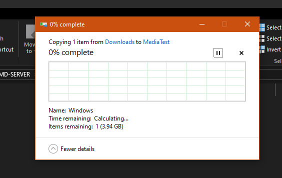

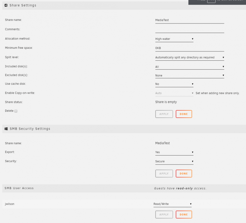

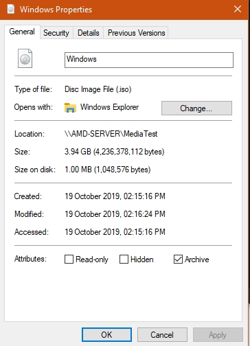

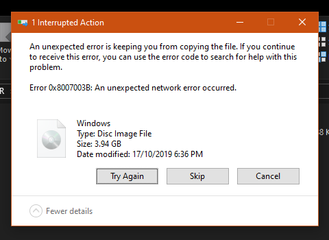

I know their are millions of post on here about setting up SMB and windows, and believe me i feel like i have tried it all at this stage, i have no idea what the actual problem is but on my windows 10 PC (1903) connects and i can browse the shares i want to etc but i dont seem to have write access or i do and i dont? it normally copies a 1mb version of what im trying to copy the errors out, ive included screenshots which hopefully show my problem and enough info to figure this out, considering at this stage a fresh install of windows and unraid, any help would be massively appreciated as this has had me pulling my hair out for days now.
Does it work with a Public share?

same issue with public share and ive tried deleting them all related to it and adding them all in different formats so jwilson@AMD-SERVER AMD-SERVER\jwilson just the username also trying the ip instead of hostname, streams in unraid does show me accessing it as my user if that helps :/

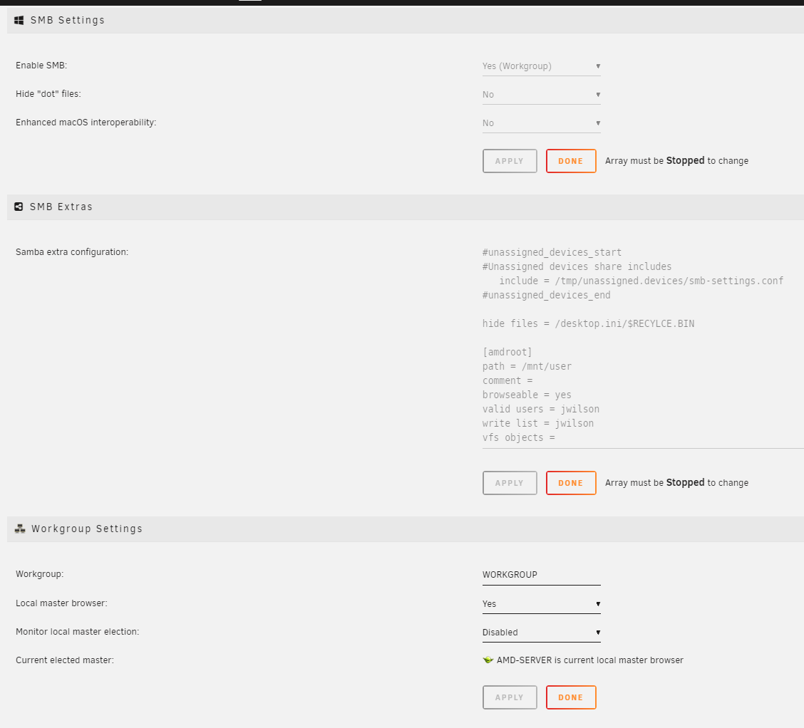

Edit - ive also now turned off windows search and removed a registry entry as directed in a link on the link you sent but still no luck, larger files just error out and only copy a 1mb version still

Do you have booked NICs by any chance? I had a similar issue. Unbonded, or is that debonded, disabled one NIC and all worked great.
do you mean on the windows pc or unraid? as on the windows i do have a bridge one is internet in for pc and shared with another port which goes onto a wireless AP and on unraid i have two nics both bonded together?
Unraid server. If they are bonded try just using a single NIC and see if that helps

I have finally FINALLY found the culprit, it was partly two things, for some reason my unraid box which has 3 nics was set for dhcp on two and static on another but all three had the same un-changeable mc address even though the nics have different macs themselves, and my windows pc nic was basically not playing nicely with the AP i have bridged.
