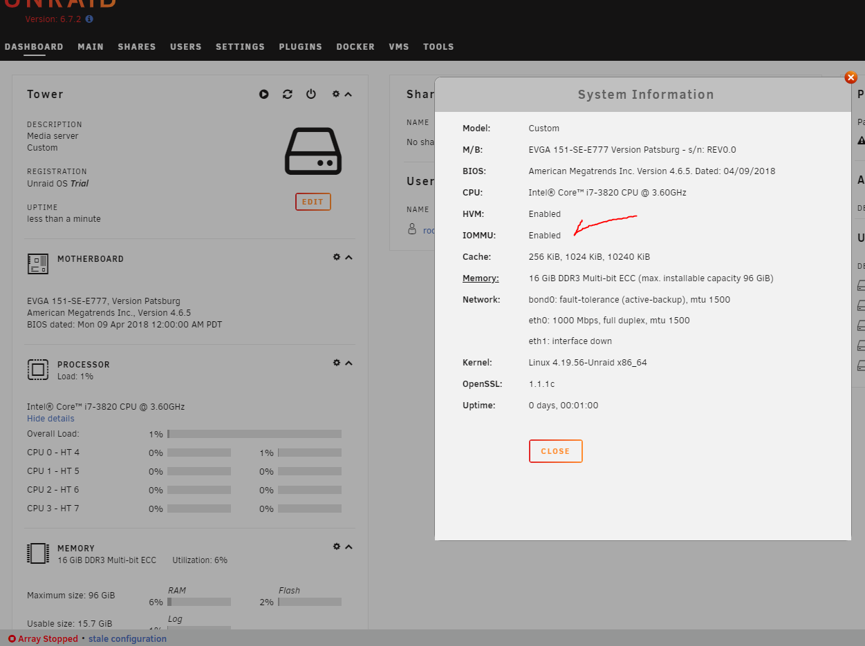

(Edit) I was able to install it and have HVM and IOMMU enabled! I now need to upgrade the CPU with the i7-4930K I purchased. Quick question, I want to run one main VM on unraid (which will be mostly on 24/7), and use as much power as possible without really starving unraid which would be like, plex, data, backup.
1. Should I have to leave like 4GB of ram, and 2 cores unused for unraid?
2. What are your suggestions?
3. What would happen if I use all available resources for a VM, does unraid/app/dockers still uses whatever it needs run well?
