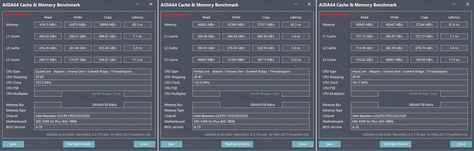

so I have some serious differences in L3 cache performance for my win10 vm depending on cores being used.
there must be something fishy...

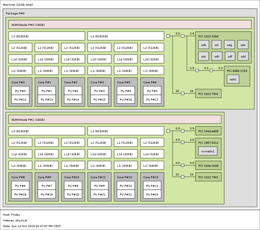

I'm using cores only from 1 numa node (eg node1, cores 6-11,18-23).
Numa Node 1 is connected to my GPU aswell as my NMVe SDD (see lstopo attached)
So my problem here is that with cores from 1 node depending on core assignments in win10 I get totally screwed benchmarks for L3 Cache performance in AIDA64.

Each core has its own L1 / L2 so it scales pretty well.
In contrast, L3 is shared between groups of cores. As you can see on your numa config, each of 6-8 and 9-11 groups has its own L3 cache.
So depending on how the cores are assigned (e.g. 6-9 is different from 6-7+9-10 despite both being 4 cores) AND the exact circumstances of the test run, your test results will differ.
What issues do you have on your system that would lead you to think it's related to L3 performance?

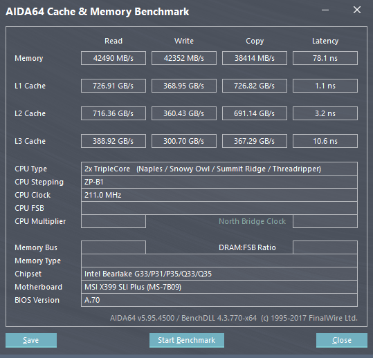

anyways I kinda fixed it.
L3 cache benchmarks looking fine now:
L3 read 388GB/s
L3 write 300GB/s
L3 copy 367GB/s
L3 latency 10.6ns
(6core 12threads)
that's more like the results I would have expected at the beginning.
If anyone else has some issues regarding this - could share my findings.
