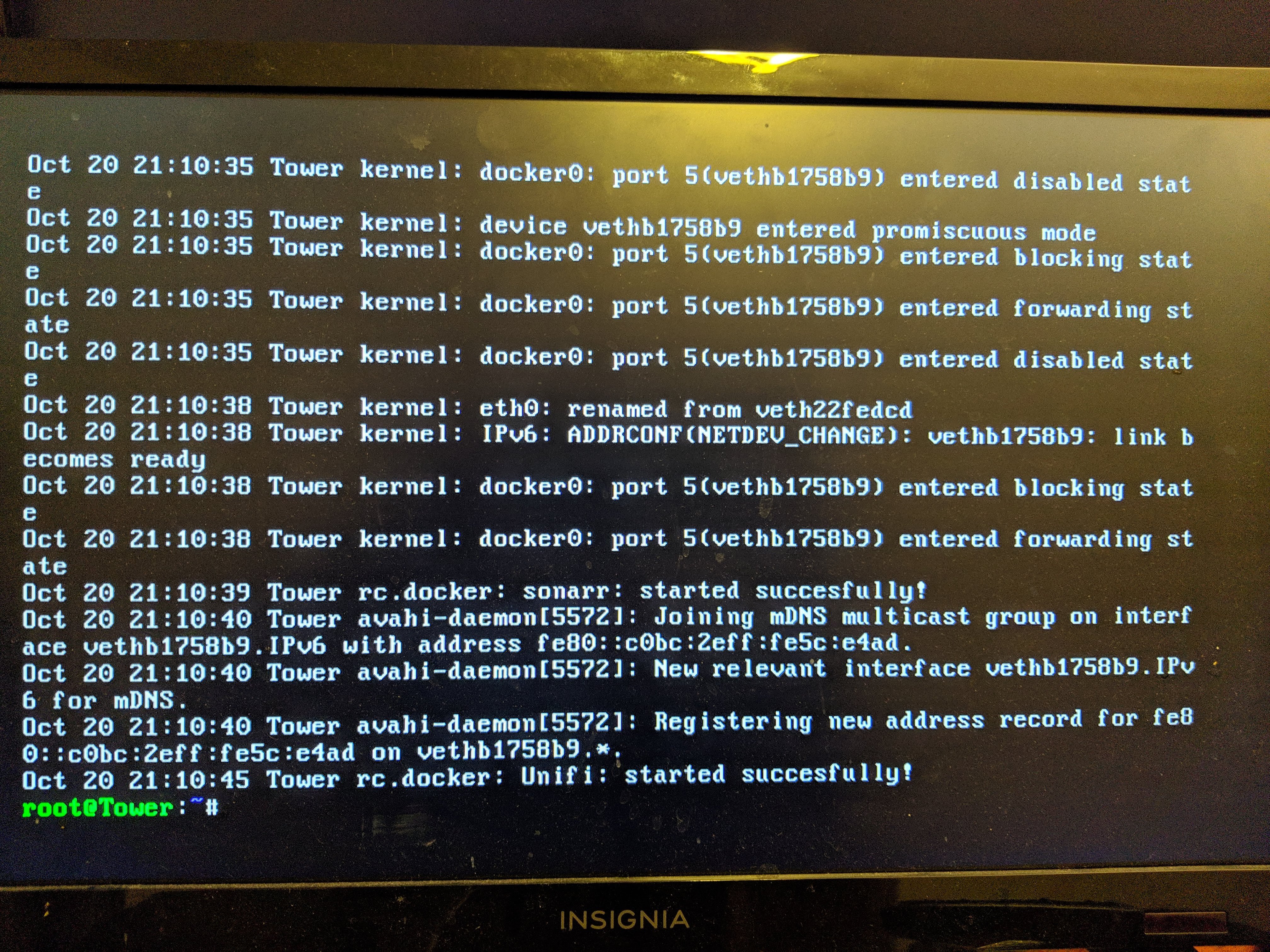

The last few lines of syslog can be seen attached. Any pointers?

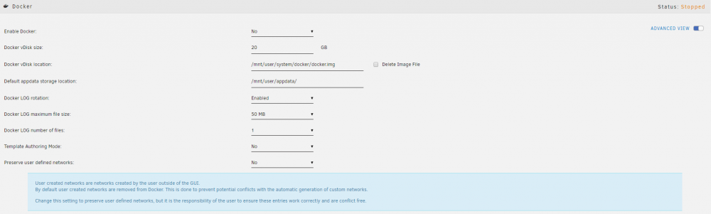

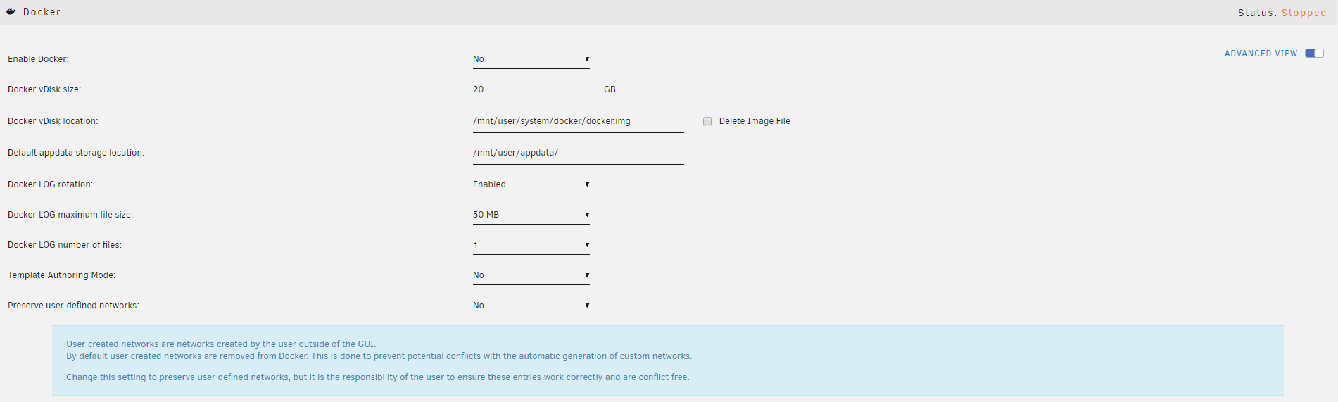

You have config "Preserve user defined networks:", may be you could try set to "no" ( docker setting advance view )
Edited by Benson
Tried that. After starting VM Manager, network goes down. Attached is diagnostics after the crash.
