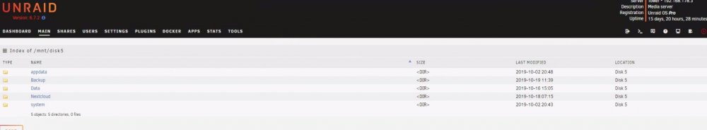

I wanted to do a backup of my server with duplicati and got this running. It copied arround 900 GB of 2.5 TB to my NAS verry slowly ... but ok ... i can wait :/.

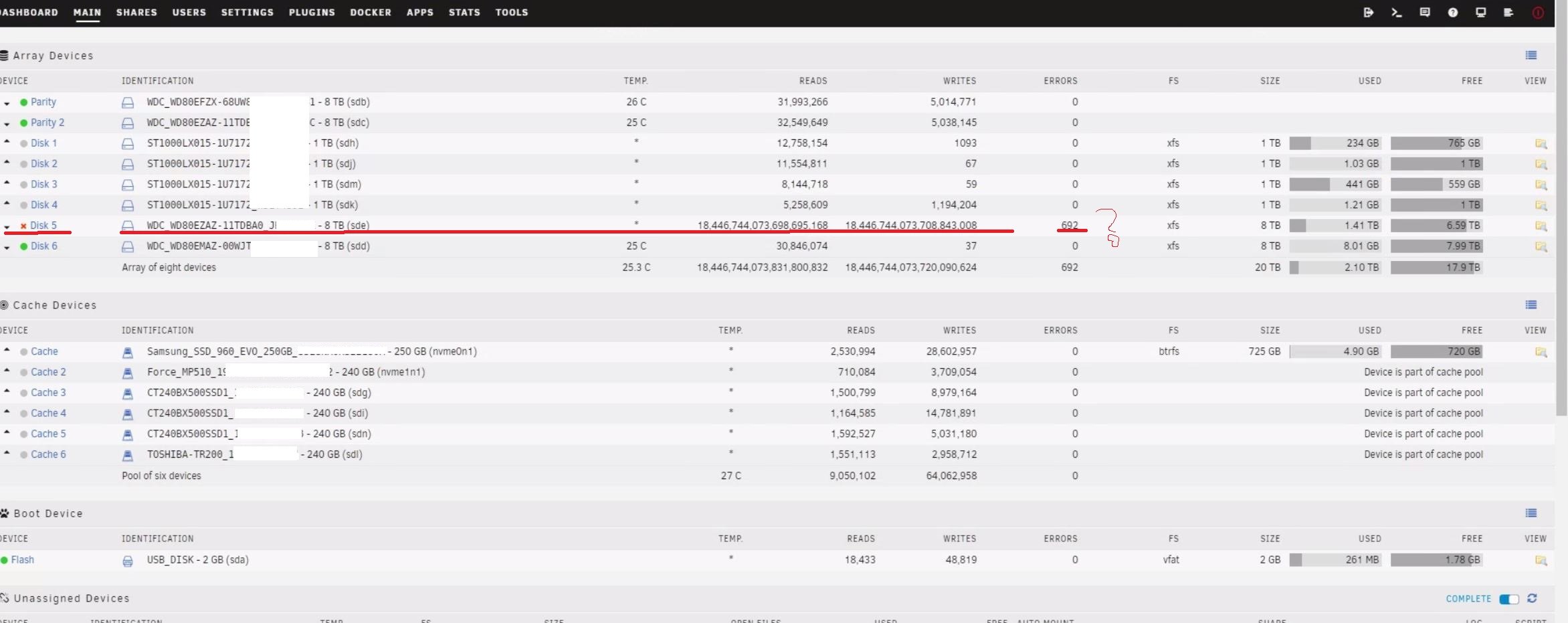

Yesterday i went to check on my server and it displayed an error message that one of my 8 TB drives has failed.
unraid.thumb.JPG.5af02dcb65f18a3942f5a24247235171.JPGunraid2.thumb.JPG.a75309d7e23d829d77ccbaedf0f675e9.JPG
I'm not sure how to proceed now. As i've read unraid is currently emulating the one 8 TB drive via the parity drive and my data is safe for now.
I need to get a spare drive today ....
I dissabled all dockers besides krusader and there are no vms on that machine.
This drive is brand new and successfully did the preclear..... is there a chance the drive is fine and unraid just had a "hickup".
I have a second 8 TB Data drive which currently sits empty (Picture 1, last drive)

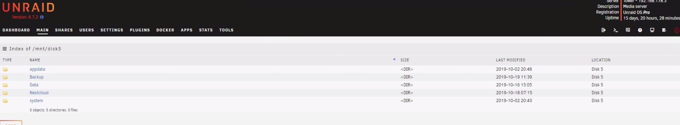

I know that i can install krusader and copy over the files but because im a noob  i'm not sure how to do so fasely without causing issues with the shares? ( Picrure 2)
System, nextcloud and appdata are folders created by unraid. If i go with krusader can i just copy them from disk 5 to disk 6?
Thank you :)
Please post the diagnostics: Tools -> Diagnostics
Looks more like a connection problem, but since disk5 dropped offline there is no SMART report, power down, replace/swap cables on that disk and post new diags.

I restarted my server and it seems as if my backplane is dying. The drive is not recognised when i leave it in the slot it was before.
On a diffrent port (just sata) i clould assign the drive again and now the rebuild is in progress. 8 TB will take a day to restore :/

Disk look fine.
Forgot to mention earlier, you're using a SATA controller with or connected to a SATA port multiplier, it was showing some timeout errors in one of the connected devices in the previous diags, they are not recommended as they then to cause timeout and/or dropped devices, but they do work for some users, just something to keep in mind.
