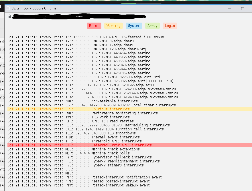

Hi Everyone. Just replaced Disk 1 with a 4Tb from an original 2Tb.
Looked at the logs and see Thermal and Spurious interrupts for the Root.....is that the USB stick?
Have attached screen capture of logs and Diagnostics.
Appreciate any advice\help.

Just to add, all temps are good, CPU 41'c, motherboard 27'c, 120mm fan on the blowing cool air on the 9211-8i's
Highest hard disk temp 31'c.
IRQ16 is getting disabled, it's not that unusual and sicne it's not being used by anything critical should be OK to ignore, though a bios update might help.
Thanks johnnie.black, much appreciated.
