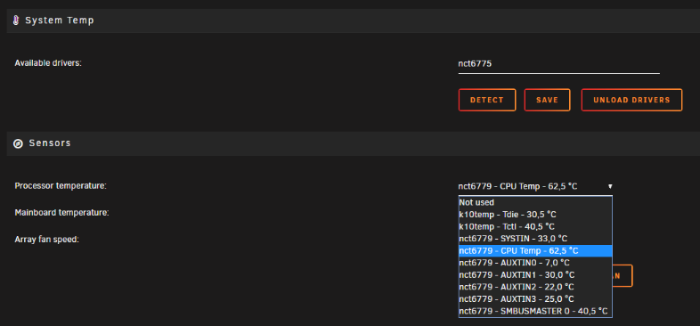

3. System temp plugin: Since the beginning I was never able to get correct temperature values. They are all minus and and not changing at all e.g. the cpu says always -62.5. I also could not install an other driver than the suggested one although there are at least 4 types of fans in the system present (3 of which are noctua). (Assuming the driver refers to noctua).  What am I doing wrong?
My final goal would be to set one of them to the temperature of the hottest drive after the data issue is fixed. If the HBA card has one as well I would like to connect one to that too.
4. Additionally, the numbers (Fan #) detected by unraid are also different than to the plugs on the MB or in the bios. Can I change that?

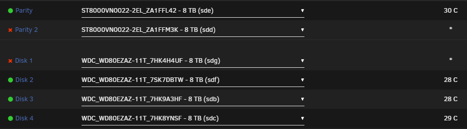

6. How do I set up dual parity correctly?
Just starting the array after preclearing and formatting the disks is not the solution. Also not letting it do a parity check.
I don’t know where the errors come from and I don’t know why parity two is disabled. I think the errors came after the second parity check where I hoped it may build the second parity disk.
State of now is that the second parity is disabled as well as one array drive (not the one with the SMART error). How do I get these going now or what is the issue there?
It could may be connected to that but the working and the disabled drives say that:
Or could it be that the second parity does not allow empty bays between the disks?

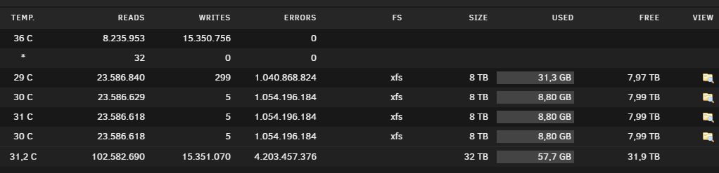

7. In an earlier attempt there was suddenly data on the drives. What is this?
imageproxy.php?img=&key=e5eec7c5c933ca166.thumb.png.6cf1afd1585c01f9a64c73c56320469c.png
8. Overall this is the current status of my array but I think there is a lot not how it should be…
It would be very nice you could give me some hints on there I should search to fix this problem. Btw Disk four is the one with the SMART errors.

Disks look fine, most likely a cable/connection issue, so you should check/replace cables, then start array, if emulated disk1 is mounting correctly and data looks correct you can rebuild on top, if not or there's no data yet it might be best to do a new config and resync parity.
There is no data yet, wanted to have it stable before. So new config it is.
Regarding the cable, I already had that idea and run 8gb preclear ein each bay but could not trigger the error again. Do you think the cable is just the cause for the SMART errors (issue 2) or also for some of the others?
Should I do the new config and then run preclear in each bay again to test the cables again?
How would I correctly set up a dual parity? Is it possible to leave bays empty between disks for later?
UDMA CRC errors are almost always a bad SATA cables, but can also be a bad enclosure, controller, port.
Same as single parity, just assign a disk and let it sync, it can be done at any time.

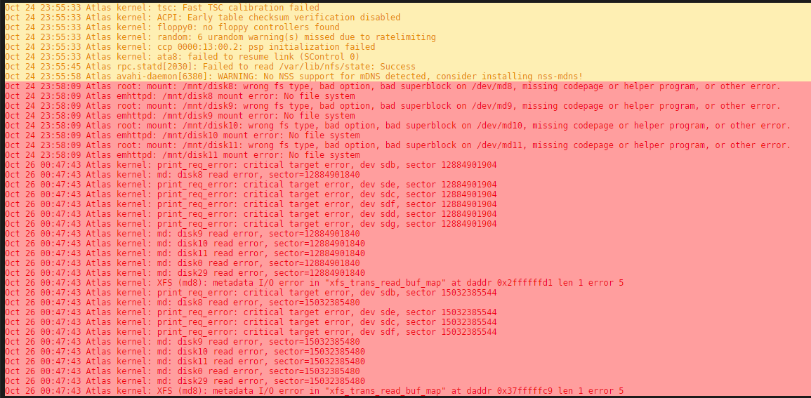

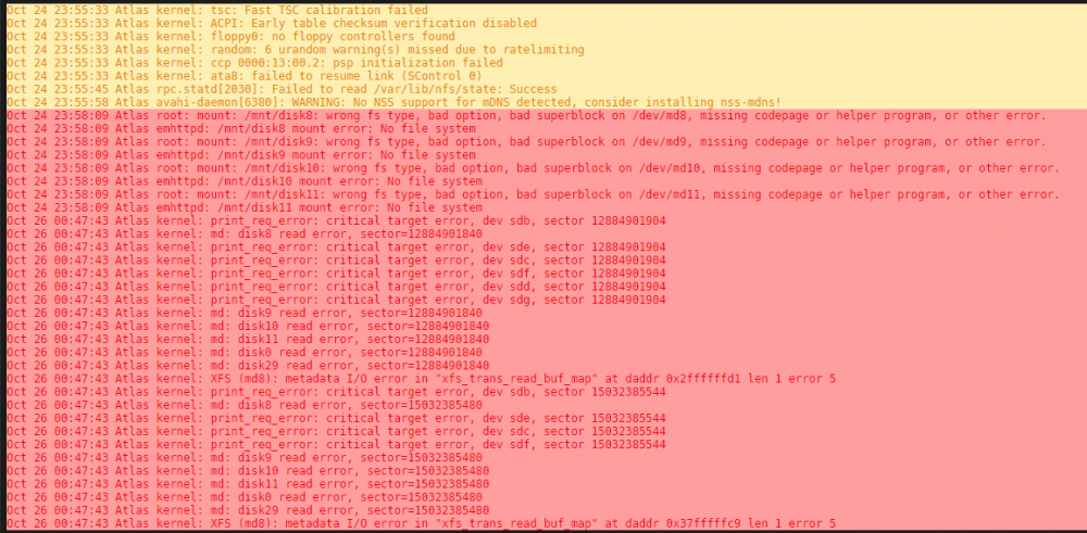

Btw I did a new config now and did the parity check. Everything was fine and looked good until I have added a folder:
My only clue is that it might be connected to the trial key which expired today.
atlas-diagnostics-20191026-0043.zip

You're having errors in multiple disks at the same time:
Oct 26 00:47:43 Atlas kernel: md: disk9 read error, sector=12884901840
Oct 26 00:47:43 Atlas kernel: md: disk10 read error, sector=12884901840
Oct 26 00:47:43 Atlas kernel: md: disk11 read error, sector=12884901840
Oct 26 00:47:43 Atlas kernel: md: disk0 read error, sector=12884901840
Oct 26 00:47:43 Atlas kernel: md: disk29 read error, sector=12884901840
This is likely a controller, cable or power problem, start replacing one thing at a time.

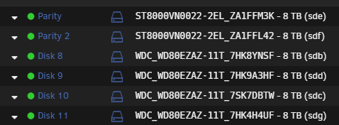

Sorry but I don’t see which one has growing CRC errors. If we are talking about disk 8 (7HK8YNSF), it has 5 counts since they occurred a month ago. In the meantime, I have moved disks many times and added or at least physically touched several components and I have never noticed that there was a count added.
These below mentioned disks are connected to different cables (at least if I follow the numbering of unraid). 0 is the parity and on one cable, 8,9,10 is on another (but just two of them with errors) and 11 is on a third cable. Disk 29 however I don’t know what this one is. The Unraid USB stick maybe, which is connected to an internal USB 2.0.
You were one who mentioned getting CRC errors, CRC attribute doesn't reset, so if it's not increasing there's no problem, they are just old errors.
Disk29 is parity2
The two facts above and that the error occurred seconds after I have added a share make me feel that it is not logical to conclude to the cables.
If they are on separate cables it's likely not a SATA cable problem, most likely the controller or power supply, it's a hardware issue, it won't have anything to do with a share being created, don't forget you already had disk errors before when parity2 and disk1 got disabled, likely related to same issue, though since you don't have syslog from that time can't say for sure.
