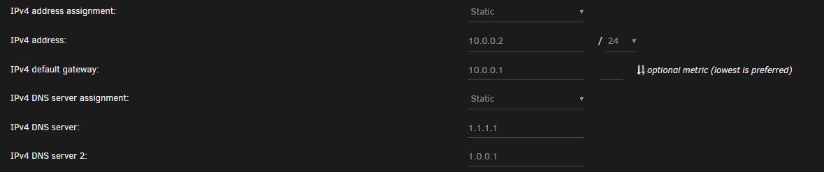

My unRAID server is on VLAN 3 with the IP of 10.0.0.2 with the Switch being 10.0.0.1

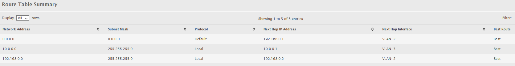

My ISP provided router is 192.168.0.1 and connected to port 1 of the switch, which is part of VLAN 2 and has an IP of 192.168.0.2
I have routing on the switch and setup routing for each VLAN however it is still not working. Unsure if someone from here can help?
unRAID network page:
EdgeSwitch Route Table:
