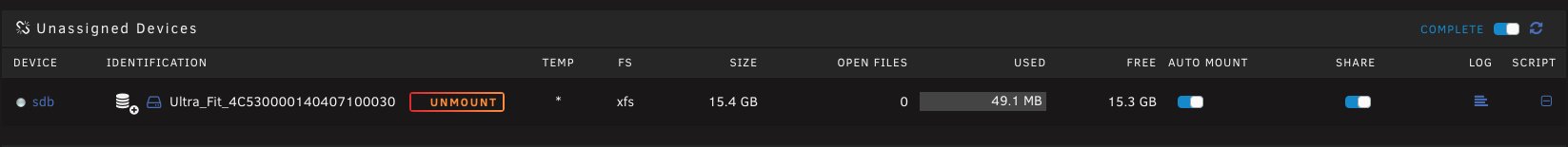

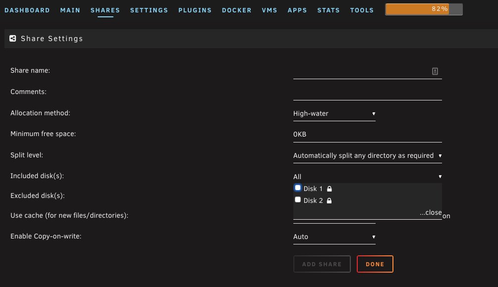

I'd like to create a SHARE on a USB stick (added as UNASSIGNED DEVICE).
I plugged in USB stick into server, and I can see USB drive under UNASSIGNED DEVICE. I formatted USB dive with xfs.
But when I go to SHARES and click on ADD SHARES, I cannot select my USB stick as a disk.
How do I solve this?

Unassigned Devices does not participate in standard Unraid shares.   However if the device is mounted then there is a ‘share’ toggle against the drive that can be used to share out the whole drive as a single share.
Yes, I DID toggle ON this button. However, I can still not CREATE a SHARE (under ADD SHARE) and specify that USB as a disk.
The principle reason why I want this is so that I can back up my app data on the USB. To create a backup though, you must specify a share, and since I cannot create a share on a USB, I cannot specify the share for saving app backups.
This is, to say the least, maddening.

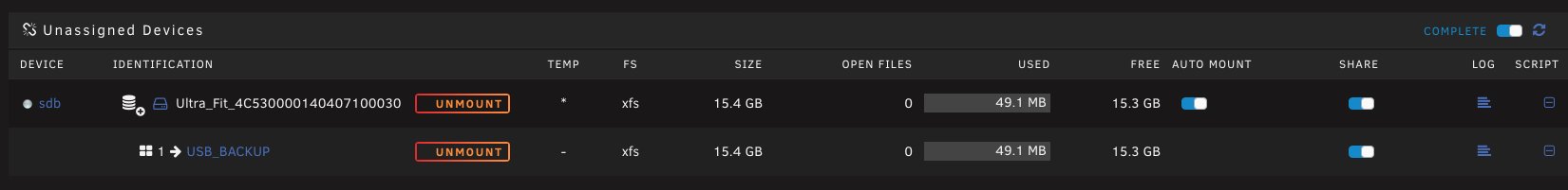

Do you see below what I mean? I can't find the USB share anywhere. nor can I create SHARE on my USB.
Wrong place to look for the share. Press the + sign on the screenshot I quoted above (look to the right of "sdb"), it will expand to show you the mountpoint, which is the same as the "share". It is normally rather cryptic but you can rename it to something more useful (click on it and type in new name and then enter)

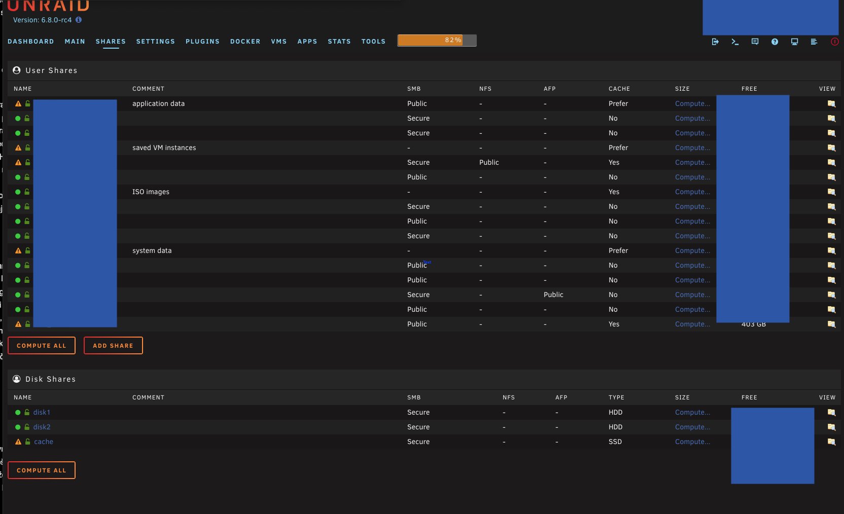

I understand, and I did. Still,  I can't see the share anywhere.
(Theoretically, I should see this USB_BACKUP share under SHARES->DISK SHARES. But I do not. )
You are very confused.
A share is access in the following way (I'm assuming you are using windows and thus SMB)
  • via the network from \\servername\sharename
  • directly within Unraid by pointing things to
    • User share: /mnt/user/sharename
    • Disk share: /mnt/disk#
    • Unassigned devices: /mnt/disks/sharename (in your case: /mnt/disks/USB_BACKUP)
You don't "access" a share by going to SHARES->DISK SHARES.
You "see" that USB_BACKUP is a share by the blue button under the "Share" column on UD.
That to signify it is NOT on the array, unlike the SHARES tab, which specifies shares on the array.

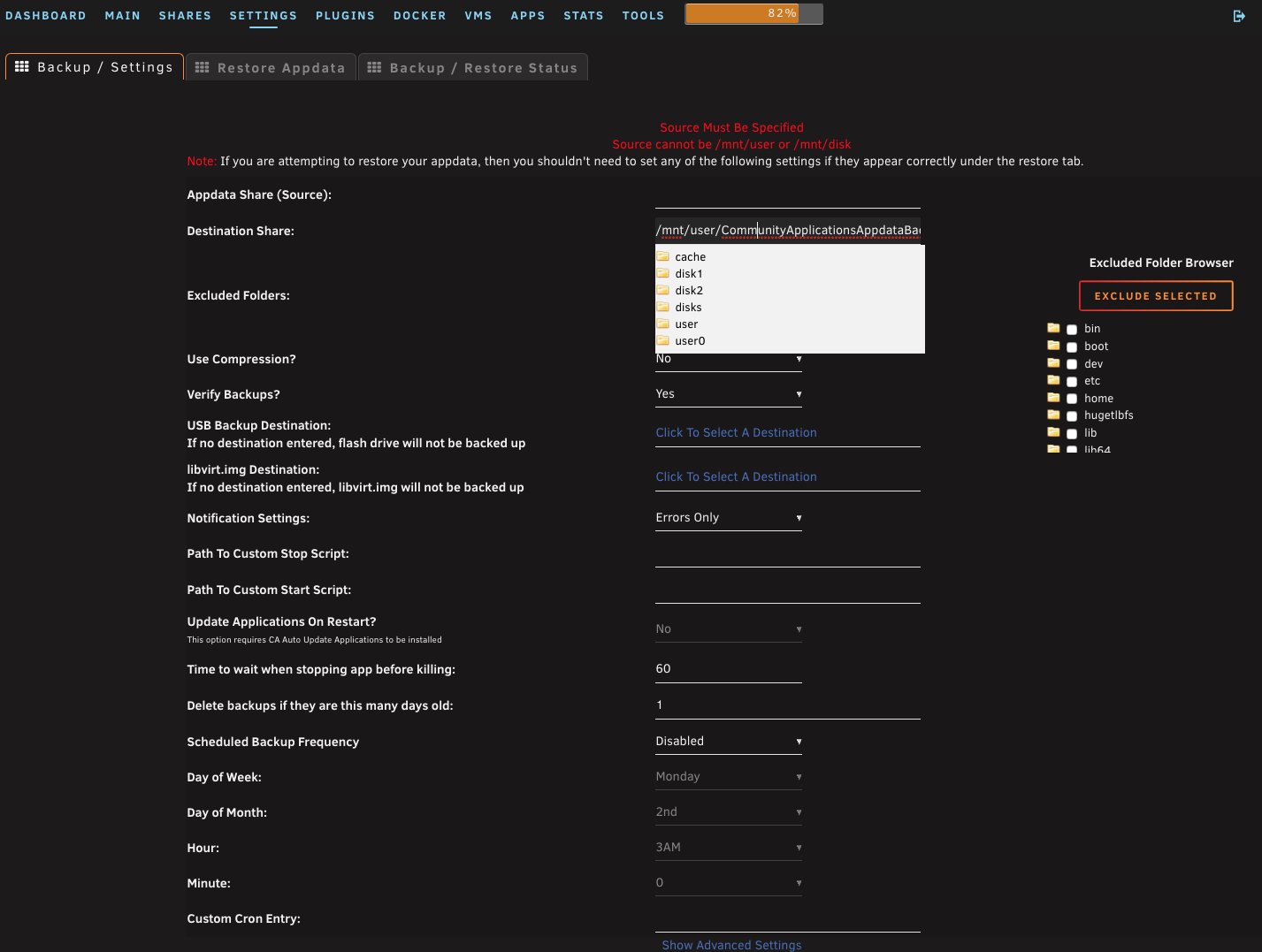

Ok. I included another snapshot. Why can I not see USB_BACKUP as a destination for app backup?
Below (and what you've said) indicates that APPS cannot be backed up, UNLESS the destination is a SHARE on ARRAY?
Edited by emod
type it in
/mnt/disks/USB_BACKUP/folder_name
That worked. Thanks. (A bit user-un-friendly in UNRAID)
You are making use of a facility that is not part of the core Unraid product, but a 3rd party add-on.
Or to put it another way, the backup plugin does not support the unassigned devices plugin.
This is actually done to make it more user friendly, as supporting UD as a destination via the GUI means that other folders are also accessible that don't need to be (user, user0, direct disk shares etc) and could potentially cause an issue under certain circumstances.
But, as noted, you can set the destination anywhere by simply typing it in.
