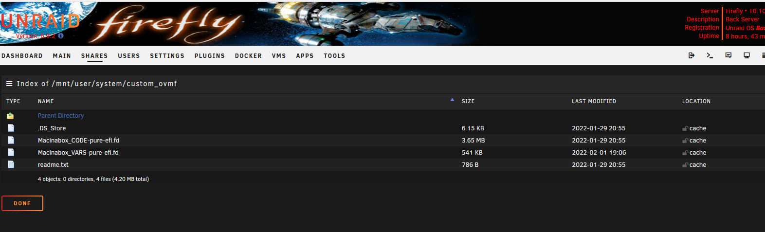

So about the "master var store" issue. Deleted macinabox with the templates and everything but still keep getting it. Catalina is the only one that does this so far for me. Any  kind of suggestions would be appreciated.
What I tried knowing it wouldn't work was to copy the same path that working big sur install has for var. Once you do that then it starts giving an error about directory not existing for opencore.img.

Do you see the files in your system share?

So i have removed Macinabox, the macinabox appdata, deleted the docker template and so on and reinstalled.
I no longer have method 1 and 2. So that looks consistent
But i am still getting the error
"operation failed: unable to find any master var store for loader: /mnt/user/system/custom_ovmf/Macinabox_CODE-pure-efi.fd".
my XML has this in it
 <nvram>/mnt/user/system/custom_ovmf/Macinabox_VARS-pure-efi.fd</nvram>
and the file referenced exists
root@Tower:/mnt/user/system/custom_ovmf# ls -larth
total 3.5M
-rwxrwxrwx 1 root   root   786 Dec 19  2020 readme.txt*
-rwxrwxrwx 1 root   root  3.5M Dec 19  2020 Macinabox_CODE-pure-efi.fd*
-rwxrwxrwx 1 root   root  6.1K Dec 19  2020 .DS_Store*
drwxrwxrwx 1 nobody users   48 May 14  2021 ../
drwxrwxrwx 1 nobody root    90 Jan 26 16:17 ./
not sure where to go now...

I deleted the custom_ovmf dir.  I believe i am making progress. I will report back later. Thanks all
I am guessing my Macinabox_VARS-pure-efi.fd was somehow corrupted/broken. Or maybe my entire Macinabox was broken!
Either way, I am the proud owner of a clean install of Monterey.

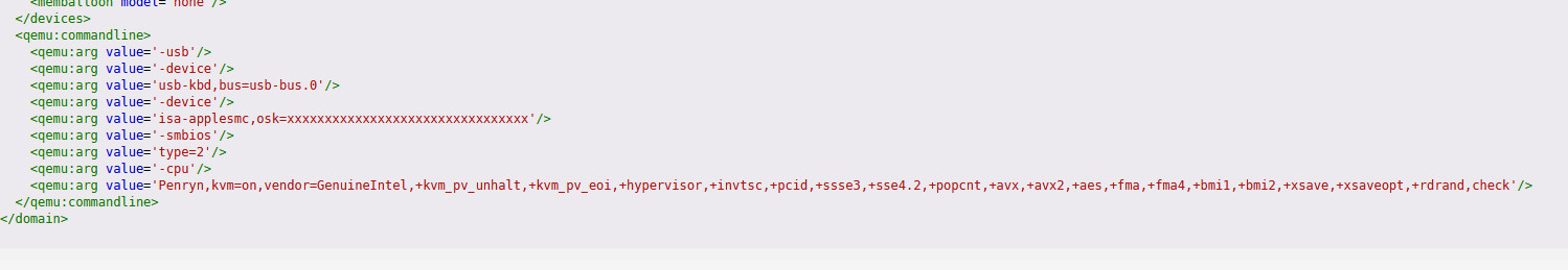

Added custom qemu:args for macOS
topolgy line left as is
custom ovmf added

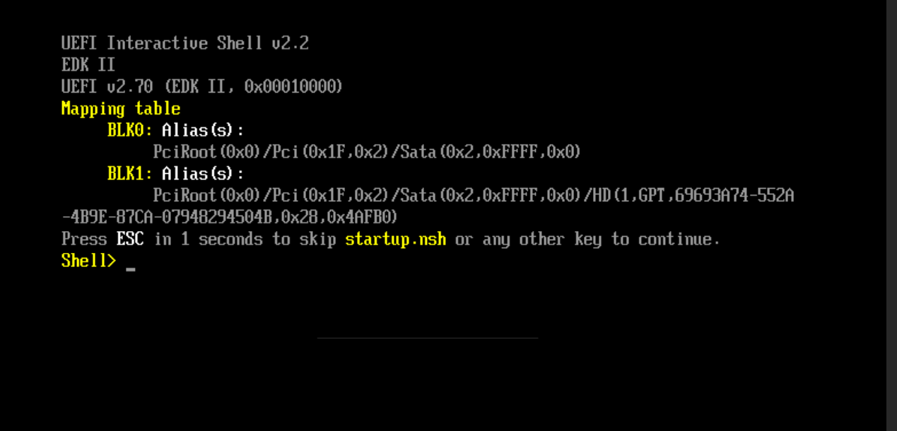

after installing Monterey, just as presented in the video, the bootup-disk is not available. I get:
Any idea?
