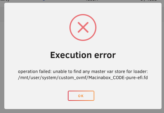

I have been trying to install monterey three times now but it never works, btw should the part where you run the userscripts complete in a few seconds ?. After I start the vm I can only chose from base system, uefi.., reset nvram and after selection the first option the vm just rebots back to the same menu
I followed your video exactly, but I am running into an issue.  The VM does not show up after I run the scripts.  Everything says it was successful, but no matter what I do, I cannot get the VM to show up.  What can I do?
I tried installing both Monterey and big sur with the same result where the userscript completes directly after running and the vm is unable to install.
But I checked the log from the macinabox app when running and noticed that it says it has only downloaded ~2500bytes
and I am guessing that this is the problem ?

Hi Sorry to sound like a numpty
I followed the video guide ran the user scripts left everything as set in the template and got this error message when when I went to run the VM for the first time. I have not edited the xml etc.  I am trying to install Monterey onto the server so I can see if it will run the  version of Filemaker I have before I update my MacBook Pro. I do not know much about editing code so please be gentle on me.
Thank in Advance
  Martin
So I don't use Macinabox but it seems that the custom ovmf file is missing off your drive. I can't tell you if it is just that it never copied or has ended up in a different location.
You could just see if it is somewhere under your appdata/Macinabox folder or just download it.
https://github.com/SpaceinvaderOne/Macinabox/tree/master/ovmf
The location specified in the VM configuration has to match the location it is stored on your drive and you should be good to go.
Hi Thank you for the info I will see if it downloaded and then let you. Know how it goes
