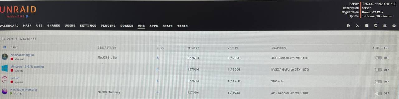

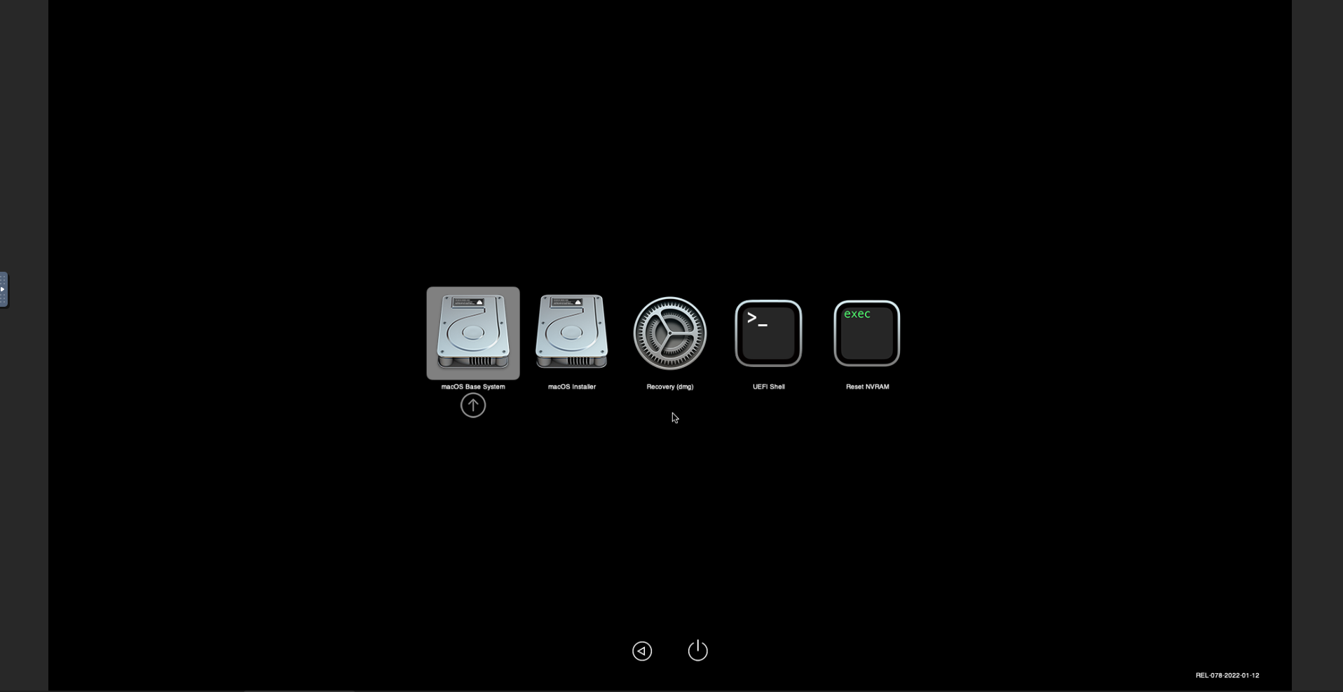

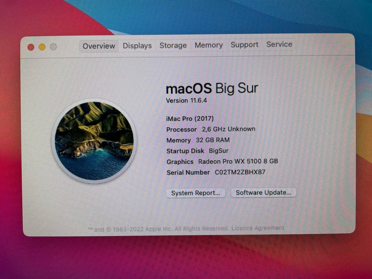

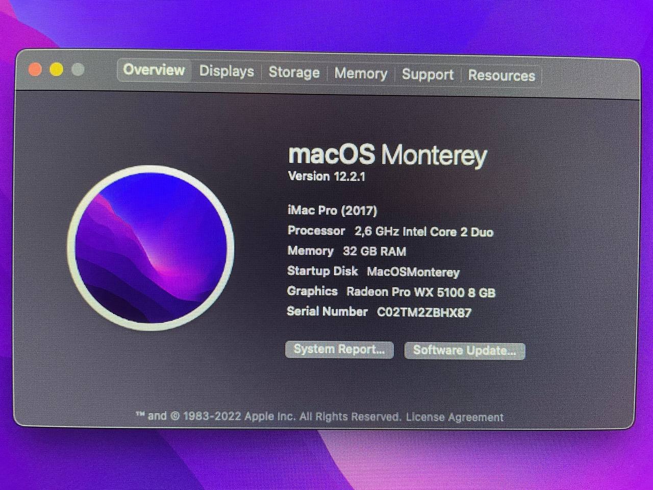

@ghost, @Exlife. Well, It looks between your help and some tests I finally made it work.
FInally I copied from my Windows VM the piece of the USB PCIe directly to my MAC VM XML and plugged the mouse and keyboard there. And it worked great both in Big Sur and Monterey.
I copied below fully my XML if it could help someone and a couple of screenshots.  Btw, the USB pcie used is around 30 Eur in amazon

followed youtube tutorial up to this point
but im having a small issue, after the auto restart from initial install i cant boot into the system and these are the only options i have
running e5 2620 v2 on IBM x3650 m4
Edited by weaver8185
spec list
You have to choose "macOS installer"

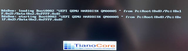

Hi Weaver8185 did you get Monterey to install mine just keeps looping around to this screen?
I have managed to get Monterey installed and I can boot the vm using vnc. But when I try to add my Radeon RX 560 with bios it crashes directly when starting up with this message:
