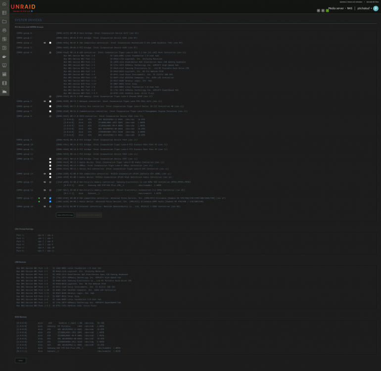

So my understanding of what these errors are indicating is that the Unraid Linux kernel is trying to request access to the card on bus 0x04 and pass it to the VM. For what ever reason this process is failing. This is either a hardware/firmware issue with the motherboard, PCIe bus, video card or a kernel/QEMU software issue.

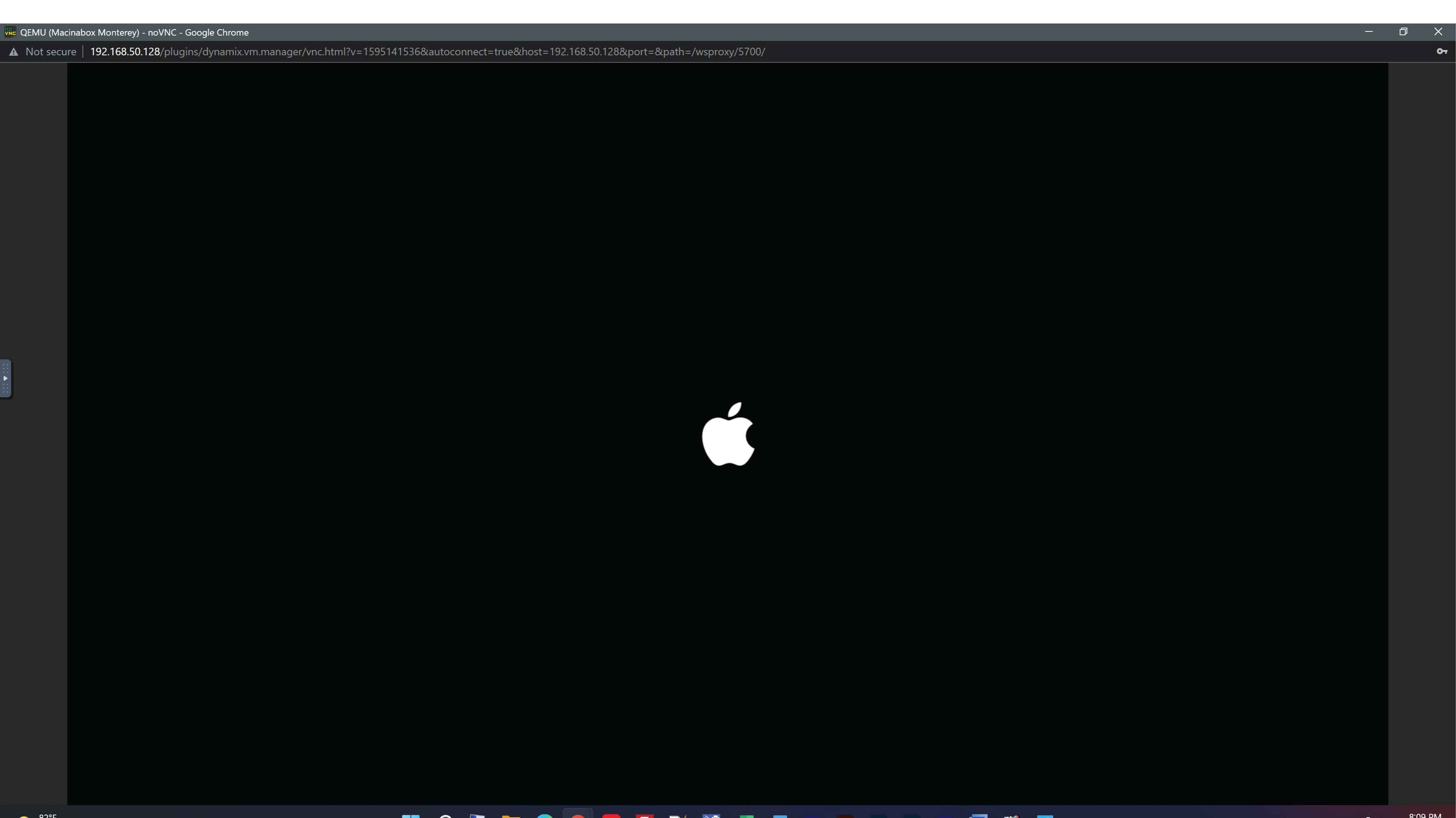

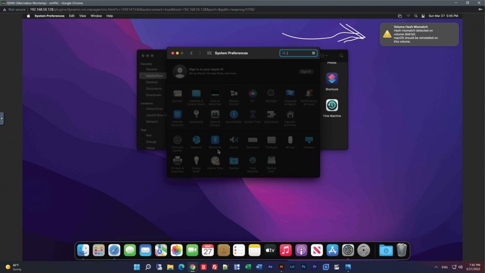

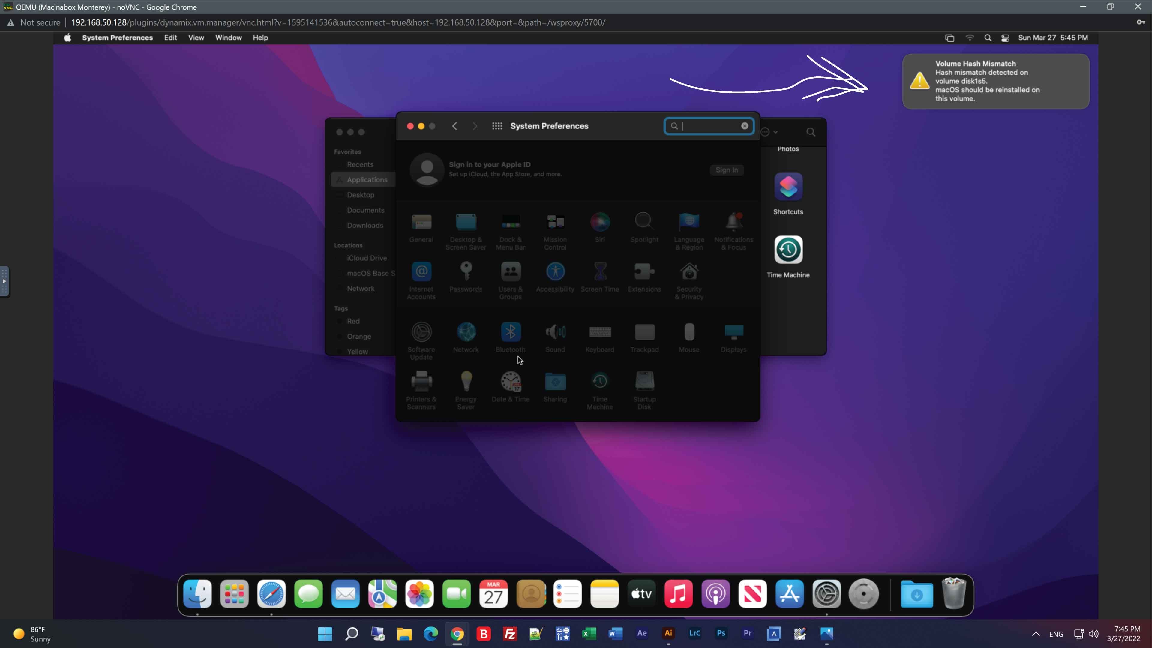

Hi there, i managed to get Monterey with my RX570 working today ! But i have one big problem and i cant find a solution ! Hopefully you can help me.
On VNC - When i Boot the VM i can select the Mac HD and it boots up to the login screen - then i enter my password end i am on the desktop - from this moment i am unable to use mouse or Keyboard in VNC - Mouse stucks in the left upper corner and keyboard do nothing.

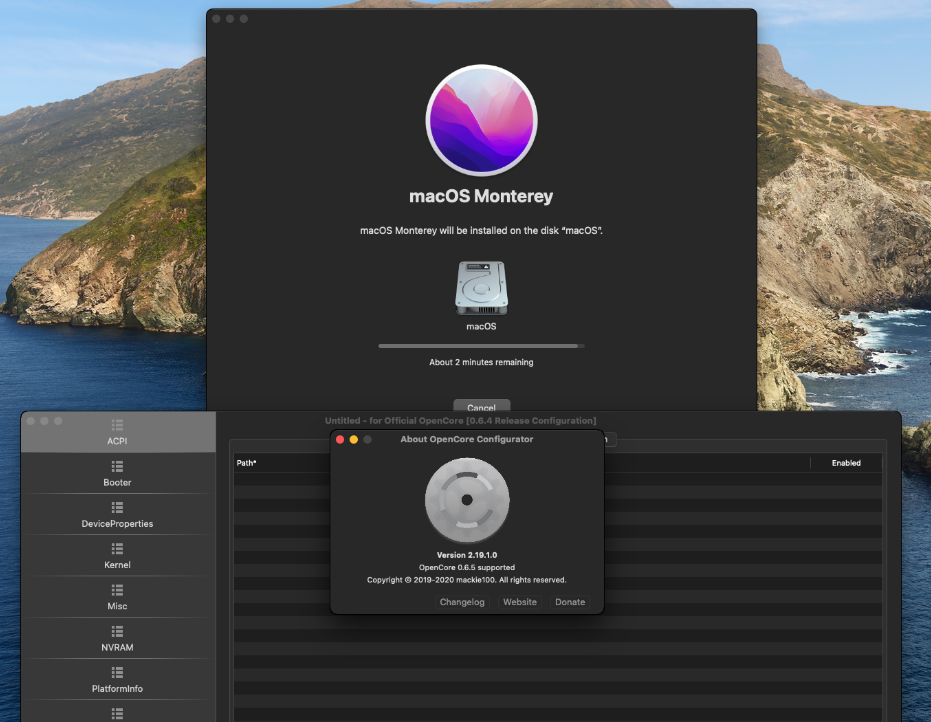

I tried to update to Monterey internally and i got this screen that won't budge. Not sure what may be missing / error. EDIT - I force quit the VM, restarted it and it went about successfully updating to Monterey!
Had a few follow ups:
1. I’m seeing major issues with Chrome running properly. Essentially it doesn’t render similar to issue describe in this thread on reddit. Anyone else have similar rendering issues on Monterey? I don’t have an external GPU plugged in if that matters.
2. Is there a way to reduce the size of the macOS vdisk to actual usage vs. its pre-allocated to 100GB? I noticed my Windows VM is dynamic size (i.e. i set it up as 100G with VirtIO vdisk bus, and it currently takes up 36G as vdisk1.img in Domains) while macOS vdisk is always a flat 100GB. Would make backing up much smaller if it can be dynamic but not sure how to set that up with my existing macOS vdisk
3. just generally, how would i go about updating my opencore to the latest version? I think I installed macinabox Big Sur with opencore 2.19.1.0 as I had issues trying to install with 2.50. Below is the current version I have
Edited by Linguafoeda

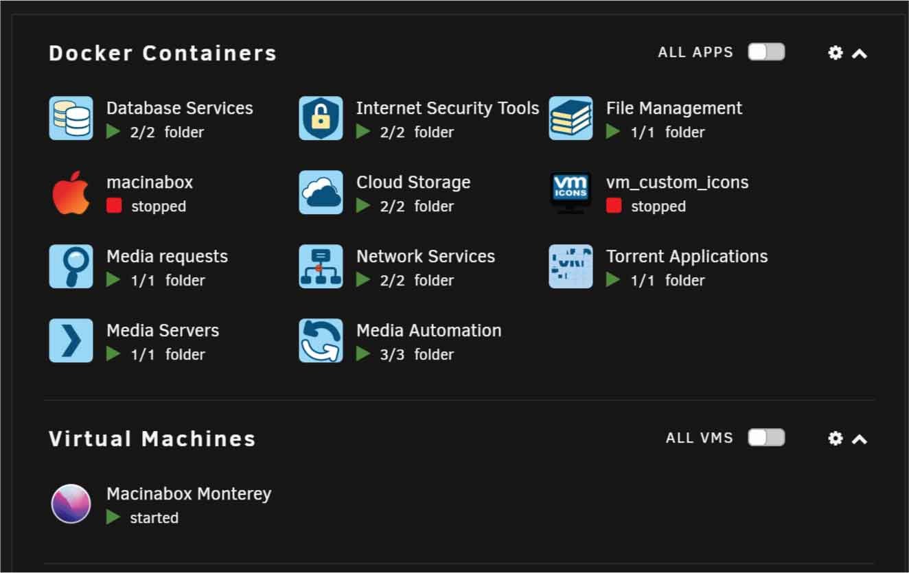

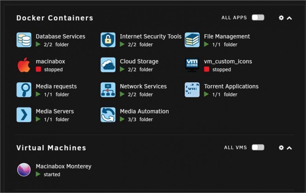

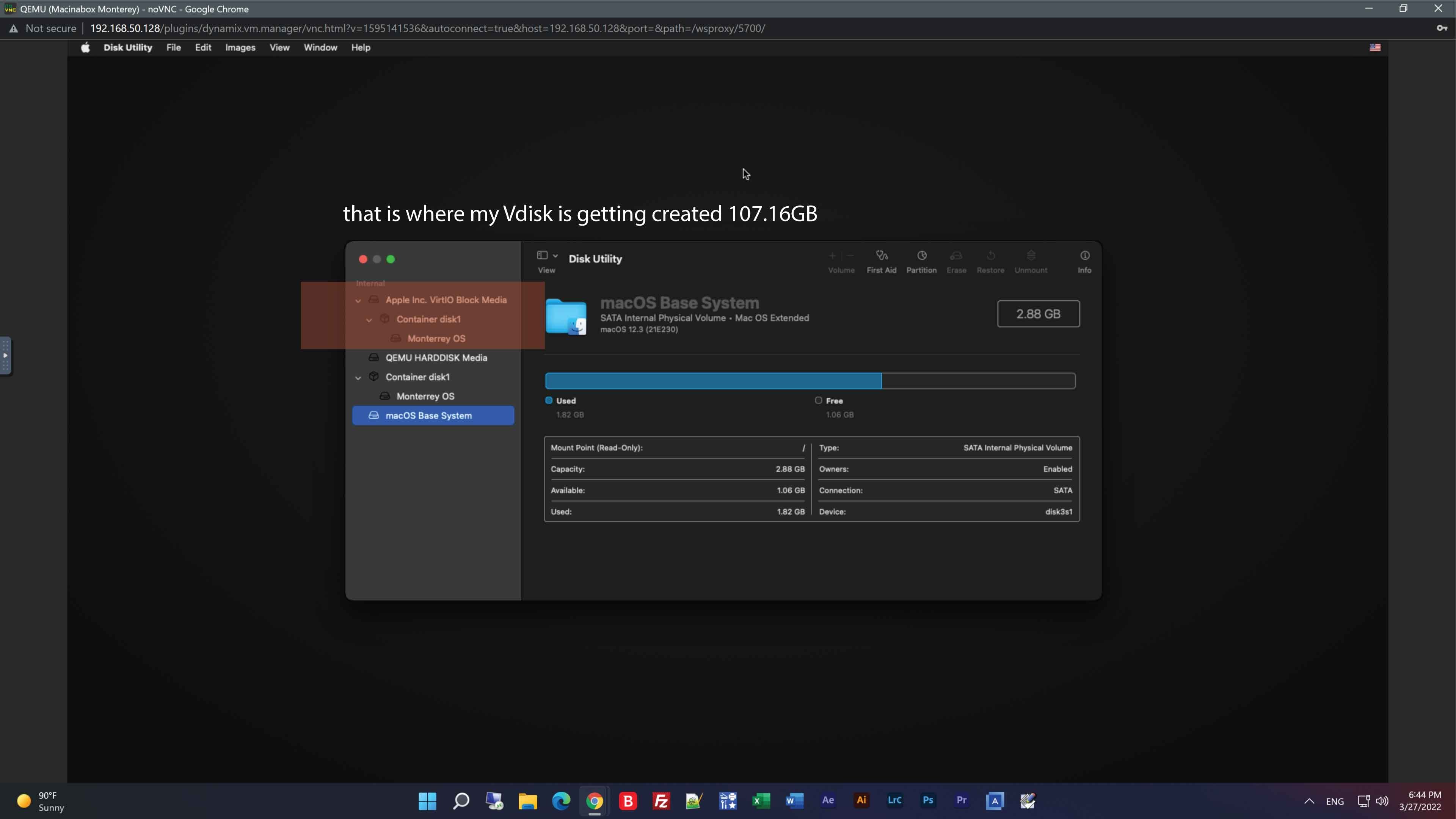

Hello friends I hope you are all doing well.
I am new on unraid and VMs and I'm trying to follow the spaceinvader tutorial to install Mac Os as VM on my unraid server but I'm not getting any success, I already tried 4 times and every time the same think happens.
The first thing is when I go to disk utility to select and format the installation disk it is in another location.disk-utility.thumb.jpg.4d265b29ed71fd04bb312c7f8e5ebd13.jpg
After everything is installed and when I login for the first time this warning appears.
And after following the final steps of the tutorial modifying the macinabox_helper  the VM doesn't boot anymore and I just get this black screen.
I also noticed that every 5 minutes Macinabox and the Icons plugin stop for some reason and I have to manually reset them.macinabox.thumb.jpg.b0ebe5e9e31541a4bbc2702b5fdd245c.jpg
If anyone could help me figure out what is causing this problem and help me install this virtual machine I would be very grateful.
I believe it is something with the Vdisk that is not being created where it should be but I don't know how to modify it.
Thank you all in advance for your attention.
