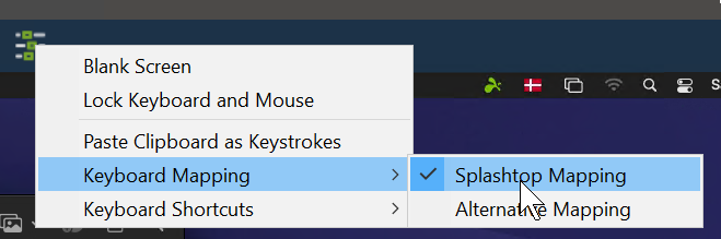

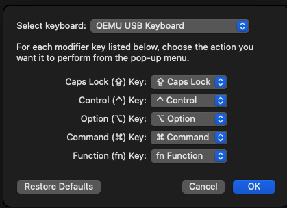

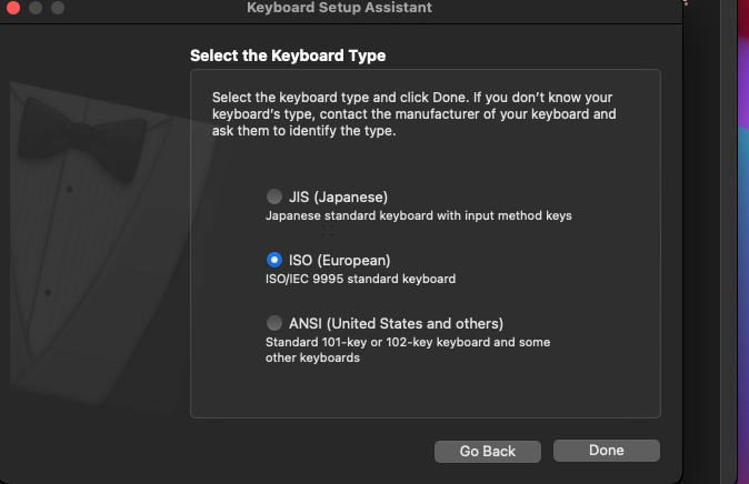

I think I got it working except one thing, and its driving me crazy!
I have the keyboard setup in VM as VNC DK
And in the macinabox I have the:
And I have the mapping:
Also I am using the Splashtop as remote desktop
Tried both options:
How do I get the "@" working the "Alt +2" does not work?
I have read multiple solutions but no one works?
Tried both options:
Tried both options:
Anyone - do you have keyboard layout working remotely as US/UK and are you able to write @ with the "action" + 2
I have tried multiple options and sofar no luck?
Have you VM template as US vnc default? or have you changed it to native country? (If you got this working) 🙂
