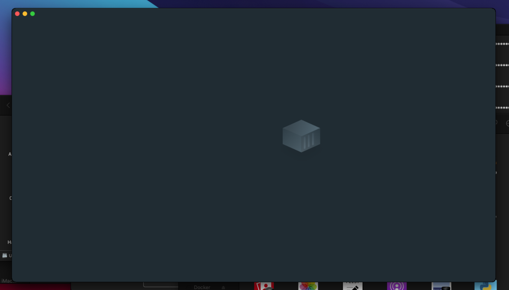

Hey guys!
Has anyone had any luck getting Docker to run within the VM? I' running Big Sur and I've installed Docker, but it tells me I have an incompatible CPU and that I need one virtualisation capabilities and hypervisor support. I tried with a Mac Pro Xeon and Mac Mini i7 base.
You need nested virtualization setup in the host and cpu passthrough for the guest (only intel). You can't emulate penryn.
Edited by ghost82
On 10/2/2022 at 11:32 AM, ghost82 said:
Enable remote access to the mac os vm, just to be sure you only have a black screen but the guest os is booting; if it is booting you need to modify the config.plist of opencore and add a boot-arg so nvidia drivers will be used.
the VM is not booting, I do not get a ping on the IP Adress .....
Thanks for this, got it working. Nested Virtualization was enabled for unraid, I just needed to switch to the host arg instead of Penryn
NOW though, I am having the absolute craziest issue that I can not find help on anywhere. The Docker Desktop UI is all kinds of messed up as in the attached screenshot. It's fully working, I can hover over random sections and find buttons, but nothing is displaying haha. The service runs and everything. Oh why me?
Edited by Avsynthe
Probably related to graphic accelaration. Consider that vnc graphic only doesn't enable it, you need gpu passthrough.
Strangely enough, it works on my Catalina VM, just not on my Big Sur or Monterey VMS, which is where I really need it. Super weird. Neither have GPU passthrough and both run on VNC
all previous versions of Docker Desktop work fine, but not v4 +
Edited by Avsynthe

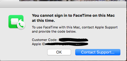

I have a similar problem that I cannot log into iMessage. It will log in and then drop me back to the login screen. I have tried and will continue to try the workarounds with eth0 but they don't seem to work.
I haven't been keeping up with this thread recently but here is a long post I wrote a while back that covers getting iCloud functions working. I used to run a Hackintosh as my main machine and I can confirm that if you setup your VM correctly all functions work 100% including iCloud, iMessage, Handoff, etc.
I had this exact issue. Triple checked that I followed every step correctly and got nowhere. Ended up having to call Apple to "authorize" my account. If you run iMessage through terminal using:
sudo /System/Applications/Messages.app/Contents/MacOS/Messages
You'll get an ID number that you give the customer service rep and they'll basically unlock your account and iMessage will magically work. It took me multiple calls to get someone who knew where to put that number. I mentioned a few times that I believed my account was locked and finally the person figured it out.
Edit: Also, they'll try to get you to let them remote into your Mac. Just say you arent in front of it at the moment or aren't able to for whatever reason. Them remoting in to troubleshoot will get you nowhere.
Edited by razierklinge
This is the case only if you when login you get a popup like this:
Your Apple ID “[email protected]” can’t be used to set up iMessage at this time.
If this is a new Apple ID, you do not need to create another one. To use this Apple ID with iMessage, contact iMessage support with the code below.
Customer Code: XXXX-XXXX-XXXX
It happened to me too and had to call several times apple to get it fixed.
1. First time I gave permission to remote access
2. Second time I sent diagnostics data to apple saved from a software they ask to download and they did not fix it because booting with opencore
1 and 2 made by the same person, took weeks to end with a reply they were not able to fix.
3. Third time a kind man fixed it in 10 seconds
I never hid to apple to use a sort of hackintosh, but...you may have more luck if you don't say it explicitely :D
This happened because 4 years ago, when I started to play with mac os vms, I changed too many times the smbios data and logins were recorded in apple servers: I had too many devices saved in apple server, had to remove all the unused devices and then call apple.
No need to call apple if you don't have a "customer code", issue is somewhere else.
Edited by ghost82

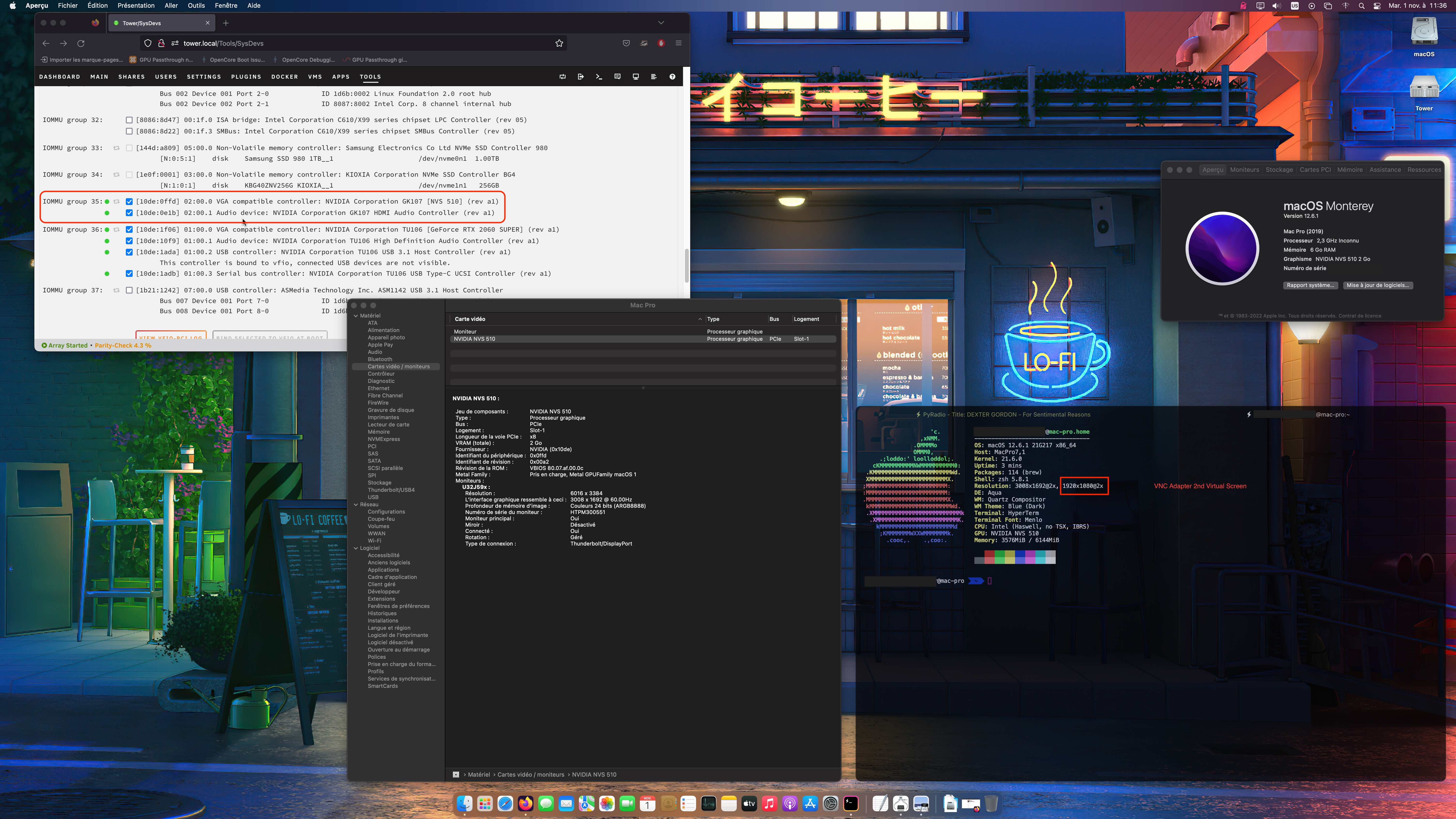

Hello everybody, I’m a new Unraid user I set up a windows 10 Vm with GPU passthrough (NVIDIA RTX2060) that work flawlessly.
So I decided to install a macOS VM with the awesome macinabox docker image, after following the SpaceInvaderOne tutorials
My vm work correctly with sound, network, and graphic passthrough in a manner that drive me nut… !!!
I try to passed through an NVIDIA NVS510 (Kepler GK107) my GPU work but ONLY if I left set the VNC virtual adapter as primary and
The NVS510 as secondary gfx card !!!!
If I set the NVS as primary display (BIOS dumped with SpaceInvaderOne Script) I never see the TianoCore boot screen but only a black Screen (the vm seems to not initialize the GPU).
With the VNC adapter set as primary and the NVS as secondary I can see the TianoCore screen on the monitor attached on the NVS
And on the "VNC side" I can see the open core boot menu, the Apple Logo and progress bar load at 50% and boom the macOS desktop lives on the attached monitor.
This work but macOS see 2 Displays and this is not the most elegant solution….
Otherwise all work I wrote this post on my Monterey vm with graphics from my old but trustworthy NVIDIA NVS510.
If you have clues from what to do, I always dig deep in the unraid forum and tested many suggested workaround but none resolved my issue. I hope that my message was not too "cryptic" as I’m French and English was not my primary language ;-)
Thanks in advance for all, and Have a good day.
Thomas
My XML :
Sorry but this isn't accurate. Like the other person mentioned, I would login to iMessage and get kicked out after a few seconds, no popup would ever happen. But if you run iMessage through the terminal you WILL get a customer code in the log. I called, gave them the info, and on the 2nd call the lady said, "Oh I see where I need to put that code. Try logging in now." And it suddenly worked. So a popup may or may not happen to indicate your account needs to be authorized.

I do not know if this would help you guys who are trying to use Nvidia  GPU on an OS newer than High Sierra, but the below worked for me for each and every release (up to Monterey) the moment I made the change. Before that I always get a black screen, which blocked me from even trying to install  OCLP to get graphic acceleration working with my 1070TI
      <driver name='vfio'/>
      <source>
        <address domain='0x0000' bus='0x0b' slot='0x00' function='0x0'/>
      </source>
      <rom file='/mnt/user/Downloads/Softwares/Galax1070ti.rom'/>
      <address type='pci' domain='0x0000' bus='0x03' slot='0x00' function='0x0'/>
The bolded underlined area was always 0x00 for me all the while, but I noticed that it was 0x03 on my High Sierra by default but 0x00 on anything newer, the moment I changed it, lo and behold, I got the nice, pixelated UI you get when drivers aren't installed :)
OCLP works perfectly after that.
The below was needed too, of course:
How to Enable NVIDIA WebDrivers on macOS Big Sur and Monterey
Edited by ars92
      <source>
      </source>
@ars92 you're the Boss, It Works !!!!
My Nvidia Card works perfectly fine now when changing the bus-id to 0x03.
Many Thanks to you for this trick
