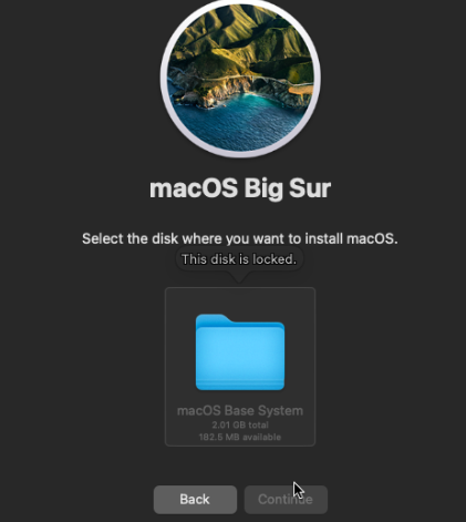

I got the message "The disk is locked" during install OS and then I cant continue.
Any suggestions why and how to unlock the disk?
This might be something simple, but how do you install a second VM with the same IOS?  Can you edit the scripts (helper script and notify script) without affecting current VMs?
You're seeing this because you don't have any formatted partitions to install to (the folder you see is the install media, not a target disk).  Reboot the VM and select "Disk Utility" from the recovery screen.  There you will see multiple disks, including the one you allocated in the Macinabox parameters.  Select that disk, the click the "Erase" button to format it.  Once complete, you can return to the recovery screen and proceed with the install.

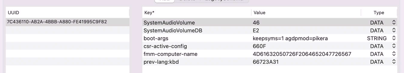

Hello all,
I am trying to pass through my 5700xt to the Monteray vm, but I am keep running into problems.
Whenever I try to pass the GPU, I will see the first screen, I can select the disk drive, the Apple Logo will appear and start loading, most of the times will reach 20-25% and then black screen and nothing happens.
I tried different configurations, from members in the forum, nothing seems to work.
The same GPu works fine in a windows or linux vm.

17 minutes ago, nikos134 said:
My lastest XML.
you missed multifunction for gpu.
Then for proper gpu initialization you need agdpmod=pikera as a boot-arg in opencore config.plist.
Edited by ghost82
It needed to add the agdpmod=pikera ....
I was about to give up.
Thank you for your help

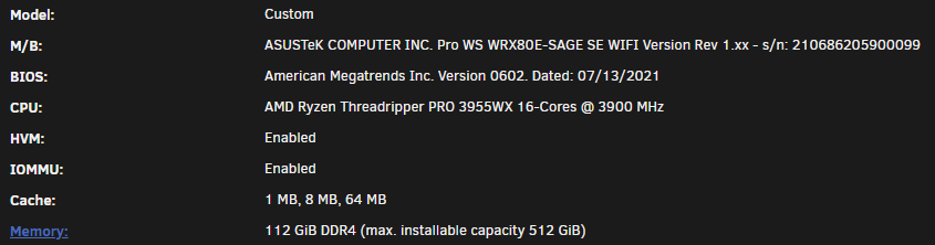

Although I don't think this is particularly the issue, I have attached my info.
Edited by tasmith88
More information

Question about GPU Passthrough ...
after learning that nvidia zere not supported any;ore in monterey, I ordered a Saphire 6600 8gb.
I updated the opencore to last version, passthrough the GPU with its bios, everything works fine with vnc remote, I can see my screen.
But no display on the external monitor. when the VM is booting, iget the apple logo and the progress bar, but then the screen goes black.
I tried copying the whatevergreen and the lilu.ktext from this page https://dortania.github.io/GPU-Buyers-Guide/modern-gpus/amd-gpu.html#native-amd-gpus but result is the same (not sure if Ineed to do more than copying this to the EFI partition)
any ideas ?
11 minutes ago, chocorem said:
any ideas ?
agdpmod=pikera
as a boot arg in opencore config.plist
2 hours ago, ghost82 said:
agdpmod=pikera
even with this mod, i still get a blank screen after the apple logo disapears
