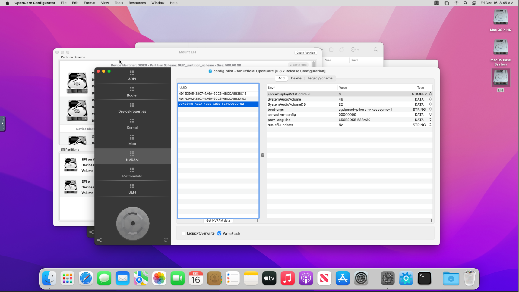

On the Dortania page I read that I have to include the following in the config.plist "radpg=15" (Fixes initialization for HD 7730/7750/7770/R7 250/R7 250X), I did that too, but still no success.
On the Dortania page there is also the following about this AMD HD 7770 card --> InjectAMD: While deprecated, some users require this for proper initialization, avoid unless absolutely necessary,
I didn't understand what is meant by that --> InjectAMD, can anyone comment on it , would be super nice :)
InjectAMD
is a boot-arg you can add into the config.plist, but it's deprecated.
Not all 7770 work in mac os, enable logging to file in opencore config.plist and maybe you will find where/why it hangs.
Check that your gpu has uefi rom, or if you are using a vbios file check that the rom file has the uefi part.
Apply multifunction for gpu in the xml.

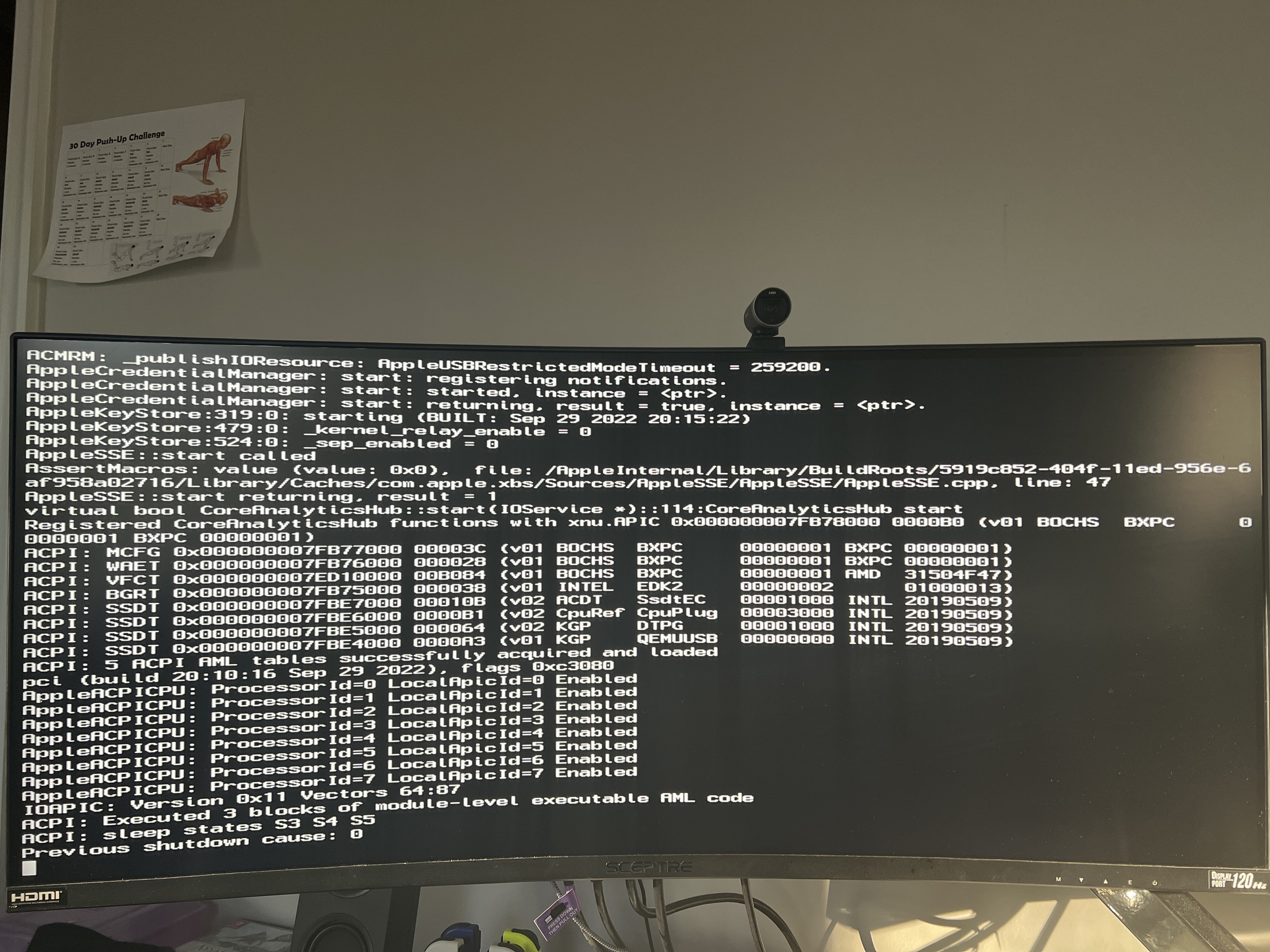

Okay.. after i have add radpg=15 in right place and found another Vbios file (Attached) from TechPowerUP issue solved,
now i can use the XFX Ghost Edition AMD HD 7770 in Monterey :)
thank you verry mutch ghost82 for assist

Appreciate it. One last question. I have the Radeon 6600XT GPU and trying to get the VM to start through there. Any help would be appreciated as it is stuck at the Apple logo and won't load. The boot-args I used was agdpmod=pikera.

Have you been able to get a 6600xt GPU running on the Monterey VM? Every time I try, it isn't connecting. I have tried the boot-args as well. I have the ASUS ROG Strix OC 6600XT GPU and have also used the rom as well. Any help is appreciated.

See the pic. If the rom is right, then I shouldn't have to add it to the VM itself as it should automatically load up correct?
boot-args string is correct it should stay there, even with the right vbios the string must be stay
Try give the gpu to windows vm with the Vbios and test it of works in Windows, try same gpu from other manufactors vbios rom
cYa BUSTER
