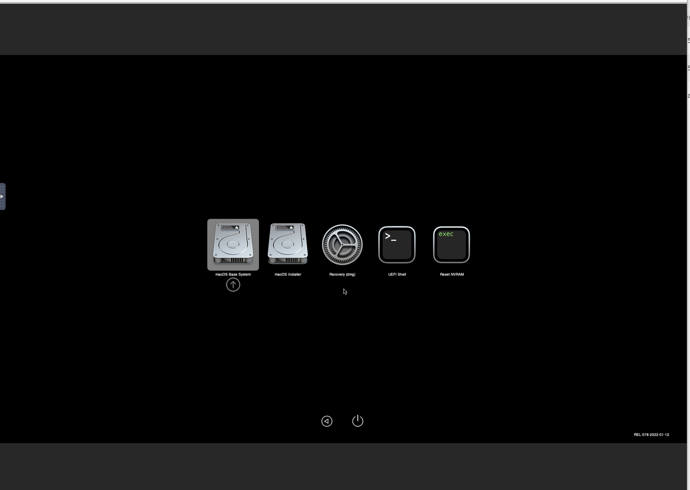

Hey All - I had an old version of macinabox running fine but wanted to upgrade OS systems - removed everything (appdata, domains, and custom_ovm files - but getting this weird state after installing OS (Big Sur or any other) - just goes back to an install window with MacOS Base System, OS Installer or Recovery DMG. Is there something I'm missing here?  If I click on any of those options it just dumps me to the installer again.
Did you try the installer.. usually it carrys on installing then reboots again. I found after then that doing a reset nvram seemed to get it to boot normally.

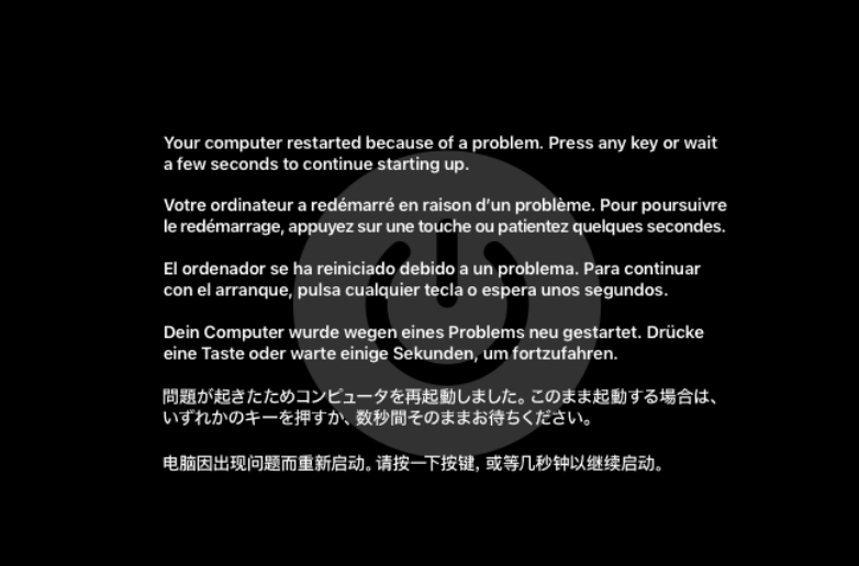

2 hours ago, daddintech said:
Every time I shut the VM down and restart it, I receive the "Your computer was restarted because of a problem."
When you booted again there should be some more data on that window, you should be able to see what crashed.
I appreciate the response!  I have looked at the log, but am very out of practice and barely more educated than a novice with the more technical aspects of macOS.  Would a copy of the log pasted here be helpful or would you (or anyone) be able to guide me through analyzing the log?
I have looked online at some guides regarding examination of these types of logs.  Unfortunately, my log does not give me a suggestions as to the cause at the opening of the log as some of the guides stated may be present.  The opening line is as follows:
panic(cpu 3 caller 0xffffff800f1937e5): ""@/System/Volumes/Data/SWE/macOS/BuildRoots/15c9597e6e/Library/Caches/com.apple.xbs/Sources/xnu/xnu-7195.141.46/osfmk/corecrypto/cc_abort.c:50
The backtrace is somewhat foreign to me, but I do see the mention of USB a fair number of times.  I do not have any USB ports or any hardware, for that matter, being passed through to the VM.
Something else possibly of interest to note in the log is the line:  "Mac OS version:  Not yet set".  This may be nothing and completely normal, but thought I would throw it out there just in case.
Thanks in advance!
Edited by daddintech
mmm I don't know, can you paste the full backtrace?
Once you reboot a window should popup, click on show details and paste all here, it should be something like this:

0xffffffa09333bf50 : 0xffffff800f7c57d6 mach_kernel : __ZN15_IOConfigThread4mainEPvi + 0x186
0xffffffa09333bfa0 : 0xffffff800f02c13e mach_kernel : _call_continuation + 0x2e
      Kernel Extensions in backtrace:
         com.apple.driver.usb.AppleUSBUHCI(1.2)[DC795E3F-2357-3BA9-BDCA-B08D818E521E]@0xffffff8011fdf000->0xffffff8011ff3fff
            dependency: com.apple.driver.usb.AppleUSBCommon(1.0)[B52FCC8A-A083-367C-9DA9-C0567C86E7A5]@0xffffff80108a6000->0xffffff80108a9fff
            dependency: com.apple.driver.usb.AppleUSBEHCI(1.2)[A155A6A5-0D22-3FDC-8CD0-1C998867B83A]@0xffffff8011f2f000->0xffffff8011f6cfff
            dependency: com.apple.iokit.IOUSBHostFamily(1.2)[E9E2979C-5F4F-31F7-80AA-B28B877E9959]@0xffffff8011e8b000->0xffffff8011f19fff
         com.apple.driver.usb.AppleUSBUHCIPCI(1.2)[4F83C93D-A598-345E-B645-77FB367C5D58]@0xffffff8011ff9000->0xffffff8011ffbfff
            dependency: com.apple.driver.usb.AppleUSBUHCI(1.2)[DC795E3F-2357-3BA9-BDCA-B08D818E521E]@0xffffff8011fdf000->0xffffff8011ff3fff
            dependency: com.apple.iokit.IOACPIFamily(1.4)[02870861-1FF3-39CF-85E0-04DC6D1AAE5D]@0xffffff8011645000->0xffffff8011646fff
            dependency: com.apple.iokit.IOPCIFamily(2.9)[3E5DA5CC-56D6-3481-9EA8-4DAAA0551243]@0xffffff8011b6d000->0xffffff8011b95fff
Process name corresponding to current thread: kernel_task
Boot args: keepsyms=1
Mac OS version:
Not yet set
Kernel version:
Darwin Kernel Version 20.6.0: Sun Nov  6 23:17:00 PST 2022; root:xnu-7195.141.46~1/RELEASE_X86_64
Kernel UUID: 68CA2B75-6148-38BC-BC33-38E18B20A8B1
KernelCache slide: 0x000000000ee00000
KernelCache base:  0xffffff800f000000
Kernel slide:      0x000000000ee10000
Kernel text base:  0xffffff800f010000
__HIB  text base: 0xffffff800ef00000
System model name: MacPro6,1 (Mac-F60**********CF6)
System shutdown begun: NO
Panic diags file unavailable, panic occurred prior to initialization
Hibernation exit count: 0
System uptime in nanoseconds: 438860557
Last Sleep:           absolute           base_tsc          base_nano
  Uptime  : 0x000000001a287f27
  Sleep   : 0x0000000000000000 0x0000000000000000 0x0000000000000000
  Wake    : 0x0000000000000000 0x000000041ecfcef0 0x0000000000000000
last started kext at 437378096: >!AFileSystemDriver	3.0.1 (addr 0xffffff801053a000, size 8192)
loaded kexts:
as.acidanthera.BrcmFirmwareStore	2.6.2
as.vit9696.!AALC	1.6.9
as.vit9696.WhateverGreen	1.5.7
as.vit9696.Lilu	1.6.0
@filesystems.tmpfs	1
>!AAHCIPort	346.100.2
@filesystems.hfs.kext	556.100.12
@BootCache	40
@!AFSCompression.!AFSCompressionTypeZlib	1.0.0
@!AFSCompression.!AFSCompressionTypeDataless	1.0.0d1
@private.KextAudit	1.0
>!AACPIButtons	6.1
>!ARTC	2.0
>!ASMBIOS	2.1
>!AAPIC	1.7
@!ASystemPolicy	2.0.0
@nke.applicationfirewall	311
|IOKitRegistryCompatibility	1
|EndpointSecurity	1
>!ABSDKextStarter	3
|IOSurface	290.8.1
|IOSkywalk!F	1
>mDNSOffloadUserClient	1.0.1b8
|IOAHCI!F	294.100.1
>usb.!UUHCIPCI	1.2
>usb.!UUHCI	1.2
>usb.!UEHCIPCI	1.2
>usb.!UEHCI	1.2
>!AVirtIO	74.120.4
|IOSerial!F	11
@filesystems.hfs.encodings.kext	1
>usb.!UHostPacketFilter	1.0
|IOUSB!F	900.4.2
>!AEFINVRAM	2.1
>!AEFIRuntime	2.1
|IOHID!F	2.0.0
$!AImage4	3.0.0
|IOTimeSync!F	985.2
|IONetworking!F	3.4
>DiskImages	493.0.0
|IO!B!F	8.0.5d7
|IOReport!F	47
|IO!BPacketLogger	8.0.5d7
$quarantine	4
$sandbox	300.0
@kext.!AMatch	1.0.0d1
|CoreAnalytics!F	1
>!ASSE	1.0
>!AKeyStore	2
>!UTDM	511.141.1
|IOUSBMass!SDriver	184.140.2
|IOSCSIBlockCommandsDevice	436.140.1
|IO!S!F	2.1
|IOSCSIArchitectureModel!F	436.140.1
>!AMobileFileIntegrity	1.0.5
@kext.CoreTrust	1
>!AFDEKeyStore	28.30
>!AEffaceable!S	1.0
>!ACredentialManager	1.0
>KernelRelayHost	1
|IOUSBHost!F	1.2
>!UHostMergeProperties	1.2
>usb.!UCommon	1.0
>!ABusPower!C	1.0
>!ASEPManager	1.0.1
>IOSlaveProcessor	1
>!AACPIPlatform	6.1
>!ASMC	3.1.9
|IOPCI!F	2.9
|IOACPI!F	1.4
>watchdog	1
@kec.pthread	1
@kec.corecrypto	11.1
@kec.Libm	1

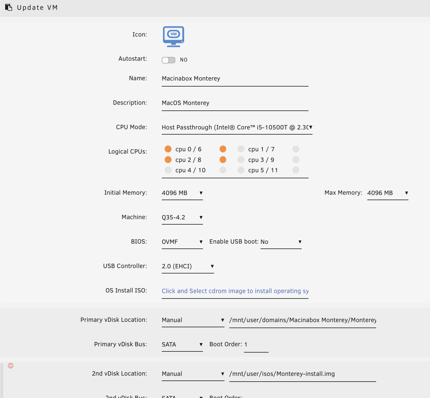

Hi guys,
I looked the video from the first post and did the same steps.
I didn't change anything except the logical CPUs.
Unfortunately I always get a reboot.
Do you have a hint for me where my fault is?
Thank you.
On 1/28/2023 at 8:37 AM, Thomas_H said:
Hi guys,
Thank you.
did you rerun the macinabox script after changing the VM definition with your new logical cores?
Yes, I did.
I also tried to remove everything and start from scratch.
But it is the same issue.
Here's my xml, perhaps it could be an indicator what I'm doing wrong.
<domain type='kvm' id='6' xmlns:qemu='http://libvirt.org/schemas/domain/qemu/1.0'>
  <name>Macinabox Monterey</name>
  <uuid>e8b63d07-9f76-4af8-a93c-329c95d5a582</uuid>
  <description>MacOS Monterey</description>
  <metadata>
    <vmtemplate xmlns="unraid" name="Windows 10" icon="default.png" os="osx"/>
  </metadata>
  <memory unit='KiB'>4194304</memory>
  <currentMemory unit='KiB'>4194304</currentMemory>
  <memoryBacking>
    <nosharepages/>
  </memoryBacking>
  <vcpu placement='static'>4</vcpu>
  <cputune>
    <vcpupin vcpu='0' cpuset='2'/>
    <vcpupin vcpu='1' cpuset='8'/>
    <vcpupin vcpu='2' cpuset='4'/>
    <vcpupin vcpu='3' cpuset='10'/>
  </cputune>
  <resource>
  </resource>
  <os>
    <type arch='x86_64' machine='pc-q35-4.2'>hvm</type>
    <loader readonly='yes' type='pflash'>/mnt/user/system/custom_ovmf/Macinabox_CODE-pure-efi.fd</loader>
    <nvram>/etc/libvirt/qemu/nvram/e8b63d07-9f76-4af8-a93c-329c95d5a582_VARS-pure-efi.fd</nvram>
  </os>
  <features>
    <acpi/>
    <apic/>
  </features>
    <topology sockets='1' dies='1' cores='2' threads='2'/>
    <cache mode='passthrough'/>
  </cpu>
  <clock offset='utc'>
    <timer name='rtc' tickpolicy='catchup'/>
    <timer name='pit' tickpolicy='delay'/>
  </clock>
  <on_crash>restart</on_crash>
  <devices>
      <source file='/mnt/user/domains/Macinabox Monterey/Monterey-opencore.img' index='3'/>
      <backingStore/>
      <target dev='hdc' bus='sata'/>
      <boot order='1'/>
      <alias name='sata0-0-2'/>
      <address type='drive' controller='0' bus='0' target='0' unit='2'/>
    </disk>
      <source file='/mnt/user/isos/Monterey-install.img' index='2'/>
      <backingStore/>
      <target dev='hdd' bus='sata'/>
      <alias name='sata0-0-3'/>
      <address type='drive' controller='0' bus='0' target='0' unit='3'/>
    </disk>
      <source file='/mnt/user/domains/Macinabox Monterey/macos_disk.img' index='1'/>
      <backingStore/>
      <target dev='hde' bus='virtio'/>
      <alias name='virtio-disk4'/>
      <address type='pci' domain='0x0000' bus='0x03' slot='0x00' function='0x0'/>
    </disk>
      <alias name='usb'/>
    </controller>
      <alias name='usb'/>
      <master startport='0'/>
    </controller>
      <alias name='usb'/>
      <master startport='2'/>
    </controller>
      <alias name='usb'/>
      <master startport='4'/>
    </controller>
    <controller type='pci' index='0' model='pcie-root'>
      <alias name='pcie.0'/>
    </controller>
    <controller type='pci' index='1' model='pcie-root-port'>
      <model name='pcie-root-port'/>
      <target chassis='1' port='0x10'/>
      <alias name='pci.1'/>
      <address type='pci' domain='0x0000' bus='0x00' slot='0x02' function='0x0' multifunction='on'/>
    </controller>
    <controller type='pci' index='2' model='pcie-root-port'>
      <target chassis='2' port='0x11'/>
      <alias name='pci.2'/>
      <address type='pci' domain='0x0000' bus='0x00' slot='0x02' function='0x1'/>
    </controller>
    <controller type='pci' index='3' model='pcie-root-port'>
      <target chassis='3' port='0x12'/>
      <alias name='pci.3'/>
      <address type='pci' domain='0x0000' bus='0x00' slot='0x02' function='0x2'/>
    </controller>
    <controller type='pci' index='4' model='pcie-root-port'>
      <target chassis='4' port='0x13'/>
      <alias name='pci.4'/>
      <address type='pci' domain='0x0000' bus='0x00' slot='0x02' function='0x3'/>
    </controller>
      <alias name='virtio-serial0'/>
      <address type='pci' domain='0x0000' bus='0x02' slot='0x00' function='0x0'/>
    </controller>
      <alias name='ide'/>
      <address type='pci' domain='0x0000' bus='0x00' slot='0x1f' function='0x2'/>
    </controller>
    <interface type='bridge'>
      <mac address='52:54:00:d4:ec:ed'/>
      <source bridge='br0'/>
      <target dev='vnet5'/>
      <model type='virtio'/>
      <alias name='net0'/>
      <address type='pci' domain='0x0000' bus='0x01' slot='0x00' function='0x0'/>
    </interface>
    <serial type='pty'>
      <source path='/dev/pts/3'/>
        <model name='isa-serial'/>
      </target>
      <alias name='serial0'/>
    </serial>
    <console type='pty' tty='/dev/pts/3'>
    </console>
    <channel type='unix'>
      <source mode='bind' path='/var/lib/libvirt/qemu/channel/target/domain-6-Macinabox Monterey/org.qemu.guest_agent.0'/>
      <target type='virtio' name='org.qemu.guest_agent.0' state='disconnected'/>
      <alias name='channel0'/>
    </channel>
      <alias name='input0'/>
    </input>
    <input type='mouse' bus='ps2'>
      <alias name='input1'/>
    </input>
    <input type='keyboard' bus='ps2'>
      <alias name='input2'/>
    </input>
    <graphics type='vnc' port='5903' autoport='yes' websocket='5703' listen='0.0.0.0' keymap='de'>
    </graphics>
    <audio id='1' type='none'/>
    <video>
      <alias name='video0'/>
      <address type='pci' domain='0x0000' bus='0x00' slot='0x01' function='0x0'/>
    </video>
    <memballoon model='virtio'>
      <alias name='balloon0'/>
      <address type='pci' domain='0x0000' bus='0x04' slot='0x00' function='0x0'/>
    </memballoon>
  </devices>
  <seclabel type='dynamic' model='dac' relabel='yes'>
    <label>+0:+100</label>
    <imagelabel>+0:+100</imagelabel>
  </seclabel>
  <qemu:commandline>
    <qemu:arg value='-usb'/>
    <qemu:arg value='-device'/>
    <qemu:arg value='usb-kbd,bus=usb-bus.0'/>
    <qemu:arg value='************************'/>
    <qemu:arg value='-smbios'/>
    <qemu:arg value='type=2'/>
    <qemu:arg value='-cpu'/>
    <qemu:arg value='Penryn,kvm=on,vendor=GenuineIntel,+kvm_pv_unhalt,+kvm_pv_eoi,+hypervisor,+invtsc,+pcid,+ssse3,+sse4.2,+popcnt,+avx,+avx2,+aes,+fma,+fma4,+bmi1,+bmi2,+xsave,+xsaveopt,+rdrand,check'/>
  </qemu:commandline>
</domain>

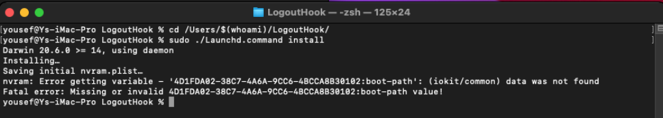

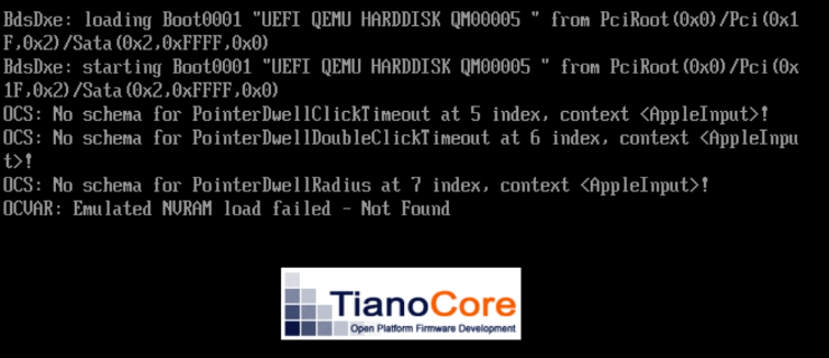

Hello has anyone gotten iservices to work using macinabox?
I am able to install and boot BigSur properly.
However, I am unable to log imessage.
I've followed this guide: https://dortania.github.io/OpenCore-Post-Install/universal/iservices.html#using-gensmbios
I'm using a macmini8,1 smbios and generated a new serial (validated does not match an existing mac)
I've updated my eth MAC to match an apple network card (updated opencore plist ROM values as well)
Confirmed my en0 shows as builtin using hackintool
The one thing I cant get to work is my nvram, setting a varable will not persist after a reboot.
Host machine is i7-8700K in a ROG STRIX Z370-E
To resolve I've tried
an emulated NVRAM: https://dortania.github.io/OpenCore-Post-Install/misc/nvram.html
But when I run the logouthook script I get this error:
And on boot I get this Emulated NVRAM load failed error
Then I went back to try to fix the virtual "real" nvram with this guide, which still didnt solve my problem
https://dortania.github.io/Getting-Started-With-ACPI/Universal/nvram.html
https://elitemacx86.com/threads/how-to-enable-nvram-clover-opencore.577/
I've been at this for many many hours any help is appreciated.

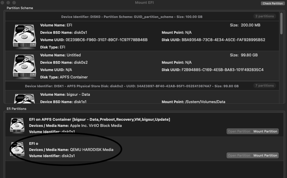

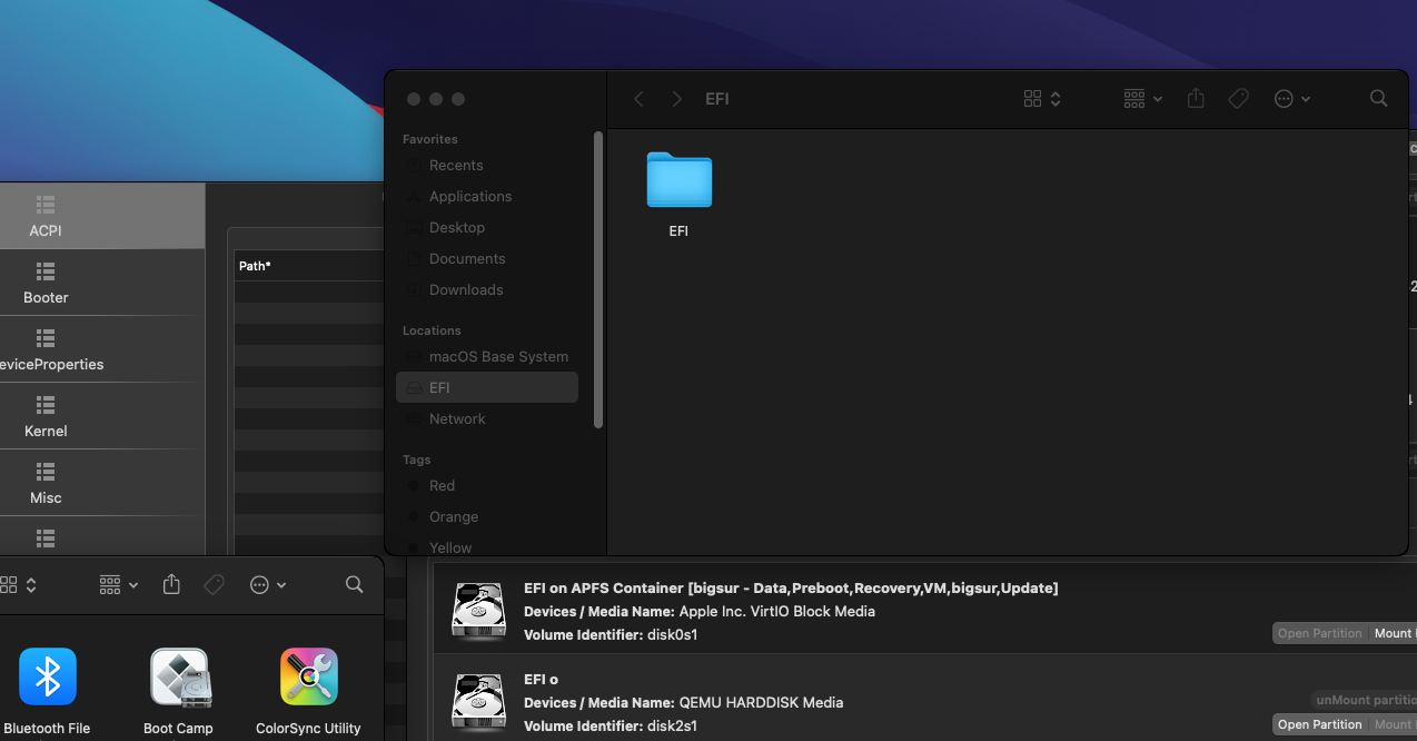

I had some problems near the end of this install, with Open Configurator. I got an error message when I ran the program:

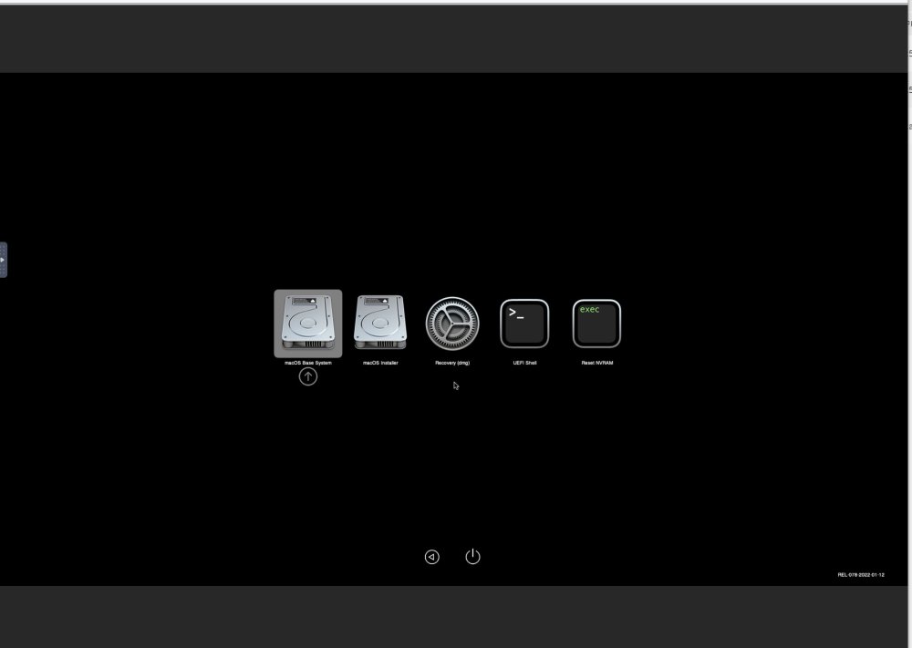

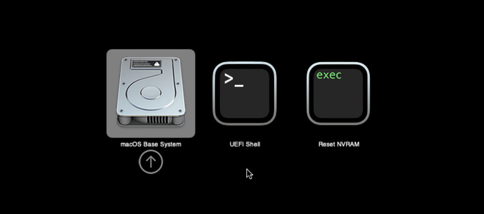

When  i start the VM, it starts as the apple logo, loads half way then it reboots itself, like in a loop!
eDit: it loads up to option menu where it shows macos base system, uefi and reset nvram. I press on macos base system, it loads a quarter way then errors out and resets to the option menu again!
Edit2: logs of VM shows 2023-02-10T10:14:53.445182Z qemu-system-x86_64: warning: host doesn't support requested feature: CPUID.80000001H:ECX.fma4 [bit 16]
Edited by aymanibousi
Yeah it's surprisingly small, but same here and worked fine. Seems to be a CPU compatibility issue?
Any ideas how to fix. I have an i7 8700k CPU.
