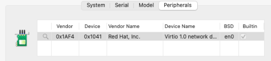

Mac address change is not a must, but recommended.
En0 must be built-in.

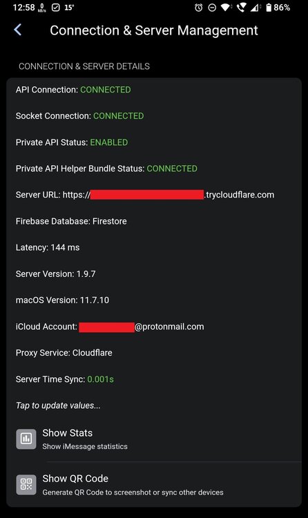

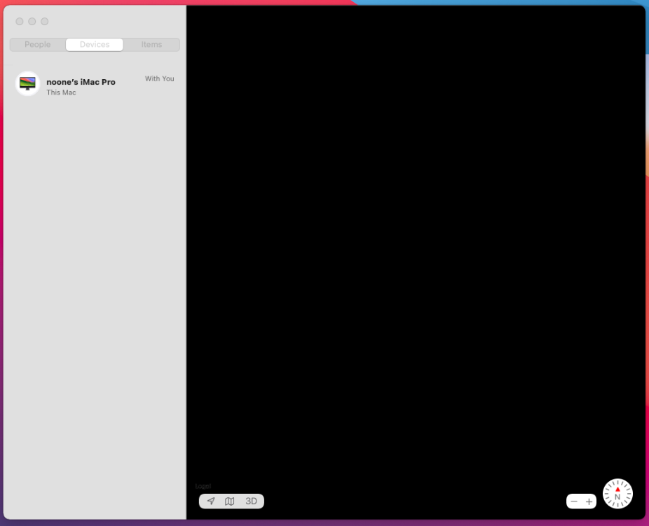

Ugh, I spoke too soon. For some reason FindMy isn't working at all and messages aren't being sent via iMessage...
I won't even load the map. It's just totally black. Nothing seems to be being blocked.
When I open it, it complains that because it cannot connect to WiFi, it can't get my location. I am connected via Ethernet...
I don't have any WiFi networks displayed in the list. But the WiFi icon is constantly refreshing and flashing over and over.
I'm connected via the following in Unraid:
Do you have any idea @ghost82? I've allowed all permissions and done everything I can think.
It's not letting me send anything directly via iMessage either. Just getting "Not Delivered" for everything.
As far as the location map: my though is that the black screen could be because of gpu rendering requirement: are you connecting via vnc?This could explain the black screen.

And also does your en0 connection is seen as built-in?Check in ioreg explorer or with hackintool
See following image, both en0 and en1 builtin:

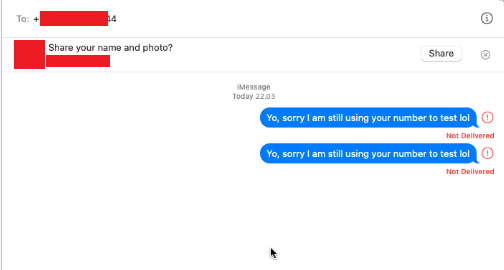

I never had FindMy working on the Mac VM; it is also totally black.  I don't think it matters as long as it is possible to log in without issues.

I've tried both with the private API enabled and with it disabled.
I can't send a message to anyone. It just keeps saying "Not delivered" and I'm not getting any error code either to debug. I even tried opening iMessage via the Terminal and it says: "isBlocked: 0", "isApproved: 1" and "isSpam: NO" so I assume my account is fine.

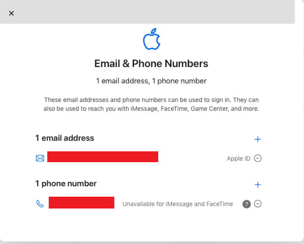

The only thing is that my phone number isn't in the place where it says "You can be reached for messages at:" there is just my Apple ID email. I have added my phone number to my account though and I am actually even logged in with my phone number. Though only my email shows up as an option with the "Start new conversations from:".
Checking Apple support docs it shows the only way to enable it with my phone number is through the iMessage app on an iPhone...

When I try to send a text via BlueBubbles app it just gives me the popup on Mac "Message not delivered". So it definitely feels like being blocked STILL on Apple's side...
I'm trying to text two different people who I know have iMessage. Both of them tried texting me and I just got a normal SMS. Both said that my bubble is only green, not blue. So I don't have iMessage according to them.

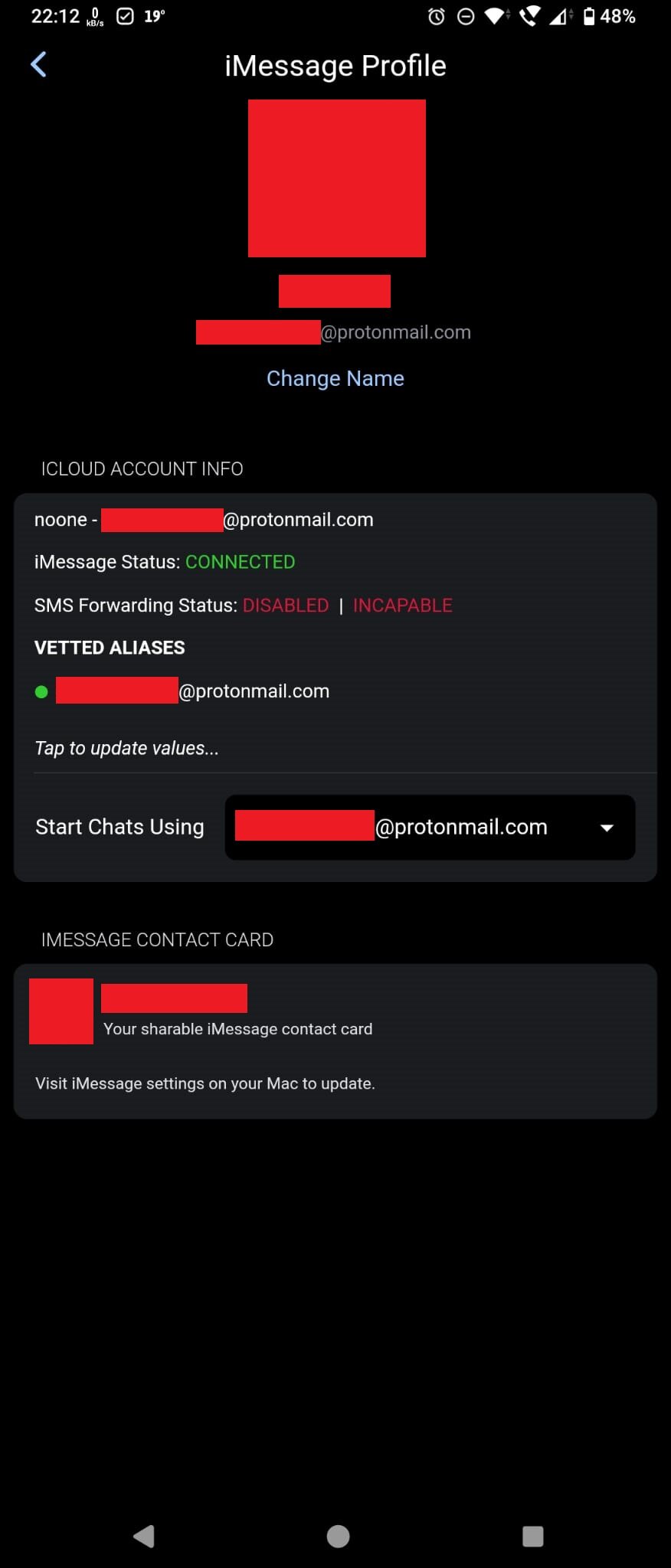

You can only use your appleid email to communicate with imessage or bluebubbles with other imessage accounts.  You cannot use your phone number unless it is registered with an iPhone, and there are some workarounds that will let you stay on a non-apple phone to keep it registered, but that's not what we are doing here.
So yes, the only way to reach you in imessage is the email address showing in the preferences, they cannot message you through your number, it will just show up as a regular text to you.  They need to send an imessage to your email account for it to work.  And when it is sent from you, it's coming from your email and not your phone number.  I hope that is clear in case there was any confusion why your contacts were sending it to your phone number instead.
Your phone number associated with your account will only be for verification codes and does not connect to imessage on the VM.  I think this is difficult because you don't have a second device to test this with, but it sounds like the imessage is working for you.
See if you can send a test message to yourself at your applid email from the imessage account.  If you do not see any delivery errors, then I am sure the imessage is working properly.
AAAAAAAAAAHHHHH well there you go
Funny, because as you were writing that. I tried just messaging myself LOL at my own email and it worked. I sent a "test" and got a "test" back immediately.
BUT.
Does this mean I can't message eg. my sister at her phone number that she has registered with iMessage? If that's the case, I just wasted 2 weeks of my life trying to set this up LMAO. I need to be able to actually message people at their phone number (even if they have to message me at my email)... If I can only do that to their email addresses then this isn't much of a solution at all. It requires me I guess asking every one of my family members their email or something?
When I search for my family members who I know have iMessage or even my work colleagues. Their names are always red in iMessage on the mac and I can't actually even press enter to send them anything.
When I try messaging their phone number from BlueBubbles app I get "Error (22): The recipient isn't registered with iMessage" but they absolutely are with that number.

As far as findmy and the black screen I'm quite sure it depends on gpu rendering.
On my vm everything is fine (I'm on Monterey and cannot upgrade because of my cpus), I'm passing through a 6900xt gpu and enabled unfairgva in opencore because also TV app showed a black screen. Now everything is fine.

I use bluebubbles with family and friends and nobody has any issue having conversations with me using my appleID instead of my phone number.  Once you have a starter conversation, they just need to message back and forth with you in that message instead of your phone number.  It will work for group messages too, as long as everyone is imessage/iphone user.
To be clear, you can message anyone at their imessage phone number or appleID, you cannot message non-apple phone numbers from your appleID imessage account.  This is strictly to communicate with apple people in their walled garden of imessage.  It should work for you with that understanding, so if it is still an issue and you are getting red delivery errors, then I may have exceeded my abilities to help you:)

If I use BlueBubbles app and put in the phone number of someone I know has iMessage. It changes immediately to SMS Forwarding so it seems something still doesn't work. The iMessage tab on the app (next to SMS Forwarding) doesn't show anyone with iMessage.

Yeah doesn't seem to work for me at all.
Messaging any number which I know has iMessage: Doesn't work
Someone messaging my AppleID email: Doesn't work
Me messaging myself at my AppleID email: Only thing that works

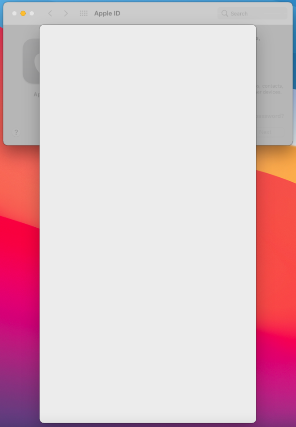

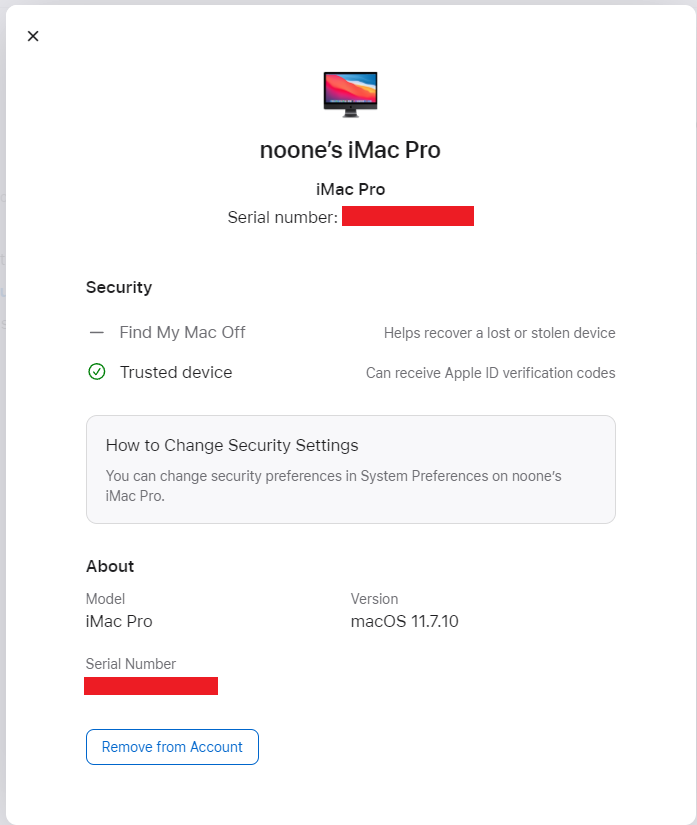

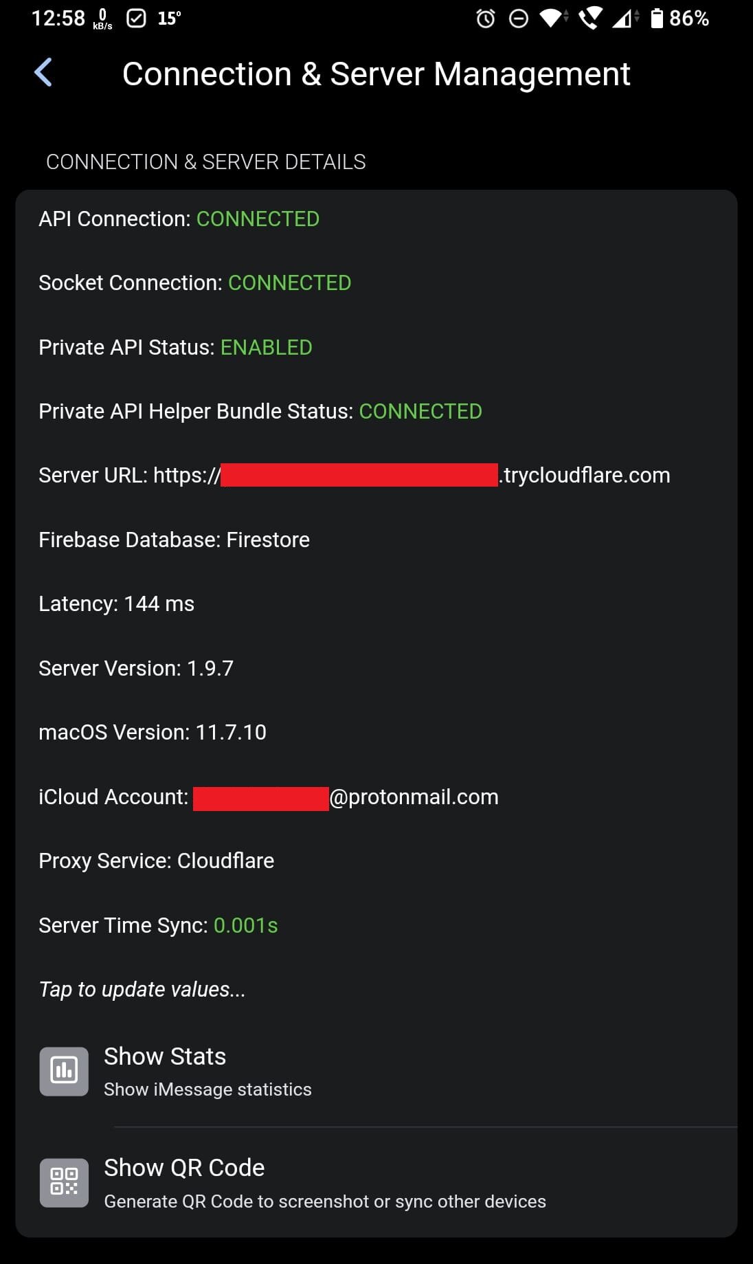

So after restarting the VM and relogging again a few hours later. A few things changed again...
This time when I search for any number it is now no longer red, but blue, until I send a message after which it goes black. Even for contacts that I know don't have iMessage (it shows blue)... Talk about inconsistent.
Obviously the message sending still fails.
Furthermore, I have green across the board for everything on the BlueBubbles app. It correctly detects my iMessage account too and the Private API and everything else.
WhatsAppImage2024-05-15at22_13.19_59fc0bc7.thumb.jpg.70ddda8bcfe42448901e1a477abc4bad.jpg
WhatsAppImage2024-05-15at22_13.19_61e9d2d3.thumb.jpg.7a4155ff2318338be2812fdbdaac3e4a.jpg
As mentioned, I can't start a chat with my phone number because I've never had an iPhone to activate iMessage on.
The lady from Apple support asked me if I had "activated" iMessage but I have no idea what she means and then she just changed the subject. I can also see the map (just not in FindMy). It works fine in the maps app, and when I try to log in on my Windows device, my Mac pops up with a map showing the location a login is coming from.
My Mac is verified on appleid.apple.com
Find My Mac doesn't work because I don't have a Wifi network on the VM. I am using virtual ethernet.

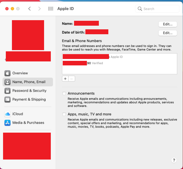

Country and Region is correct. Name, Date of Birth, Email, Phone Number on my account are all correct.
Password was very recently reset.
I am only blocking TWO Apple domains using Nextdns.io
I even whitelisted this domain because I wasn't sure if it was necessary because it's an SDK domain that was caught in one blocklist:
Every single other domain is unblocked.
Networking is set up via basic DHCP which should be no problem:
Hackintool shows my en0 device to be built-in also:
VM shows my phone number is verified:
Edited by plantsandbinary
If the bluebubbles is showing imessage connected and all the services are green, it sounds like you are setup on apple's and bluebubble's side for this to work.  It seems like something is wrong in the VM configuration or something else causing the messages not to work.  I don't think it's a DNS issue because the test message wouldn't work.

So I signed out of everything again. Including disassociating my Mac and signing out of AppleID.
Rebooted the Mac. Went to sign in to Apple ID again.

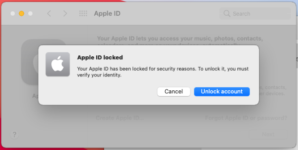

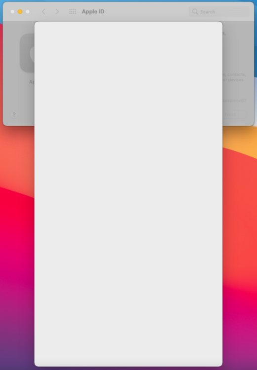

aaaand they locked my account...
Even worse, because of the GPU rendering issue or whatever. I can't even see what it wants me to do to unlock it.
I don't even have a way to quit the process.
I've been an IT engineer for more than 15 years and I've never fought like this with anything LOL.

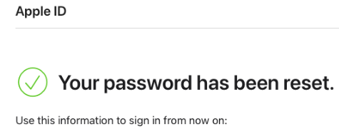

Managed to reset my password using Safari without having to face the previous dreaded "We can't send an SMS to this number at this time" issue I had for the last 2 weeks:

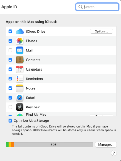

I also noticed that iMessages doesn't appear in System Preferences > Apple ID, as an app using iCloud: image.png.efeb42f7d522fe330d461a8aee5a80e2.png
