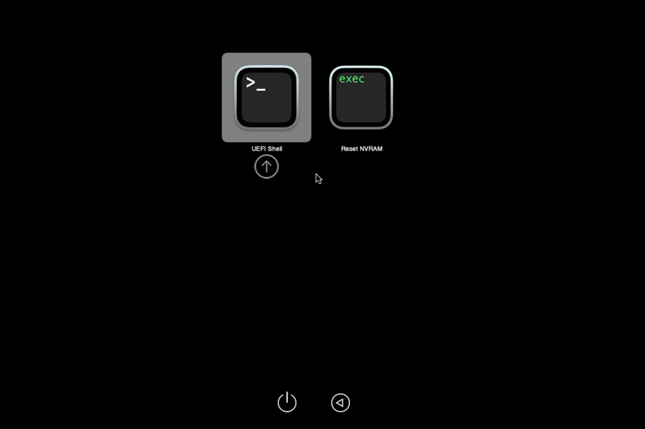

I successfully boot into bootloader, but installer disappears. how can I fix it, or is there a way to roll back to the old macinabox. Thanks!
the installer disappears after installing. you sure you can't just boot from the normal macOS Base System disk now? It probably reboots a couple of times before finally going to the login window
Edited by RezzZ
I haven’t even started installing it yet; this is just the boot screen when the VM first starts. I’ve tried all versions of the VM, restarted the server, and even reinstalled Macinabox, but none of it helped.
Edited by winglam
7 minutes ago, winglam said:
I didn't even start installing it yet; this is a boot screen of VM first starts.
okay... the first screen you should get is the recovery window of macos. If I recall this correctly, the vm is supposed to download recovery. Is the VM connected to the internet?
Yes, the server has internet access, and the installers are downloaded & located in the default ISOS folder.

nothing wrong with my internet. I can't start any kind of installation because the bootloader doesn't load/ see any ISO. as you see in the picture, there is no option to start any installation.

On 10/6/2024 at 2:13 PM, blacklight said:
What am I doing wrong if I don't see the macOS image ? I basically went through the new spaceinvaderone tutorial step by step but in my case the image is not displayed. Only difference I have: the ISOs and the images are on a share of my NAS, but the rest is pretty much the same ... I am out of ideas :(
same here, the new macinabox is broken. I tried resetting libvirt.img or custom_ovmf, reinstalling machinabox, downgrading opencore, none of these solve the problem. I am now stuck at this boot screen forever, I don't know what else I can do.
Edited by winglam
I just installed a new Ventura VM. I get the same screen. Starting the macOS Base System (which is selected) gets me into recovery mode. from there I can the start disk utility app where I need to format the uninitialized 100gb disk. What happens if you start the macOS Base System disk?
I asume you don't do anything special when creating the macinabox docker image, but can you share the logs of the container when it has run, and the settings you used for the docker container?
Also, can you provide more details like, unraid version, hardware of your server.
I'm running macos smoothly on unraid 6.12.13, ASRock B660M Steel Legend and a 12th Gen Intel® Core™ i5-12400.
Instead of installing on a vdisk, how do I install onto a physical drive that I passthrough? I can't seem to get it to create the VM without also creating a vdisk.
It kept going into a boot loop when I selected the macOS Base System disk, so I ended up reinstalling my Unraid server from a backup. The installer was still missing, but the installation finally started when I chose the 'macOS Base System disk.' It was strange, but it worked! It's finally up and running!
My solution was to reinstall Unraid and then simply ignore the missing 'MacOS Installer' icon by selecting the 'macOS Base System disk' for the OS installation. I’ve tested it on both Sonoma and Monterey through VNC, and everything works perfectly!
What Unraid version are you on 7.x beta ? I am on 6.12.13. Maybe it only works reliably for all VMs on the beta ... but I saw a few in this post who are on the same version and proceeded further into the installation process. I only changed the location because my Unraid pool is very small (500Gb). I am using a Truenas vm with an NFS share: no problems with hosting Winbdows 10, Ubuntu and freebsd from a external nfs share. Maybe mac doesn't like it ?
I am on 6.12.13.
wow drastic solution but happy for you that it works now :)
