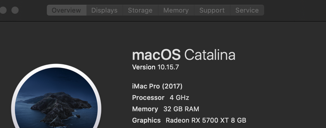

Hmm interesting post!  That is the ONLY thing that is different on my XML which just would not work when trying to pass through a 5700XT.
You have me thinking now, so I am gonna swap out the 2080ti (again!) and put the 5700XT in and give it another go!!
I'll use OC, still got my EFI folders which I was messing about with.
I wonder...... :)
I wonder...... :)

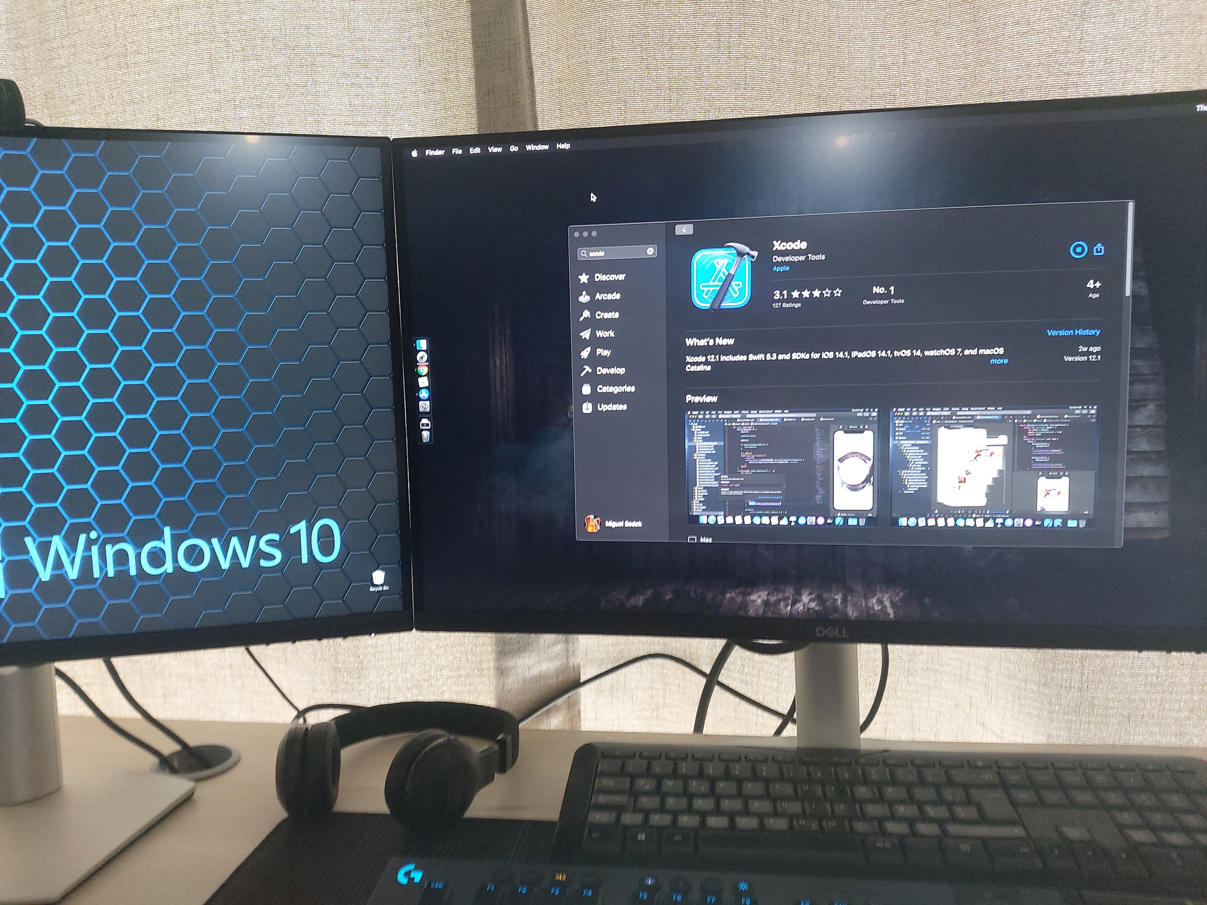

I have just received My 2x retina 27 inch monitors from dell and I am breathless.. macos wont perform any good or look Better in any apple hardware in existance today
Im running side by side macos on My 5700xt and windows 10 on My 3080 could not be happier
Edited by mSedek

Tried again yesterday, absolutely no way this GPU will pass through.  Everything is perfect (with Clover or Opencore) as soon as the GPU is passed through. Stuck.
