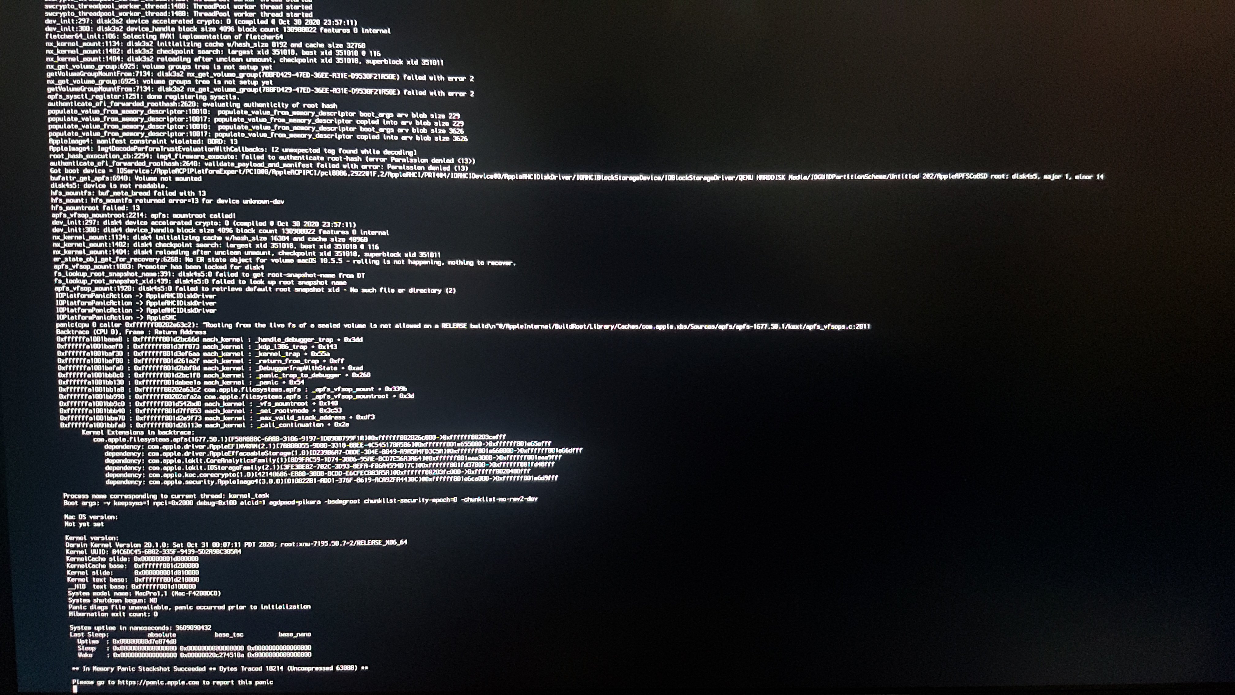

Update: I get a Panic.
11.0.1 System does not boot after update!
See screenshot. Any help?
Edited by derpuma
oooh I saw now: rooting from the live fs of a sealed volume is not allowed..."
Just set in opencore config SecureBootModel to Disabled (you probably set it to Default now) or update your opencore to the latest master release; Secure boot was fixed for big sur only recently.
Edited by ghost82
7 minutes ago, ghost82 said:
Share your config.plist and tell us which version of opencore you are using.
Are you using filevault?
Thx for the help. I think I might be on 0.6.4 but I am not sure, as I am completely new in OpenCore.
I do not use filevault, no encryption at all.
Attatched you find my EFI OpenCore Folder, also my macOS BigSur XML.
I am not sure how to setup my OpenCore while running BigSur.
I used ZEN settings for Opencore, but this might be wrong, as Virtualisation needs it setup for penryn?
EFI_Opencore.zip BigSur-XML.txt
I edited my reply above, please check and report.
That's strange because you already have SecureBootModel Disabled in the config plist you attached..Are you sure you are using that image?
The error is clear, and it's related to a bugged implementation of SecureBootModel, I have no other explanation..
Edited by ghost82

39 minutes ago, ghost82 said:
You also have a lot of kernel patches in your config.plist, you don't need them.
I only have these:
And these are the main differences with my config:
I deleted my prior post and I changed my config.plist according to your settings. Still the same boot error as shown in my screenshot.
Can you share your EFI Folder? Which Hardware are you using?
Is there a difference if I use AMD instead of Intel?
My Hardware: x570 aorus pro Mainboard, AMD 3900X, AMD 5700XT
I guess there is no way to undo the update and go back to Catalina?
EFI.zip

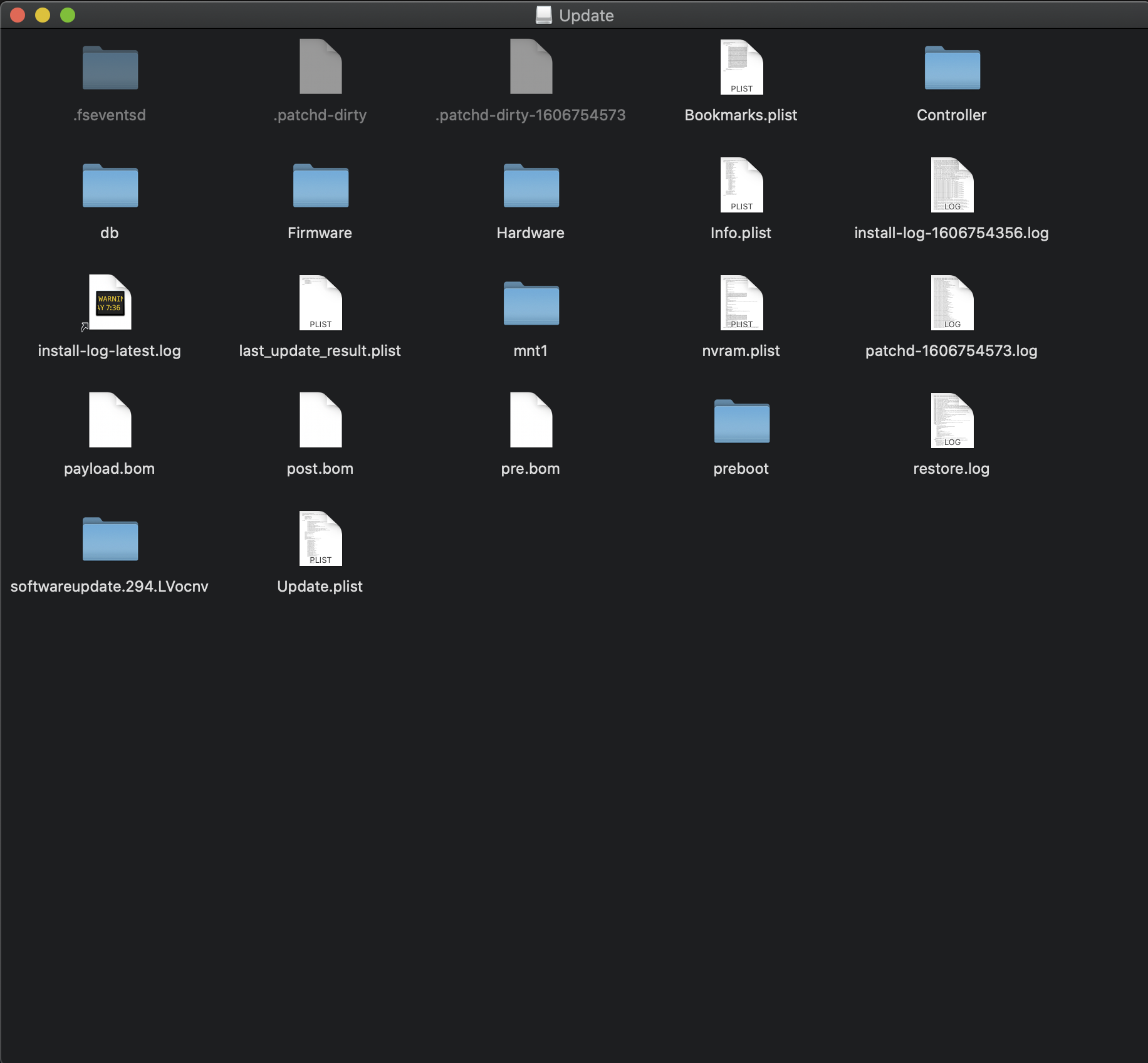

You should have just backed up the vdisk. I did, tried to update, failed, deleted that vdisk, got my backup up amd running in seconds.. Which btw you should have a process to backup your vms
I know, nothing very important on my catalina install.
Expect of one folder with files where I worked on for some hours and did not backup them cause of stupidity. 🙂
Indeed I did clone it before updating, but I lost my backup yesterday. It was the first time a diskimage dissapeared from my domain share folder.
What happend: While I was rendering my system crashed and after restart of the unraid server I was unable to mount my folders and the disk of my array.
After XFS repair all came back, except my Catalina vdsik image. 😞 imageproxy.php?img=&key=e5eec7c5c933ca16 guess It was lost, because the system crahed while writing to it and XFY was not able to recover it. If there is another chance to get it back, I will be happy to know how...
Unfortunately I am not able to mount the Big Sur vdisk image. When I try to mount it I get this (see screenshot).
But I guess I can reinstall Catalina via recovery boot dialog over the existing bootfail partition and the apps and data will stay there.
Never had to do this before...
Edited by derpuma
update
