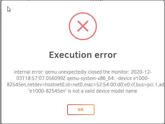

9 minutes ago, wojcioo said:
I've installed Catalina on Unraid on NUC and it works fine, but without connecting to apple id server. Then I've tried to edit xml to change the interface to e1000-82545en and it stopped working:
If I delete this change is is starting to work  again.
Then I tried to add logical processors and it stop working at all - there was a problem with the screen:
Any ideas?
Post your full xml

14 minutes ago, mSedek said:
Post your full xml
<domain type='kvm' xmlns:qemu='http://libvirt.org/schemas/domain/qemu/1.0'>

57 minutes ago, wojcioo said:
82545en
because it's a typo. it's em not en.
The error message is, for once, actually quite useful.

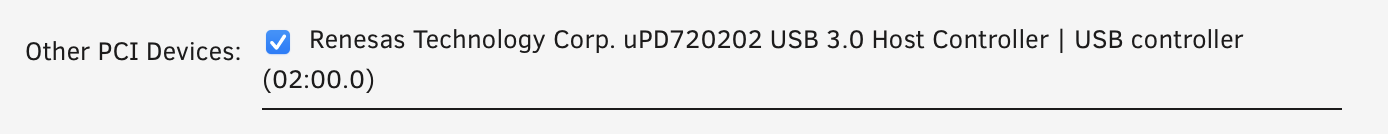

Yes, but only by passing a whole controller and performance is terrible, although that may be specific to my convoluted setup.

tried to reinstall catalina today, i got this message shown up, didnt change anything in the vm GUI config, please help;)
EDIT: sorry about that, obviously i missed the part about the network interface from SI tutorial;)
Edited by Januszmirek
missed one spot in spaceinvader tutorial;)

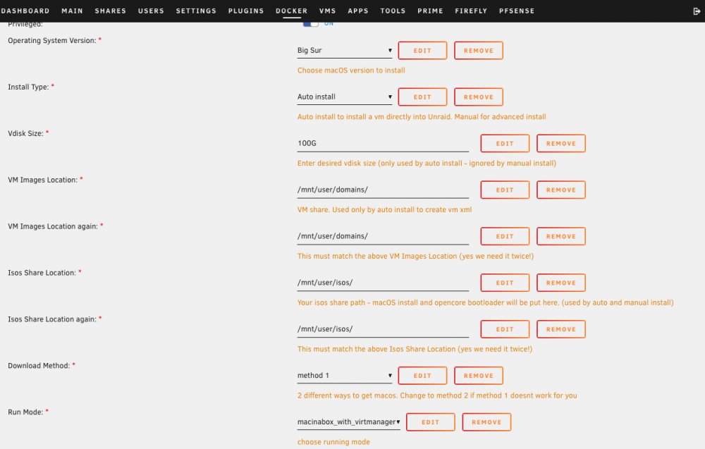

When you use the new version the existing template is not compatable with the new Macinabox. So please make sure to delete the container, the template and the appdata.
New template looks like this. If yours doesnt look like this its not the correct one.
1581854633_ScreenShot2020-12-09at02_21_31.thumb.png.829d4e01ee8d9699241b3a9b5db66103.png

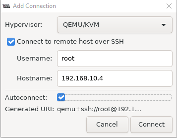

Great this new version.
But I don't know VirtManager well and I'm blocking on a connection problem.
Someone would have some explanations to pass on to me, regarding the Add connection window.
What do we have to fill in? Do you have to do setting before create a connection?
Hi Cuacococo,
try this
Select
Hypervisor: QEMU/KVM
Check: Connect to remote host over SSH
Username: root
Hostname: <IP of you Unraid Server>
Check: Autoconnect
Then you may need to accept the certificate (type yes) and enter the password of your Unraid account.
Now you should see all VMs defined in your Unraid including Macinabox (if successful installed).

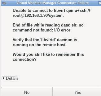

I get the same issue. Im typing the username root and IP correctly.
Can't wait for the video on how to use the new version.  Right now I cannot get it added and fumbling through isn't the easiest.
I KNOW deep down, I should wait for the video to come out... but dammit i'm too excited and have been waiting for a couple weeks! This is what happens when the container runs:
Any insight? Are there things that need to be setup on Unraid before-hand? I do have the VM service enabled.
EDIT: I'm also on the newest beta (6.9.0-beta-35) Although I'm pretty sure Ed runs the beta himself and I can't imagine him dropping something that will break when they release 6.9.0 so I don't think that is a problem.
