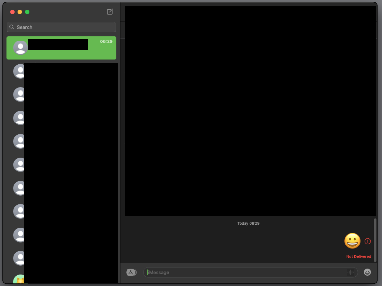

Has anyone been able to get iMessage working? I keep getting Error occurred during activation, I have tried Mojave, Catalina and Big Sur.

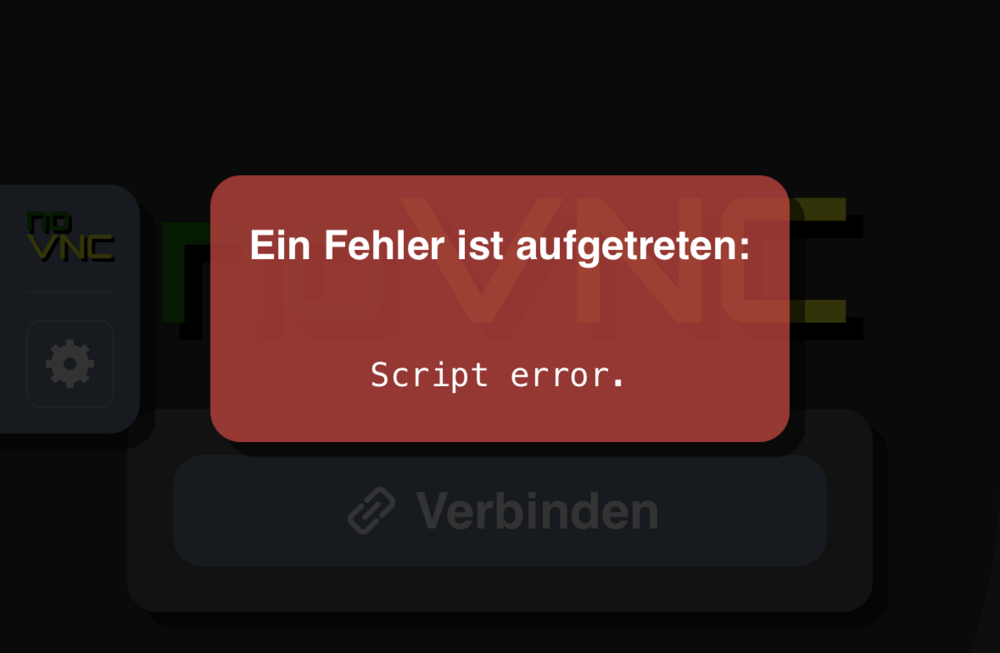

I'm not sure what I'm missing, after I pulled down the macinabox container the download started and finished fine, but after running the user scripts there is no vm listed under the vm tab. I have run the macinabox helper script multiple times but to luck
I also can't seem to open the virt manager by selecting webUI on the docker tab, here I get error 1006

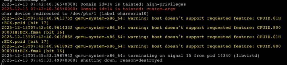

For some reason the downloaded version was actually Catalina. I have no idea how or why. I checked the docker, and it is set to "big sur". Also the name of the directory in "/mnt/user/domains/" is called "Macinabox\ BigSur" and the isos in the "/mnt/user/isos" are named "BigSur-install.img" and "BigSur-opencore.img".
The log in the docker says the following version was selected "Selected macOS Product: 061-86291".
At first I thought it might have been a corrupted iso, so I deleted everything, including docker, iso, domains, etc. But I had the same issue again.
Let me know if you need any further logs or info.
