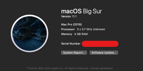

I'm stumped.  I follow this guide for Big Sur and everything is working except for passing through my RX 560 GPU.  I purchased the MSI version recommend directly on Apple's site.  I can access the VM via TeamViewer.  But the physical monitor stays on the Apple loading screen, even after the VM has booted.  It sees it in About this Mac, but doesn't seem to show all the usual properties.  Display Preferences doesn't see the display attached either.
I have to be missing something simple.
I pass through the GPU and Audio portions of the card, tried both with and without VBIOS.  Card works totally fine when attached to my Windows 10 VM. Tried both Trash Can and New Mac Pro platform types.
Any ideas?

I figured it out.
I turned off Resizeable Bar in the BIOS settings of my motherboard and it started working.
