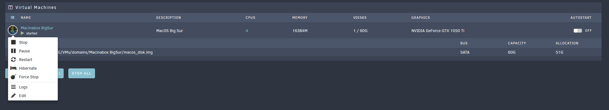

I have my Mac Big Sur Vm up and running without issue, but once I switch to my Graphcis card, how exactly do I view the VM?  Web Gui is now gone now that I'm not using VNCCapture.thumb.PNG.fb632e885d6e77f6cf4b3b48b189adfc.PNG
Same question here. When I did that and tried to go back to VNC the image no longer works. VNC says the session no longer send an image or something like that.

1 hour ago, steve1977 said:
I am facing the same issue. Everything used to work well. Then switched back to VNC and I am getting the error above. And after switching back to GPU-passthrough, it no longer works. Used the script a few times both with and without GPU. But no luck!
Any ideas?
Yes you need to delete the VM (Just the VM, not the disks) and remake it.  But the easiest way to do it is just to edit the current VM.
Click the VM, then edit.  At the top, hit the "form view"  button to slide it over to XML view.
Now navigate to \appdata\macinabox\macinabox and find the file called Macinabox BigSur_original.xml.  Copy the contents of this file and paste it into the XML for your VM that youre editing.  Look at all the paths in the code, make sure everything lines up with how your setup is.  Now save it and run the userscript again which edits the XML.  Should be fixed now.
