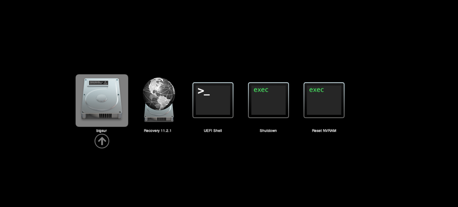

Thanks, but how do I boot into the mac automatically when the VM starts?  For instance if I wanted to use teamviewer to remote in, I could set that up but it need to load the OS for that to be available.  Starting the VM just goes to the volume select screen and you need to hit enter first before the OS loads.  See screenshot:
Edited by 007craft
Reading this thread over the last few days, I've learned something important. To use GPU passthrough on a VM you need to have a monitor physically connected to the server to leverage it. Sorry if this was something I should have known. I guess the black screen I was reporting when trying to connect the VM from another computer was to be expected (laughs at self).
So maybe I'll ask my question a different way... IF I have a GPU passed through to my Unraid VM, and I have it set to autologon and launch a server (No Machine, for e.g.), will I be able to achieve higher resolution inside the VM client? Right now its 1920x1080, which is passable, but I was hoping to get closer to bare metal resolution. Is what I'm trying to achieve possible? Thanks!
Instead of an actual monitor, you can also attach a hdmi plug. I’m not certain, but believes this will get you 4k over vnc with the right dongle.
I do have a separate issue. I can no longer get audio to work. I’ve tried splashtop as suggested in this group. In fact, it shows splashtop as audio output, but i cannot hear any audio. Any idea?
You can configure OpenCore to boot from a default volume. I don't recall quite how off the top of my head but it's here in this thread and possibly also in the comments to the YouTube video.

I have a problem with my GPU Passthrough, im able to start the boot by selecting the hard drive and the apple logo shows up.
But when the loading bar finished, i got a black screen and no signal. So i think, my passthrough works but maybe something don't work with my macos (fresh install)
My system specs:
M/B: Gigabyte Technology Co., Ltd. B550M AORUS PRO-P
CPU: AMD Ryzen 7 5800X 8-Core @ 3800 MHz
GPU0: NVIDIA RTX 3070 (for windows)
GPU1: NVIDIA Quadro K600 (for mac)
This is my config:
<domain type='kvm' id='15' xmlns:qemu='http://libvirt.org/schemas/domain/qemu/1.0'>
