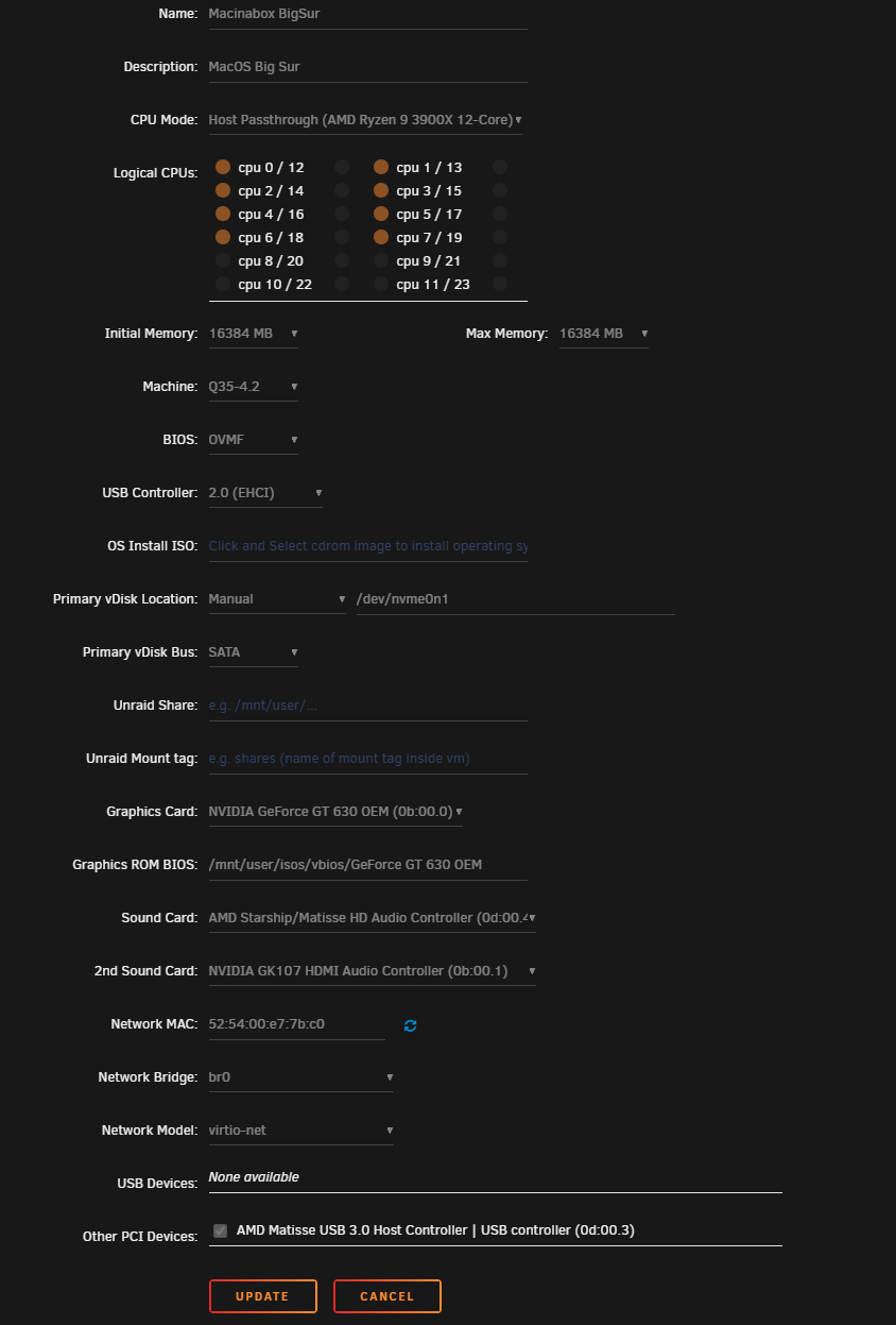

Hello I got a quick question.
I am unable to get sound within my MacOS Big Sur VM.
I added the onboard sound card (Asrock X570 with 3900X). But within the MacOS my sound devices are empty. I already played around with kext files and efi driver files but nothing seems to work... Attached a screenshot which shows how I set it up. I also tried to change the first sound card to the nvidia one and the AMD onboard to the second one. But nothing seems to work. Even the nvidia sound (hdmi) wont show up...)
Follow this tutorial to enable sound https://dortania.github.io/OpenCore-Post-Install/universal/audio.html
9 hours ago, RiDDiX said:
I already tried these steps but still no luck with hdmi sound and onboard sound. Just my headphone usb dongle works emoji22.png
Since both sound devices are not working you either have a separate issue effecting each device or one issue taking out both.
I probably have a very similar setup (AsRock x570 Phantom Gaming X) board. I am using HDMI audio on both my Mac and Win VMs because that way as I switch monitor input the audio source is switched at the same time. I take the audio output from my monitor and pass it to my speakers/headphones.
The only issue is when using Mac with HDMI audio you loose volume control so I paid $19 for Sound Control which gives fixes a lot of Mac audio shortcomings.
Make sure you have your video card passed through correctly (as is often discussed in this forum).

Make sure you have multifunction enabled correctly and are assigning to the same bus. As per my example above;
bus='0x12' slot='0x00' function='0x0' ---> bus='0x04' slot='0x00' function='0x0' multifunction='on'
bus='0x12' slot='0x00' function='0x1' ---> bus='0x04' slot='0x00' function='0x1'
Your card looks like it is on bus 0x0b, I can't see where it is assigned too as you haven't posted your XML.
Remember the GUI will not set this up correctly, it will not use multifunction and will put them on different destination busses.
As for both audio devices. They should show up easily. You just need Lilu, WhateverGreen and AppleALC kexts. I have read a few posts reporting issues with the onboard Realtek chip, until adding boot-args alcid=1 or alcid=11.
Make sure you have the latest versions of the kexts as they are adding new layout-ids all the time.
Just something to start with. Let us know how you go. If no luck, I should be able to pass through my onboard card and take a look for you. Just might be a day or two till I have a chance.

Thank you for the clearification. I try it by setting up my xml.
This is my actual xml file.
This is my corrected xml I hope it'll work! Thank you.
<domain type='kvm' xmlns:qemu='http://libvirt.org/schemas/domain/qemu/1.0'>
  <name>Macinabox BigSur</name>
  <uuid>f99ca344-b927-4632-b4f5-549c3cba4124</uuid>
  <description>MacOS Big Sur</description>
  <metadata>
    <vmtemplate xmlns="unraid" name="Windows 10" icon="default.png" os="osx"/>
  </metadata>
  <memory unit='KiB'>16777216</memory>
  <currentMemory unit='KiB'>16777216</currentMemory>
  <memoryBacking>
    <nosharepages/>
  </memoryBacking>
  <vcpu placement='static'>8</vcpu>
  <cputune>
    <vcpupin vcpu='0' cpuset='0'/>
    <vcpupin vcpu='1' cpuset='1'/>
    <vcpupin vcpu='2' cpuset='2'/>
    <vcpupin vcpu='3' cpuset='3'/>
    <vcpupin vcpu='4' cpuset='4'/>
    <vcpupin vcpu='5' cpuset='5'/>
    <vcpupin vcpu='6' cpuset='6'/>
    <vcpupin vcpu='7' cpuset='7'/>
  </cputune>
  <resource>
  </resource>
  <os>
    <type arch='x86_64' machine='pc-q35-4.2'>hvm</type>
    <loader readonly='yes' type='pflash'>/mnt/user/system/custom_ovmf/Macinabox_CODE-pure-efi.fd</loader>
    <nvram>/etc/libvirt/qemu/nvram/f99ca344-b927-4632-b4f5-549c3cba4124_VARS-pure-efi.fd</nvram>
  </os>
  <features>
    <acpi/>
    <apic/>
  </features>
    <topology sockets='1' dies='1' cores='4' threads='2'/>
    <cache mode='passthrough'/>
    <feature policy='require' name='topoext'/>
  </cpu>
  <clock offset='utc'>
    <timer name='rtc' tickpolicy='catchup'/>
    <timer name='pit' tickpolicy='delay'/>
  </clock>
  <on_crash>restart</on_crash>
  <devices>
    <disk type='block' device='disk'>
      <source dev='/dev/nvme0n1'/>
      <target dev='hdc' bus='sata'/>
      <boot order='1'/>
      <address type='drive' controller='0' bus='0' target='0' unit='2'/>
    </disk>
    <controller type='pci' index='0' model='pcie-root'/>
    <controller type='pci' index='1' model='pcie-root-port'>
      <model name='pcie-root-port'/>
      <target chassis='1' port='0x8'/>
      <address type='pci' domain='0x0000' bus='0x00' slot='0x01' function='0x0' multifunction='on'/>
    </controller>
    <controller type='pci' index='2' model='pcie-root-port'>
      <target chassis='2' port='0x9'/>
    </controller>
    <controller type='pci' index='3' model='pcie-root-port'>
      <target chassis='3' port='0xa'/>
      <address type='pci' domain='0x0000' bus='0x00' slot='0x01' function='0x2'/>
    </controller>
    <controller type='pci' index='4' model='pcie-root-port'>
      <target chassis='4' port='0x13'/>
      <address type='pci' domain='0x0000' bus='0x00' slot='0x02' function='0x3'/>
    </controller>
    <controller type='pci' index='5' model='pcie-root-port'>
      <target chassis='5' port='0x14'/>
      <address type='pci' domain='0x0000' bus='0x00' slot='0x02' function='0x4'/>
    </controller>
    <controller type='pci' index='6' model='pcie-root-port'>
      <target chassis='6' port='0xb'/>
      <address type='pci' domain='0x0000' bus='0x00' slot='0x01' function='0x3'/>
    </controller>
      <address type='pci' domain='0x0000' bus='0x02' slot='0x00' function='0x0'/>
    </controller>
      <address type='pci' domain='0x0000' bus='0x00' slot='0x1f' function='0x2'/>
    </controller>
    </controller>
      <master startport='0'/>
    </controller>
      <master startport='2'/>
    </controller>
      <master startport='4'/>
    </controller>
    <interface type='bridge'>
      <mac address='52:54:00:e7:7b:c0'/>
      <source bridge='br0'/>
      <model type='e1000-82545em'/>
      <address type='pci' domain='0x0000' bus='0x01' slot='0x00' function='0x0'/>
    </interface>
    <serial type='pty'>
        <model name='isa-serial'/>
      </target>
    </serial>
    <console type='pty'>
    </console>
    <channel type='unix'>
    </channel>
    </input>
      <driver name='vfio'/>
      <source>
        <address domain='0x0000' bus='0x0b' slot='0x00' function='0x0'/>
      </source>
      <rom file='/mnt/user/isos/vbios/GeForce GT 630 OEM'/>
      <address type='pci' domain='0x0000' bus='0x03' slot='0x00' function='0x0' multifunction='on'/>
    </hostdev>
      <source>
        <address domain='0x0000' bus='0x0d' slot='0x00' function='0x4'/>
      </source>
      <address type='pci' domain='0x0000' bus='0x04' slot='0x00' function='0x0'/>
    </hostdev>
      <source>
        <address domain='0x0000' bus='0x0b' slot='0x00' function='0x1'/>
      </source>
      <address type='pci' domain='0x0000' bus='0x03' slot='0x00' function='0x1'/>
    </hostdev>
      <source>
        <address domain='0x0000' bus='0x0d' slot='0x00' function='0x3'/>
      </source>
      <address type='pci' domain='0x0000' bus='0x06' slot='0x00' function='0x0'/>
    </hostdev>
    <memballoon model='none'/>
  </devices>
  <seclabel type='dynamic' model='dac' relabel='yes'/>
  <qemu:commandline>
    <qemu:arg value='-usb'/>
    <qemu:arg value='-device'/>
    <qemu:arg value='usb-kbd,bus=usb-bus.0'/>
    <qemu:arg value='************************'/>
    <qemu:arg value='-smbios'/>
    <qemu:arg value='type=2'/>
    <qemu:arg value='-cpu'/>
    <qemu:arg value='Penryn,kvm=on,vendor=GenuineIntel,+invtsc,vmware-cpuid-freq=on,+pcid,+ssse3,+sse4.2,+popcnt,+avx,+aes,+xsave,+xsaveopt,check'/>
  </qemu:commandline>
</domain>
Edited by RiDDiX
