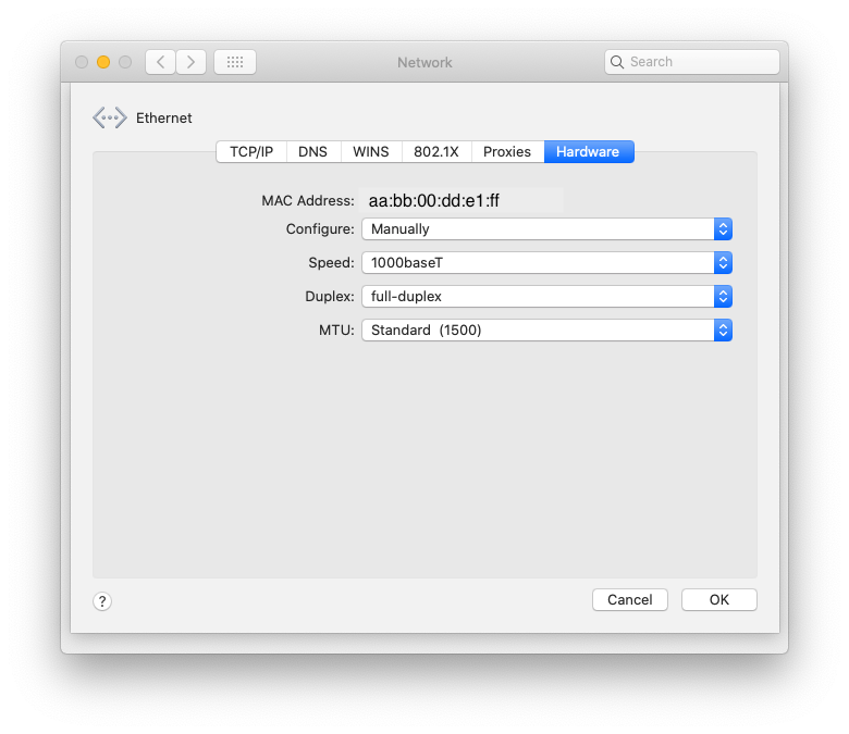

I had a strange problem where maybe every fifth boot my Mojave VM wouldn't have a network connection (using e1000-82545em.) The adapter (Realtek RTL8111H) was detected but no connection.
I fixed it by manually configuring the adapter in the VM. Dozens of boots so far and it hasn't happened again. Hope that's helpful.47k8x86pa1f51.png.6a2909e86e9d27346017a23b31a8fb4e.png

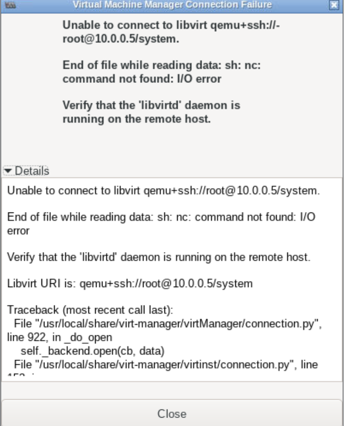

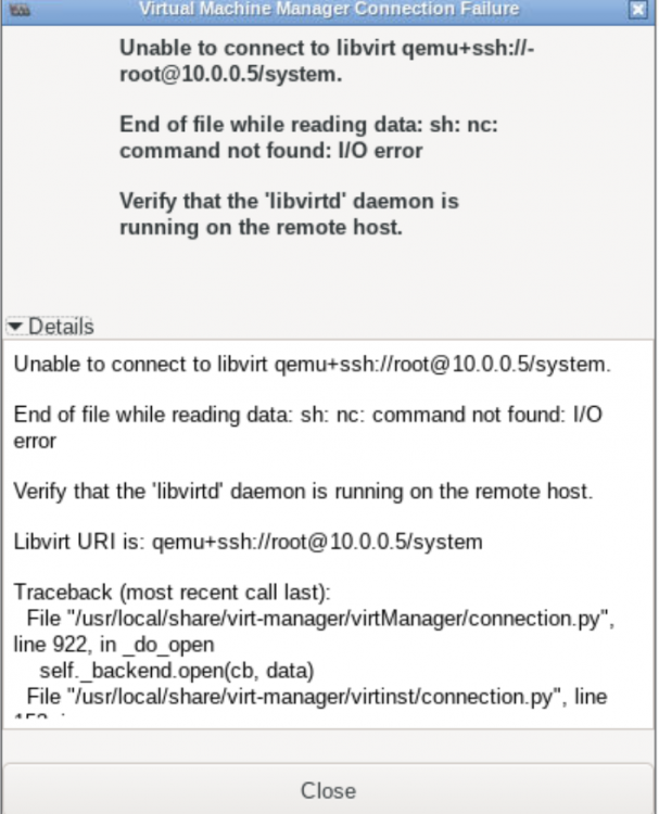

I'm unable to get virt-manager to connect to unraid:

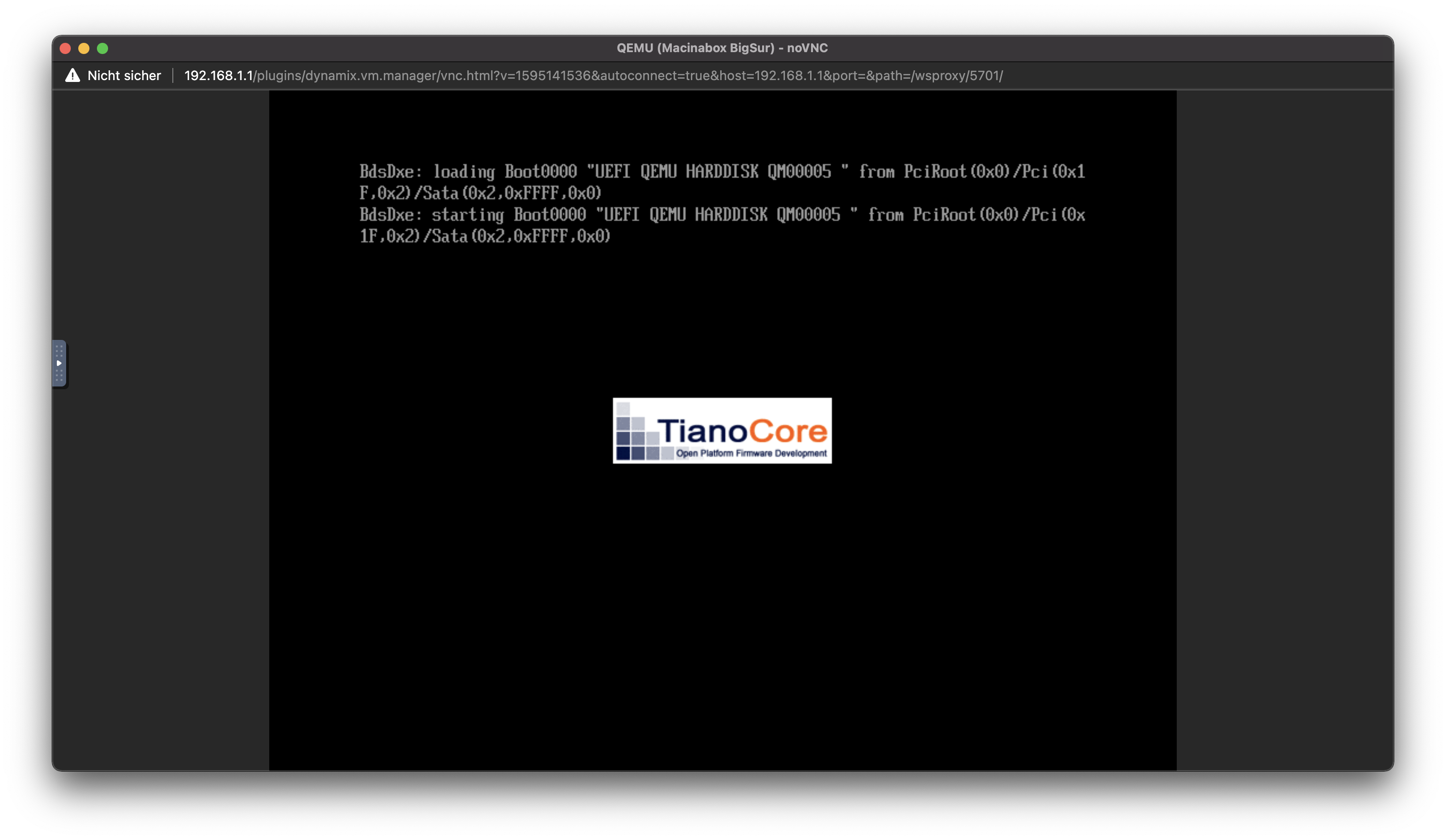

On 5/2/2021 at 9:26 PM, matthew42904 said:
im having a issue with bigsur when i run the macos base system. it reboots and when i hit base system again this message pops up. i have tryed a reinstall of everything like 10 times.
edit: i just tried a manual install and the image is broken when downloadedimage.thumb.png.3d17ebc72656e30c2634ecb9708c5e2b.png
Big Sur was running fine for me then I had to rebuild my VM and since then I get the same error. I have tried to remove all data and restart. I think it is either the Unraid update or the Big Sur update 11.3.X. It could also be that Opencore needs an update.

33 minutes ago, glennv said:
Anyone want to share a working EFI qcow image to boot BigSur 11.3 (or 11.3.1) ?
Tried to update my old 11.2 which did not work even after applying earlier mentioned penryn passthry fix.
Tried a fresh MAcinabox, but also not booting (same as previous posters).
Here you go!
https://easyupload.io/zyte8s
You should just try to recreate your Macinabox. This means. Delete both created userscripts, then remove the Docker-App and then remove the "app" macinabox.
Now go into the Community-Apps and reinstall the Macinabox app with your settings.
1 hour ago, RiDDiX said:
Here you go!
Thanks, but somehow stuck with the same issues (just bootlooping when upgrading from 11.2 to 11.3.1 or on case of new install just looping from the start.
Will give up for now as not sure what is going on here. Will wait for a macinabox upgrade
Thats bad. Maybe you could provide me the XML file of your VM?
I updated now two times my Mac Big Sur VM without any problems. My first problem was a bad OpenCore config xD (my fault)
Edited by RiDDiX
Unfortunately, this does not work. I have deleted everything and reinstalled. The same error occurs and looping from the start.
Edited by Zulu2k
Provide your config.plist (delete sensible data), or better the full efi or send via pm.
If you're passing through the cpu you need both patches for penryn family force, one for 11.2 and one for 11.3 (with proper min and max kernel versions) otherwise it will hang on 11.2 (if you're using the 11.3 patch) or on 11.3, after the first boot after the update (if you're using the 11.2 patch); otherwise you can use the 11.2 patch, reboot after the update (and it will hang), force shutdown the vm, edit the penryn patch for 11.3 from unraid, boot to bootpicker and complete the 11.3 update.
Or boot to 11.2 with the 11.2 patch, update and at the same time modify the config.plist with the 11.3 patch from mac os, so on first reboot you will have the 11.3 patch.
Using -v in boot-args or better target 83 in config plist (with opencore debug version) should help in understanding the issue.

First patch will be used from High Sierra (darwin 17.0.0) to Big Sur 11.2.3 (darwin 20.3.0)
Second patch will be used from Big Sur 11.3 (darwin 20.4.0) and up (darwin 20.99.99 <-- fake one)

Ok, its working now. It was indeed as you suggested "adding" the new penryn patch to the plist instead of as i did before replacing the existing patch.
Tnx again !!!
