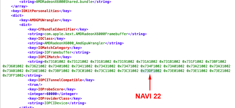

Hello ghost,
Considering that there’s still no 6700 xt driver is it possible to fool the os and make it think it’s a different gpu, one that is supported? If this is possible please share the method and also it it can harm my gpu. Thanks.
No, it's not possible. You need a driver to load and there is no driver for that gpu. Spoofing works if the driver lacks the specific model but it works when loaded, and unfortunately that is not the case for the 6700xt.
ok thanks
13 hours ago, Ernie11 said:
ok thanks
You need to be patient...there are traces in the code of the 6700xt..sooner or later it will be added, I'm quite sure.
Edited by ghost82
I know I know I have to be patient. It’s just that my Mac Pro died and I’m Macless right now. Will keep my hopes up and checking the betas. Thanks
