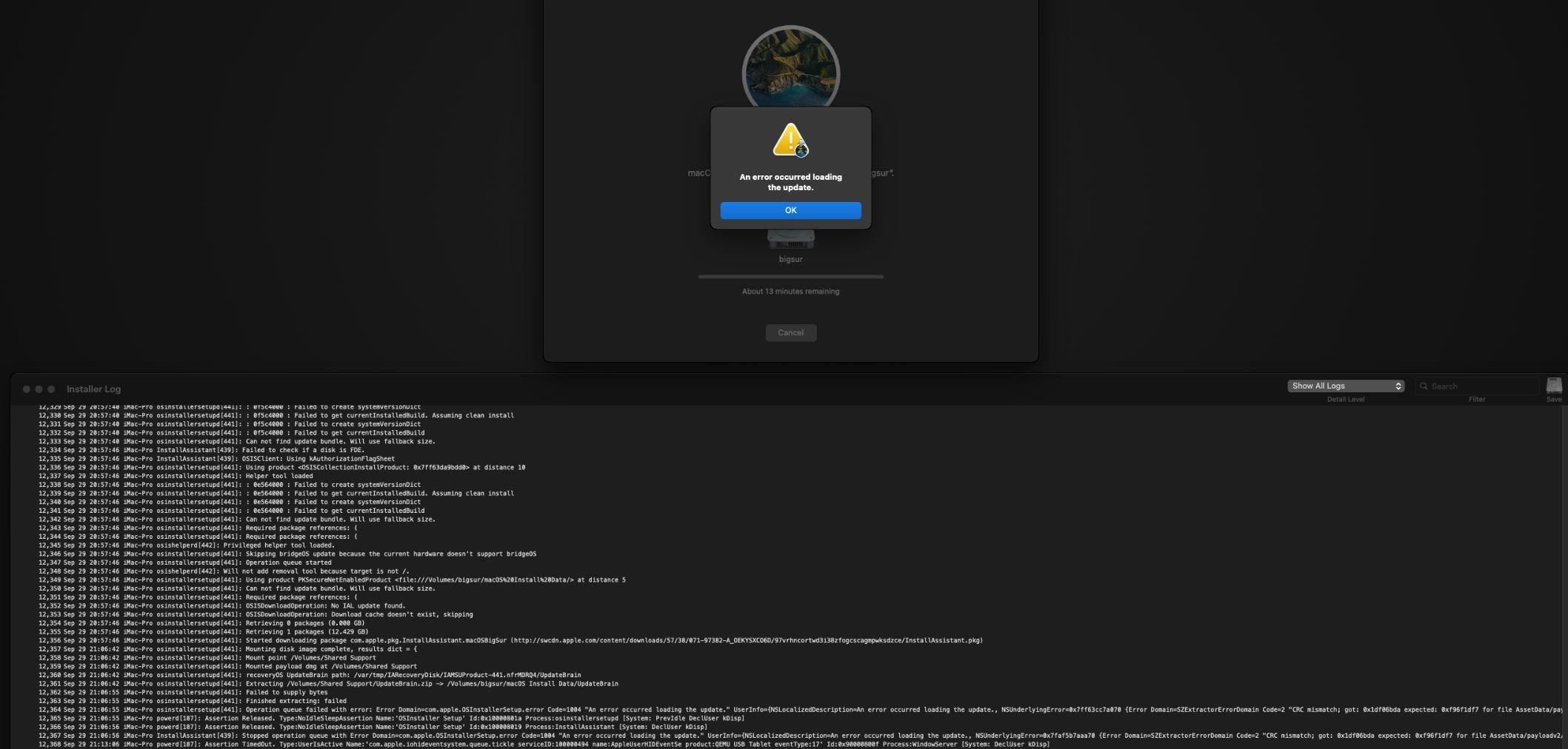

Hello,
I'm able to get to the disk check utility and start the BigSur install. However, the install always fails with the error "An error occurred loading the update". I've tried removing dev/urandom, fresh installing macinabox, removing customovf, and everything else I can think of.
Weird thing is, first time I installed macinabox and BigSur it worked just fine. I then deleted that vm because i was having (unrelated) problems and ever since then it has failed in the exact same way.
Anyone have any ideas?
Attached is the error and the installer log.
Not enough disk space?
I'm seeing a crc mismatch in the log, so the download seems corruted, download the image again.
Edited by ghost82
I made a 100G hard drive in the docker settings. Also tried it with a 200G harddrive, no luck. My array has terabytes of free space, so I don't think its that. But I've read that reply elsewhere about space. I will try to play with increasing disk size.
Edited by akauper
That was the answer somehow... Set docker to 400G and it worked. No idea why. Even SpaceInvaderOne's video says 100G. But if anyone else comes here with the same issue there you go!
Thank you ghost82!!
Edited by akauper
Happy that you solved, however 100GB should be enough; I rather think it was a corrupted downloaded image.
