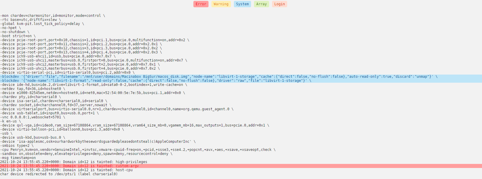

I haven't made any recent changes to my mac VM inside unraid, but now I can't VNC or Nomachine into it. I'd be very appreciative if someone can take a look at my XML...
<domain type='kvm' id='12'>

That did the trick. Fixed now, but I do wonder how those args got stripped. Thanks again!!
customized args are deleted if you use the gui.
That would be it. Thanks!

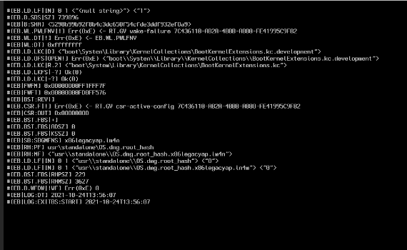

Hi guys, just installed Big sur through mackinabox using spaceinvaiderone's tutorial. everything seemed fine until the very end after running the macinabox helper script at the end. when i stert the vm and run novnc i get the following rather than it booting up:
before i had chance to select anything it then proceeded to the image below:
and thats as far as it would go. Any help much appreciated. I have attached the docker log file:
It has been said several times :D:
STOP USING OPENCORE CONFIGURATOR
Start over or download a fresh opencore img and boot from it and after this:
Opencore in macinabox is v. 0.7.0
Maybe I will push a pr with latest opencore just to not read these msgs all over again, let's do it :D
PR submitted, let's wait to it being merged (if it is accepted):
https://github.com/SpaceinvaderOne/Macinabox/pull/53
Edited by ghost82
