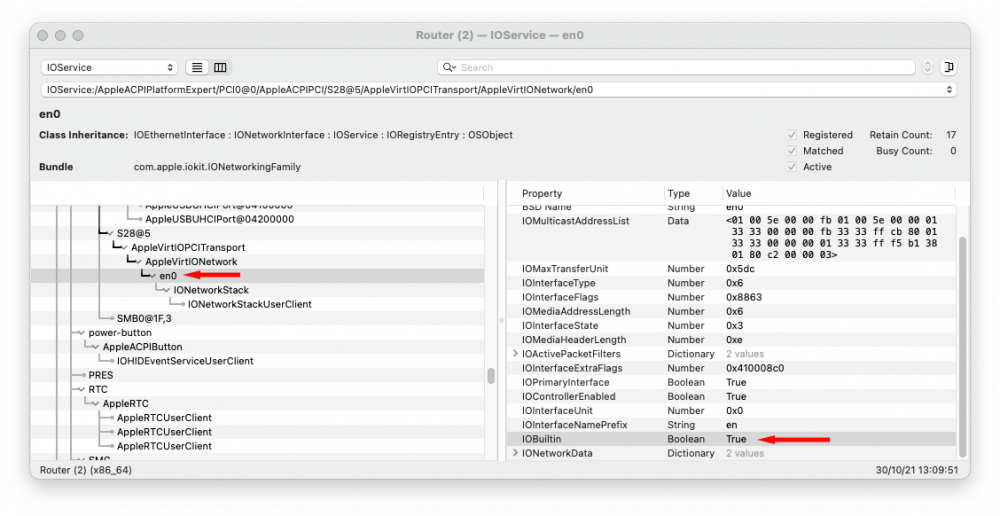

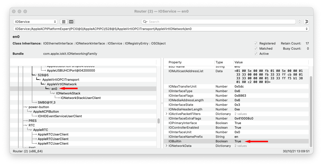

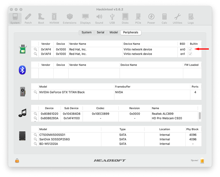

25 minutes ago, ghost82 said:
Check en0 is built-in with hackintool or ioregistry explorer.
With hackintool:
Or with ioregistry explorer:
If it's not built in change the bus address in the xml of the vm to 0x00 (and obviously set a free slot), this will make the network built-in without applying any patch:

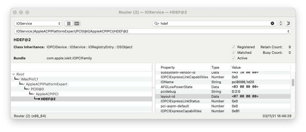

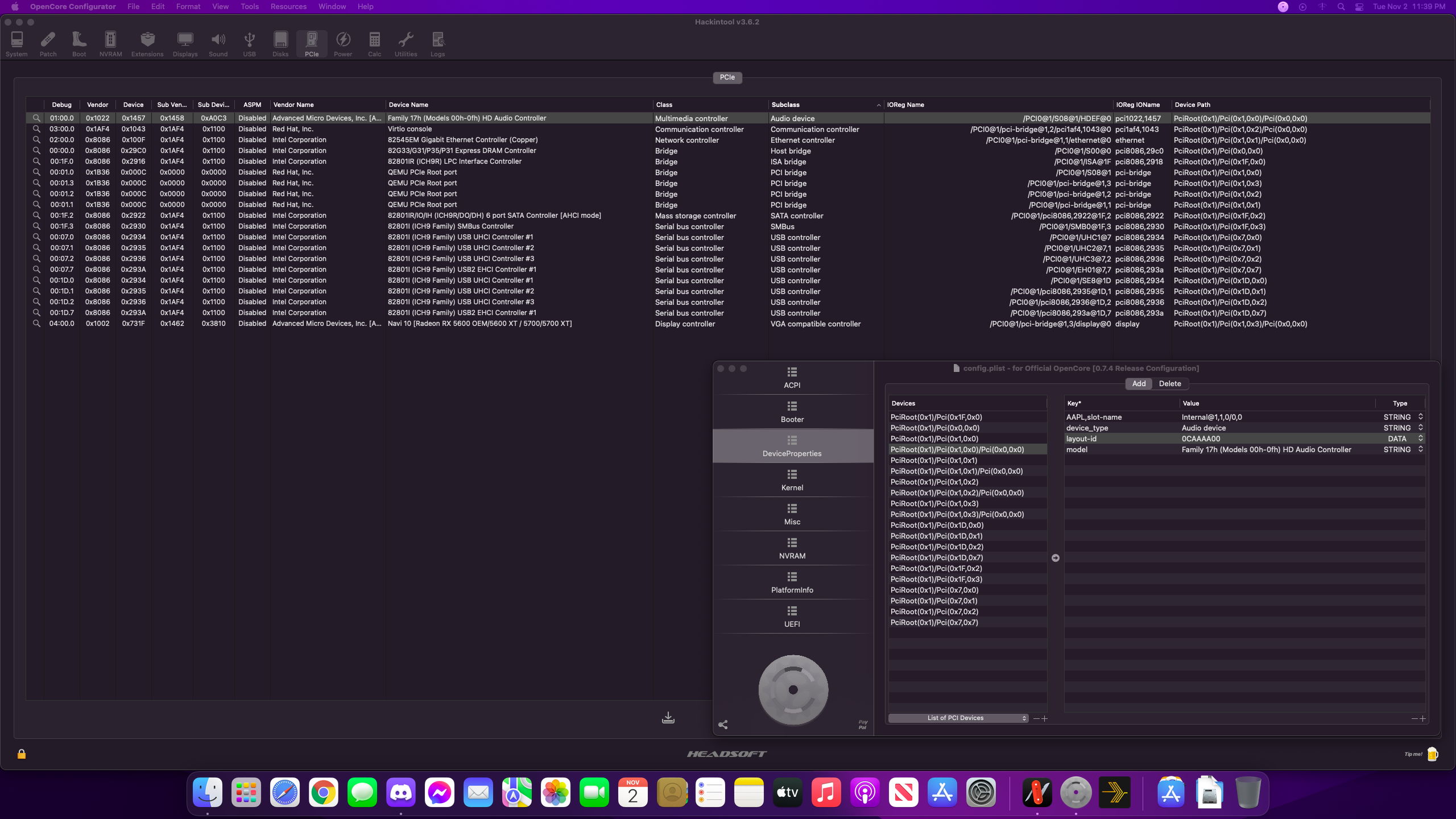

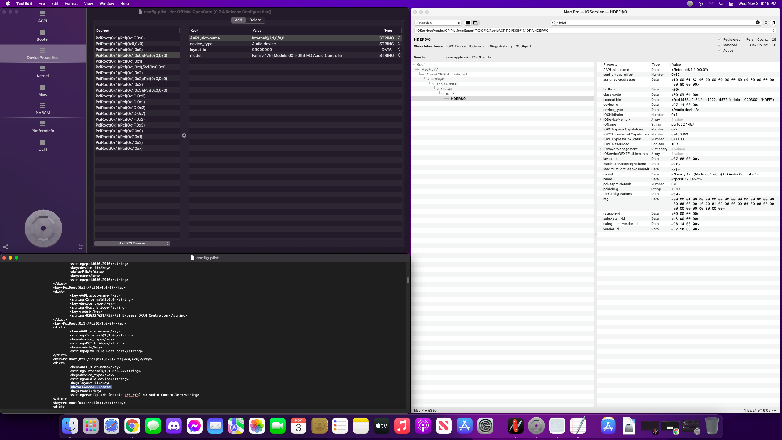

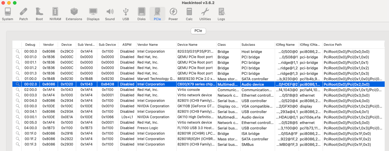

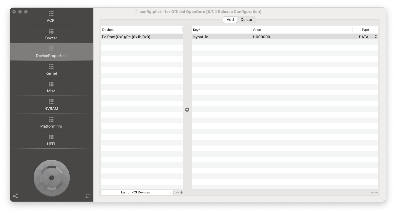

33 minutes ago, Donny S Beatz said:
Am I doing something incorrectly?
Probably yes if it works with boot-arg but not by injecting the layout :D
To correctly apply layout id:
0. Make sure audio is on bus 0x00 in your xml
1. Find the correct device path with hackintool (in this example PciRoot(0x0)/Pci(0x2,0x0)):
2. Mount the efi and open the config.plist with a text editor; in "DeviceProperties --> Add" add your layout-id:
	<key>DeviceProperties</key>
	<dict>
		<key>Add</key>
		<dict>
			<key>PciRoot(0x0)/Pci(0x2,0x0)</key>
			<dict>
				<key>layout-id</key>
				<data>BwAAAA==</data>
			</dict>
Use an integer (decimal) to base64 converter, for example:
https://v2.cryptii.com/decimal/base64
In this example BwAAAA== base64 means 7 0 0 0 decimal (7<space>0<space>0<space>0), so in that site if layout is 7 input 7 0 0 0 and convert it.
For a 2 digits layout, for example 13, input it like 13 0 0 0 (13<space>0<space>0<space>0).
3. Remove the layout id boot arg

I'm not entirely sure what i'm doing wrong.
I tested the different layout IDs and went through each one on the list but still can't seem to get audio to work when applying it via Device Properties.
If i do the boot-args method it will work.
Am I missing something?
You are not converting correctly from decimal to base64, I explained that.
Don't use hexadecimal, dortania is saying AppleALC could accept hexadecimal values, not opencore.
in your screenshot you applied a layout id of 0CAAAA00 --> ??? (layout 12?? don't know how you converted it :D ...anyway not converted correctly)
Correct values (type DATA):

Ok, sorry, I need to describe it again if you use opencore configurator (I don't like it at all!!!)
1. OK
2. OK
3. OK
4. OK
5. OK
6. OK
7. No, sorry, here opencore configurator behavior is not standard in my opinion: it is asking for DATA type, but you need to input HEX data, that HEX data are written in base64 to the config.plist (what a mess!!!)
So, look at this example:
Layout n. 17  --> 17 0 0 0 (decimal)
Converted to HEX: 11 00 00 00 --> 11000000
11000000 is the value that you input into opencore configurator (type DATA):
If you save the config.plist and you open it with a text editor they are saved as base64 automatically:
So, new values to input into opencore configurator:
Layout 1:          01000000
Layout 100:      64000000
Layout 11:         0B000000
Layout 13:         0D000000
Layout 15:        0F000000
Layout 16:        10000000
Layout 17:         11000000
Layout 2:          02000000
Layout 21:        15000000
Layout 27:        1B000000
Layout 28:        1C000000
Layout 29:        1D000000
Layout 3:          03000000
Layout 30:        1E000000
Layout 34:        22000000
8. OK, check type is DATA
9. OK
10. OK
11. OK
You can check the right value is applied with ioregistry explorer (this is my layout for layout-id=7 decimal):
Values are correctly applied if you read it in <HEX>
Edited by ghost82

So I went through each layout you converted for me (thank you so much, btw!) but still no dice.
I changed out the layout-id in OpenCore Configurator, verified in the config.plist that the conversion is right but in IORegistryExplorer the layout-id is not right.
If the layout # works under boot-args it should work for the layout-id value right?
Now you are doing it correctly.
Yes, and ioreg is reporting "a correct value", but not that of the device properties, it seems it still applies the boot-arg value (?), or you didn't reboot the vm (?).
Assuming the screenshot comes from a reboot of the vm (you see the changes in ioreg only after you applied the device property in the config.plist and only after a reboot, it doesn't happen "on the fly"), in device properties you have layout id 11, in ioreg you have layout id 7.
If this happens (even after applying the device property and after a reboot of the vm), check in a terminal of the vm:
nvram 7C436110-AB2A-4BBB-A880-FE41995C9F82:boot-args
1. Check that the layout-id variable is not there
2. Check in config.plist that you have an entry for 7C436110-AB2A-4BBB-A880-FE41995C9F82 in the Delete tab for boot-args
3. Check that WriteFlash is enabled
Edited by ghost82
