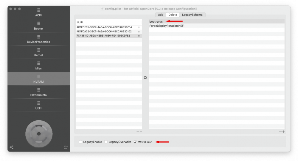

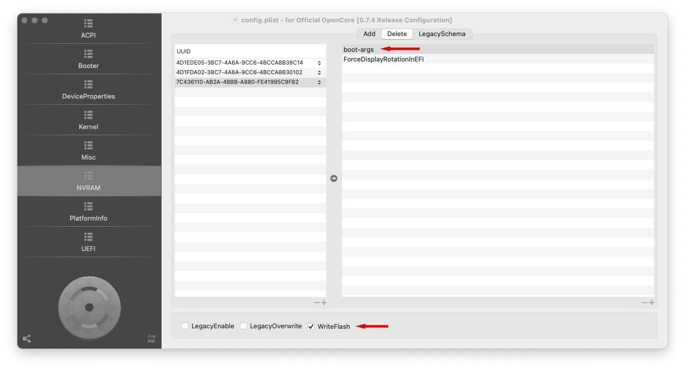

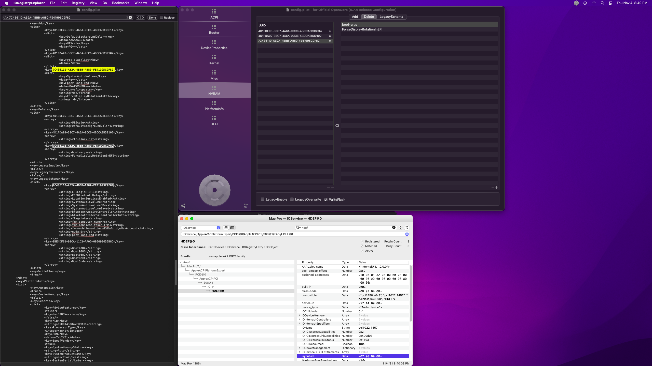

18 hours ago, ghost82 said:
Now you are doing it correctly.
Yes, and ioreg is reporting "a correct value", but not that of the device properties, it seems it still applies the boot-arg value (?), or you didn't reboot the vm (?).
Assuming the screenshot comes from a reboot of the vm (you see the changes in ioreg only after you applied the device property in the config.plist and only after a reboot, it doesn't happen "on the fly"), in device properties you have layout id 11, in ioreg you have layout id 7.
If this happens (even after applying the device property and after a reboot of the vm), check in a terminal of the vm:
nvram 7C436110-AB2A-4BBB-A880-FE41995C9F82:boot-args
1. Check that the layout-id variable is not there
2. Check in config.plist that you have an entry for 7C436110-AB2A-4BBB-A880-FE41995C9F82 in the Delete tab for boot-args
3. Check that WriteFlash is enabled
Thank you again for the reply and help, I greatly appreciate it!
Correct, after each change I make, I save, unmount and reboot the VM.
When I run that nvram command I get an error that data was not found. From what I Google that seems normal?
I searched the config.plist and found 3 entries.
I enabled WriteFlash and rebooted but still nothing. I'm just not sure where that IORegistry is pulling that layout-id from.
Edited by Donny S Beatz
Forgot to attach screenshot
what if if you delete the layout id from config.plist?does that entry is still in ioreg?can you share in private the whole efi folder?
Edited by ghost82

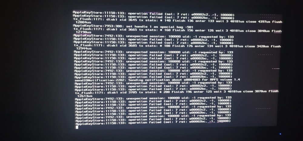

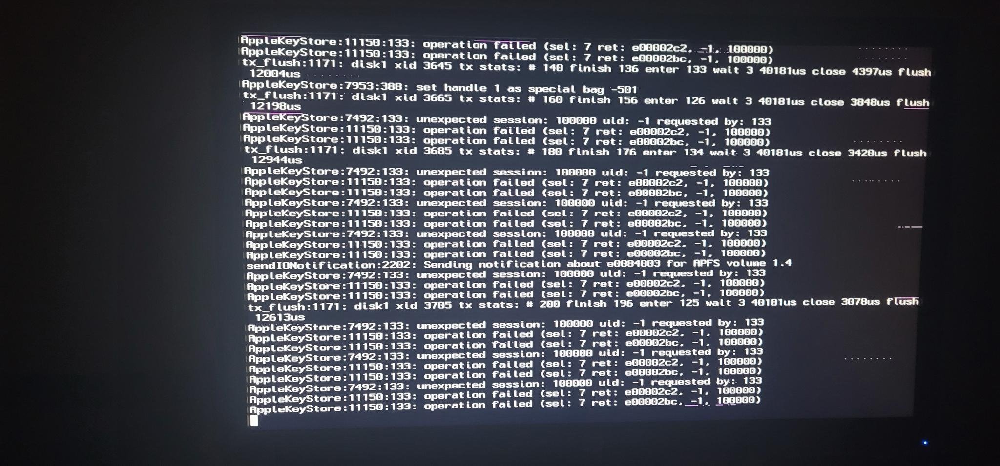

On 11/1/2021 at 8:52 PM, steve1977 said:
Thanks a lot. WIll look into it.
Unfortunately, update to Monterrey "bricked" my VM. I tried to switch back to VNC to understand what's going on, but this also doesn't work (guest has not initiated the screen yet). I remember the latter error was easily fixable through some change in the XML (and a bug when switching back from passthrough to VNC). I couldn't find though what I had to change in the XML. Anyone remember?
@steve1977 Did you manage to get your VM unbricked?  I did the same thing...  updated to Monterey, now hang on an apple logo after a reboot.  Not sure if it's related to pass through...
I see this in the VM log:
2021-11-02 08:37:47.069+0000: Domain id=11 is tainted: high-privileges
2021-11-02 08:37:47.069+0000: Domain id=11 is tainted: custom-argv
2021-11-02 08:37:47.069+0000: Domain id=11 is tainted: host-cpu
char device redirected to /dev/pts/1 (label charserial0)
2021-11-02T08:41:39.167141Z qemu-system-x86_64: terminating on signal 15 from pid 28969 (/usr/sbin/libvirtd)
I removed the layout-id but IORegistry still pulls that <07 00 00 00>
Sounds good. I'll shoot you a message.
I appreciate all the help!
I thought again at this...
Are you sure you are editing the correct config.plist?In other words, are you sure you only have one efi partition with opencore?
I can explain only with this, because:
1. layout-id in boot args has priority compared to config.plist; this is independent on how many efi partitions you have and what it is used.
2. so, modifications to the config.plist are correct, but...are you sure you are mounting the correct efi partition?
What's the output of:
diskutil list
Edited by ghost82
