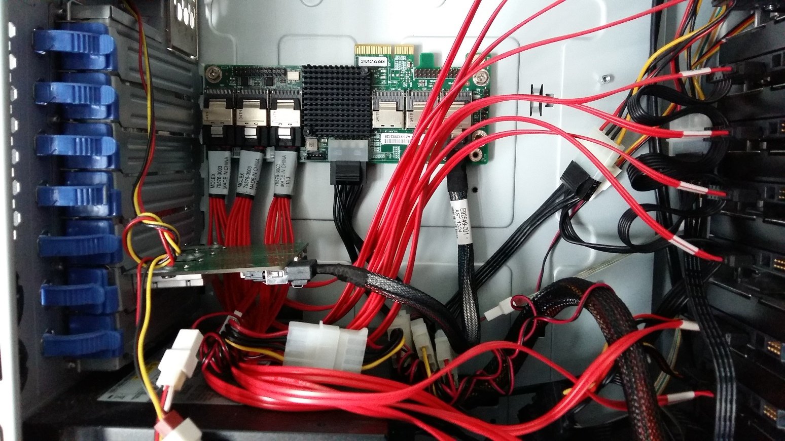

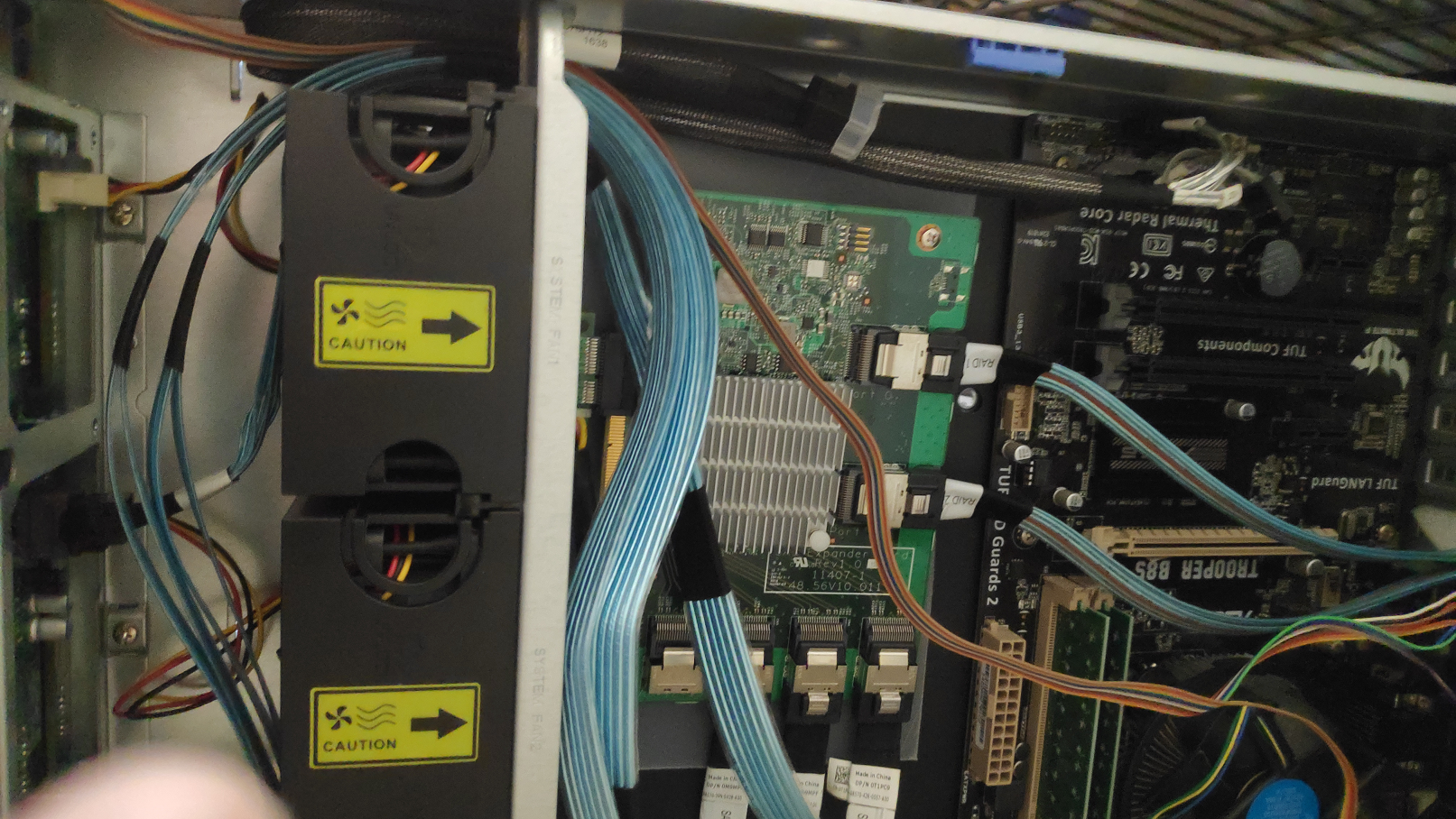

would you mind posting a few photos of your hardware, and if I understand you correctly, the 2u 12bay is seen by the unraid server as available hard drives to add to the array?
You can use external enclosures without any issues, but recommend using SAS, you can even use homemade enclosure:
Yes.
Below are the inside of the 2U ( mainboard not use now and ready to turn back in standalone ). Expander have two cable connect to LSI HBA and three cable connect to blackplane.
Edited by Benson
thank you both for the great pictures. This helps a lot!

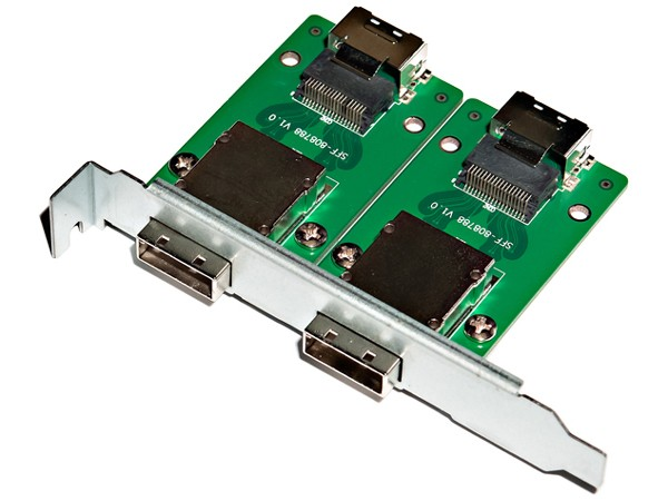

Also how did you power the sas card in thta pcie slot bracket that connects to your main unraid . Or is is it just some sort of ex to int passthru adapter. Cant see from image
tnx
46 minutes ago, glennv said:
What is the exact model name / number of this expander card you are using ? It seems it has its own dedicated molex connector so you dont need any connection on the pcie for power, which is nice and handy.
Intel RES2SV240
It's just an adapter like this:
top. tnx
